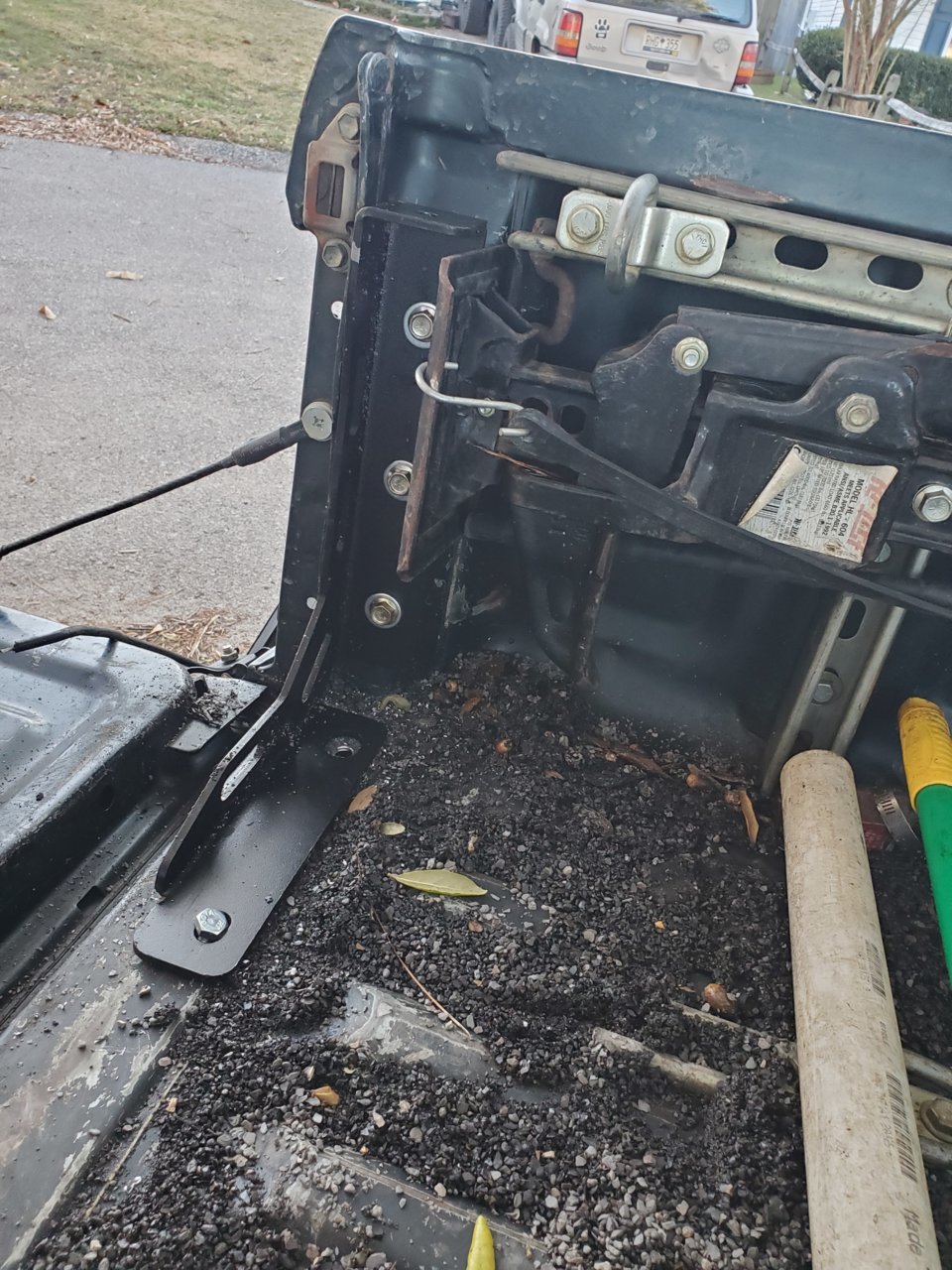

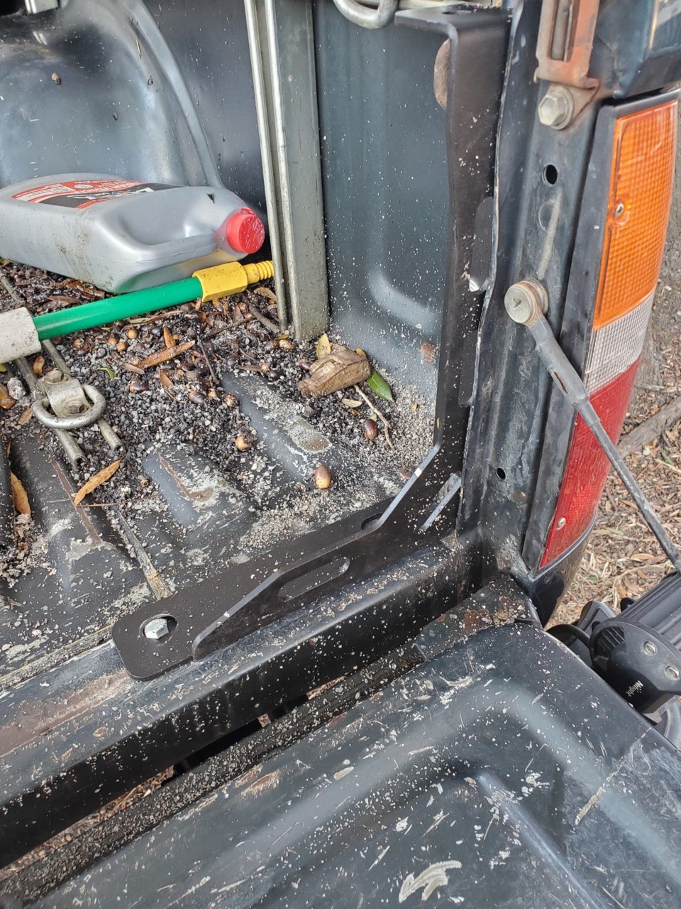

    Installed the box braces I recently bought... Pardon the mess, just wrapped up a big job (clutch and RMS) and proceeded to dump 5 quarts of used oil in the bed...
    They aren't made for. 1st gens, but will fit properly.
    EDIT- have to buy more hardware--you have to drill, and need 10x 3/8-16x1" bolts and nuts, and 20 hardened flats. Recommend loctite--blue if you plan to ever remove them.

    I know it’s made to be mounted like that on the second gens. But I found that switching the sides allowed for a better fitment for me.
