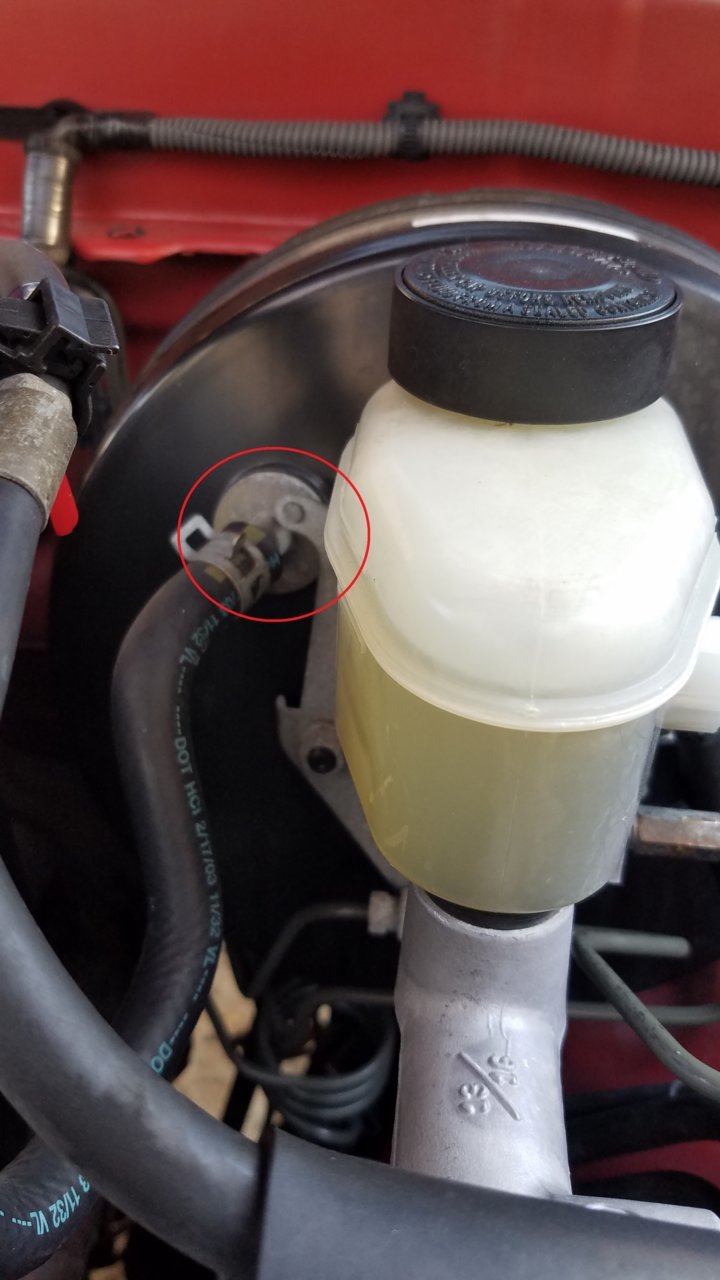

    The grommet where the reservoir connects to valve?

    Circled in red there is a rubber grommet behind the metal piece that the hose hooks to.
    JKO1998[QUOTED] likes this.

    Move the metal piece that the hose connect to and see if the sound changes

    I did.
    it only changes when I put pressure on the reservoir
