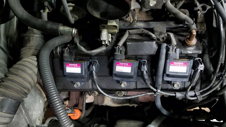

    Last Saturday, pulling into a parking spot, my 3.4L developed a severe misfire. I shut it off, went and did my shopping, and came back. Same condition all the way home (about 8 miles). No CEL. It was severe enough I could tell at least two cylinders were not firing, so I suspected coil pack.

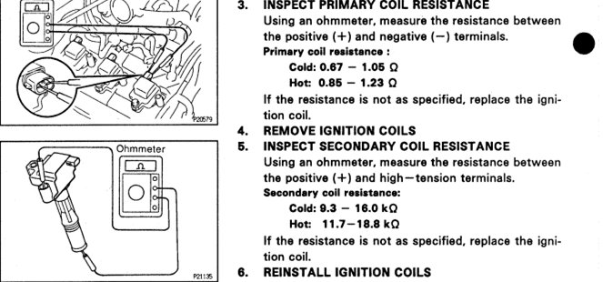

    I pulled all three, one of which was a generic replaced by the PO. Truck has 258,000. I checked the values and all three prmiary coils were above the upper resistance values, but none more than 0.6 ohms over.
    Manual says "replace if out of range". So, even though I knew all three were not defective, I ordered three, plus plug wires.
    I have to admit, had it been above 50 degree weather, I would have done more homework before "throwing parts at it".
    I got lucky. Parts Came Thursday, and I replaced them today.
    MERRY CHRISTMAS TO ME! RUNS GREAT

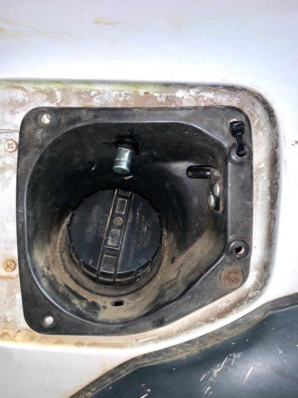

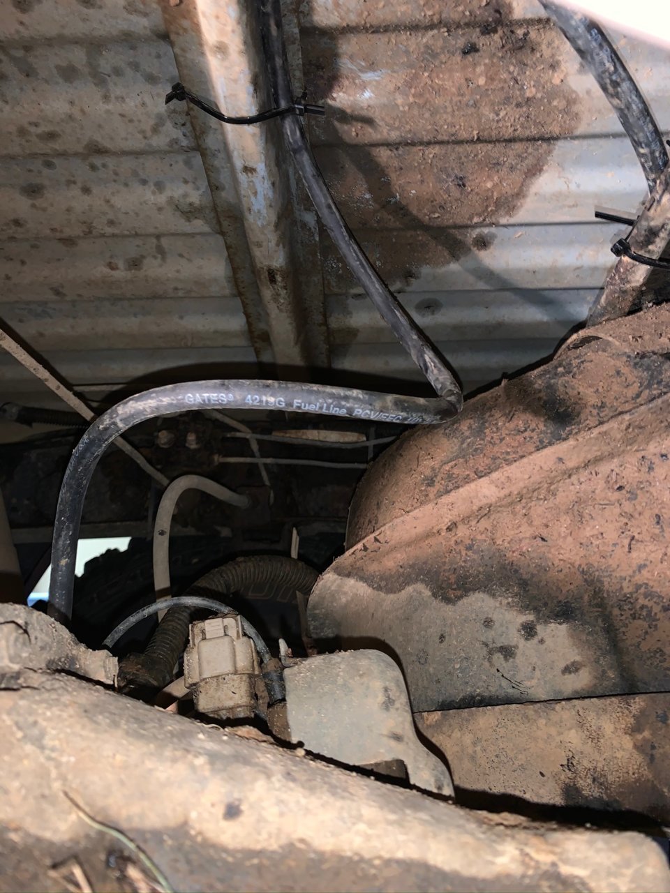

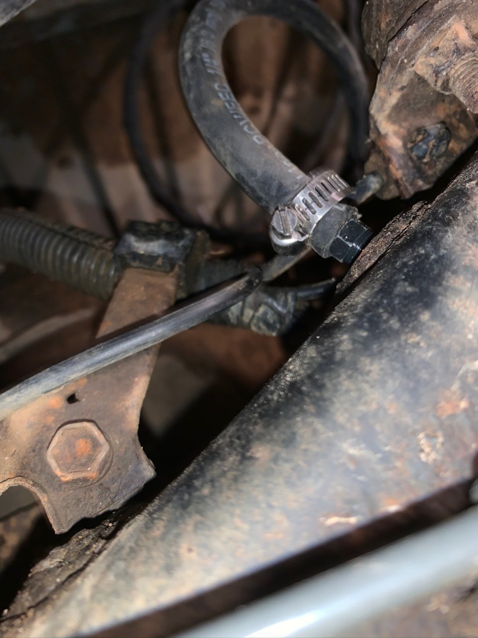

    Diff Breather Extension! The old diff breather was clogged/stuck and had already caused my axle seals to burst once.
    I drove for about 15 minutes, and when I removed the old breather, PSHHHHHH. I never realized how much pressure would actually build up in there. This kit is from YotaShop, includes 8ft of fuel line, a union, breather, and clamp, and to me seemed like a pretty sweet deal. Toyota Off Road Vehicle Differential Breather Extension. KIT-1012
