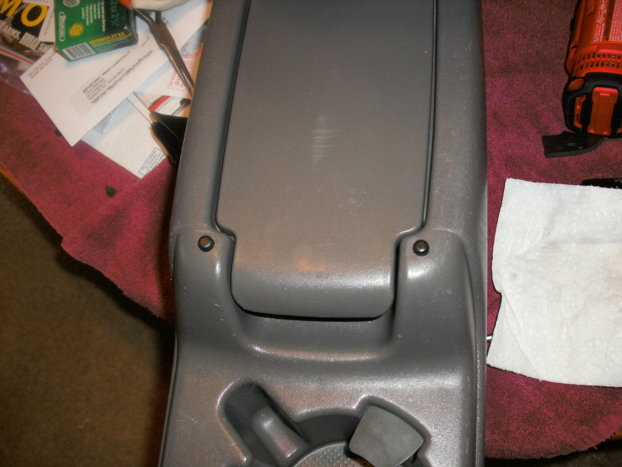

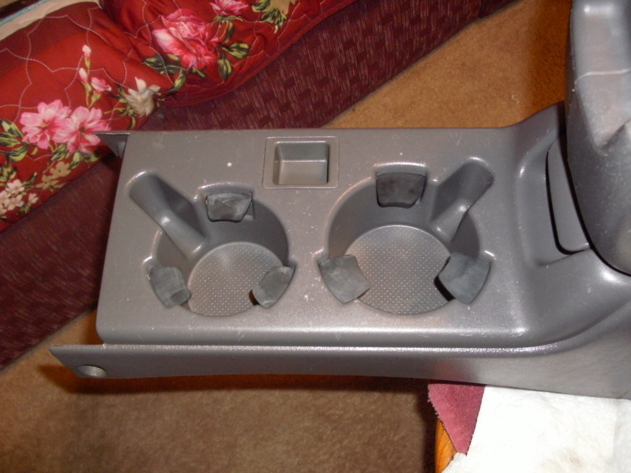

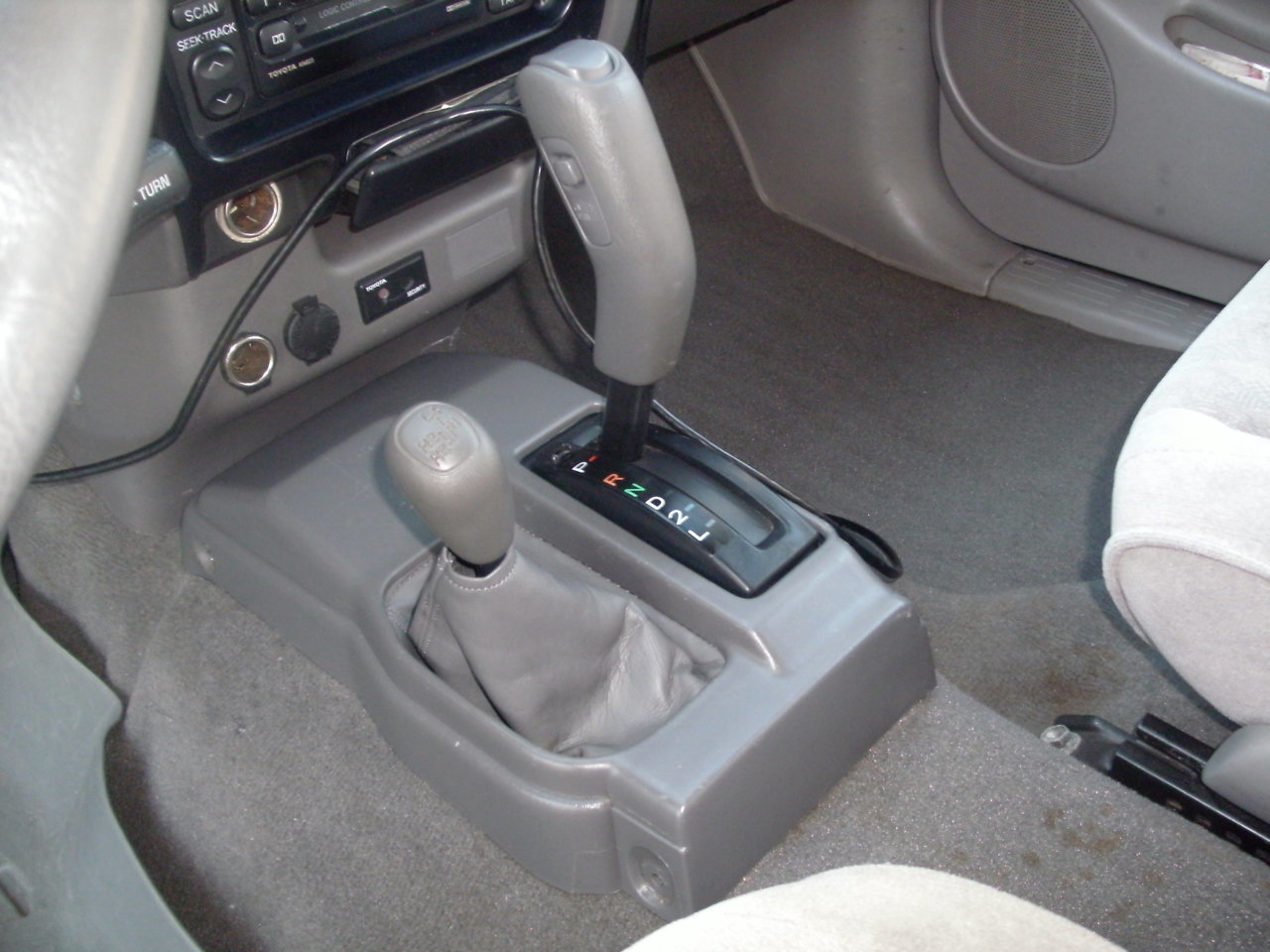

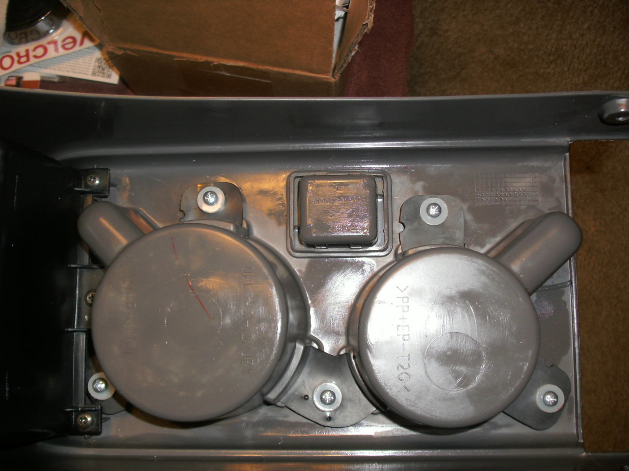

    I've been doing the little things that most wouldn't notice. I replaced the rubber bumpers for the gas tank lid. Recently replaced the 4 194 bulbs since I could only see the Tach at night. Today I removed the center console and cleaned that nasty thing up as good as I could. Some nasty shit gets down in the cracks and even under it. Installed my new cup holder tabs, but I had to replace the 5 screws that hold them down. The screw holes were buggered up and wouldn't hold. I almost pushed the new screws through the top of the console,(Stupid me). Also replaced the little rubber bumpers that the top part of the console rests on. Nothing major, but it's the little things that add up, and working cup holders are nice to have again. I need to get a heat gun and use on my console to see if I can refresh the color in the faded areas.

    you need just the little bumpers in this pic. Call a Good Toyota place like McGeorge or Camel Back and check this number 1st. Add some lubricant, like armor all on the part that goes into the hole. I grabbed the top part with a small pair of needle nose and it popped right in.
    90084-54010
    If that's not it then
    90541-06058
    I have a couple of packs that just says "Cushion", and I'm not 100% sure I didn't get the packages mixed up.
    Hope this helps.
