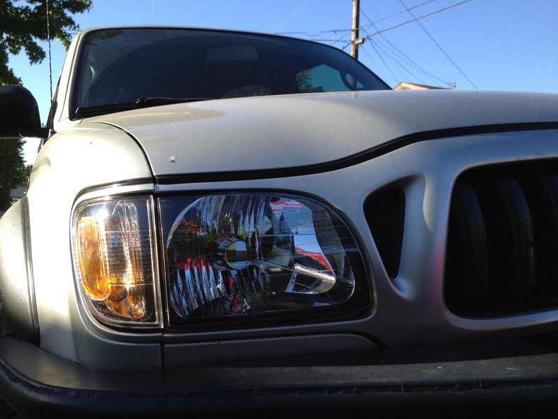

    Nice! Just installed the new TYC headlights. These are shiny :D
    I'm going to have to put a nice coat of Rustoleum bedliner on all my armor. Rustoleum professional doesn't last all that long, especially after Pismo :rolleyes:

    Tyc? Link? I need some new headlights too mine are all hazey and getting worse. I don't think buffing them will do the trick. There's a lot of dust in em too lol
    I don't think much will in pismo, getting sand blasted the whole time lol
    Edit - ahh just saw em on rockauto :thumbsup:

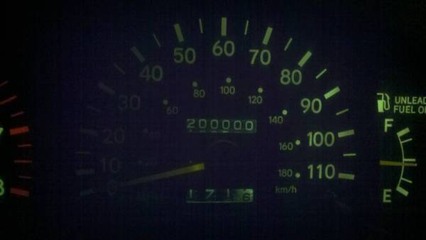

    Hit 200,000 Tonight!:D:(:cool:

    I fuckin' HATE Pismo! I will go to the mountains to get away from people and sand storms. I've only been there once but it wasn't all that fun. Didn't help that I blew up the previous motor that was in my truck :rolleyes:
    And yup! Rock auto is where I got 'em. Something like $70 shipped for both lights. I didn't realize you can adjust these with 1 screw. My Honda has 3 adjusters per light LOL

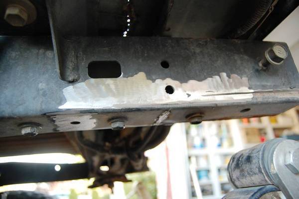

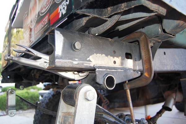

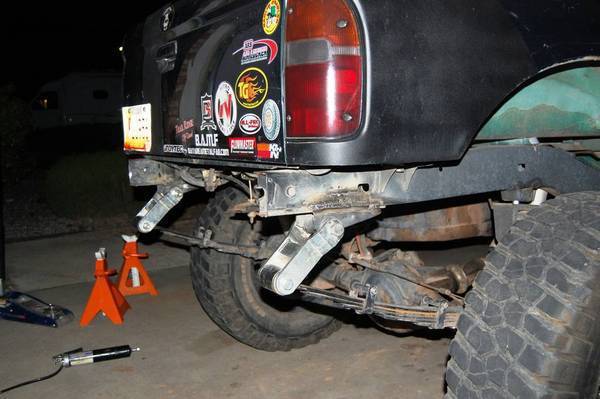

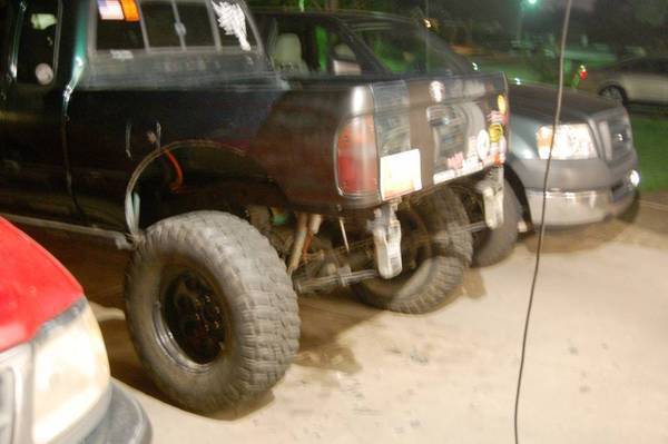

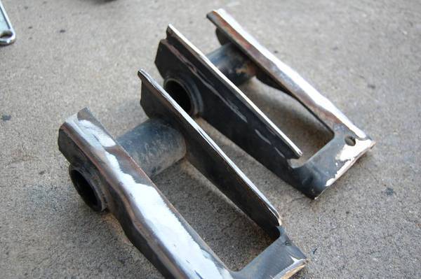

    Moved my rear shackle mounts foward 3 7/8" to get a better shackle angle with my 6" shackles and expo leaves. I was also nice to lower the rear 1 1/2". :) Only bummer part (sorta) is that my 10" 5150s are too short (who wants to buy em?? :D) for the amount of travel (mostly droop) I will now be getting... I still have to fully flex out the rear end and measure everything before I decide what shock and shock configuration to go with.
    Here's a good pic of the shackles before:

    Hurray!
    yes the flex outa both front and rear will be much better.

    Looks SO much better! :thumbsup:

    Should ride a bit smoother out back too :)
