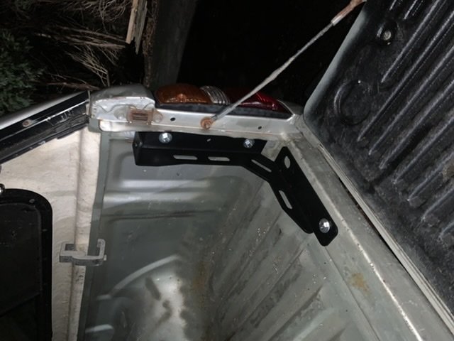

    Installed mine the right way, very easy install.

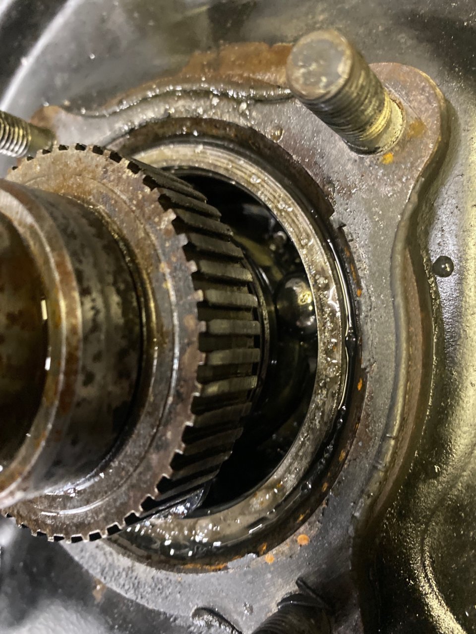

    Turns out my wheel bearing blew up and took out my axle seal and possibly my diff. I've got someone looking at it now to see if there's damage to the gears. I have a feeling this is gonna be expensive...

    Kinda looks like it was riding on the ABS tone ring too

    Yeah I was trading work for work with this fabricator who doesn't usually do axle stuff and I don't think he installed it right. Unfortunate lesson to learn, but now I know to just pay the price for good work up front.

    Your diff gears will be fine.
    The bearing is shot and so is that tone ring though.
    It is very easy to mess up the seal rings on the axles. It's not hard to get right but easy to overlook.

    Hoping you're right about the diff. The guy looking at it was saying he couldn't find some of the bearings, and they definitely took out the seal so he was thinking there might be a few in there
