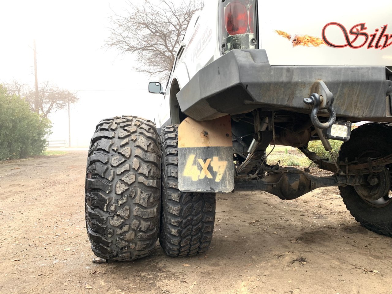

  18. Jan 10, 2021 at 3:26 PM
    v5ensx
    v5ensx CARB legal is not CALI legal
    Sep 19, 2014
    #138656
    1,802
    What are you running, 3 inch wheel spacer each side? Your drum stick out so far :confused: with those procomp...
