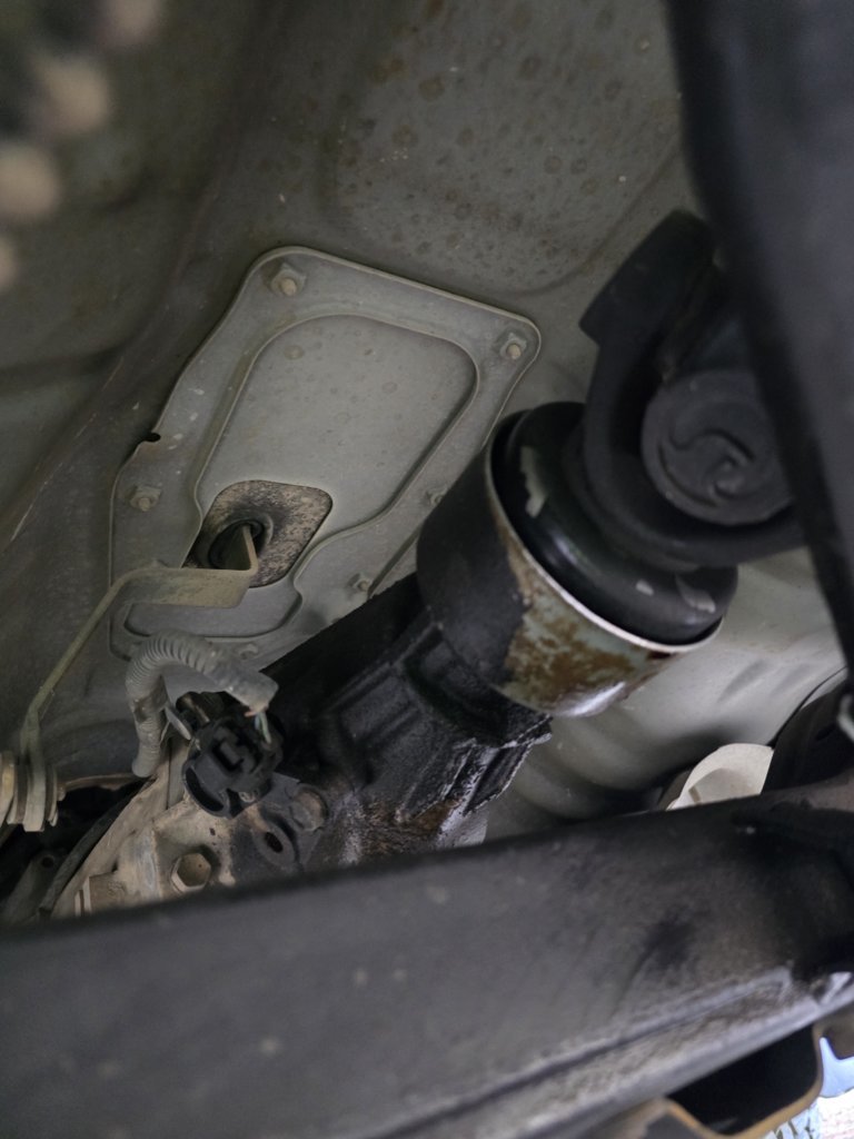

    28
    2003 2.4l 4 cyl tacoma

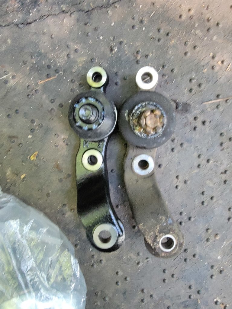

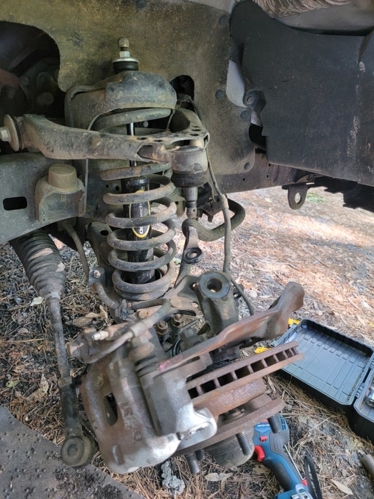

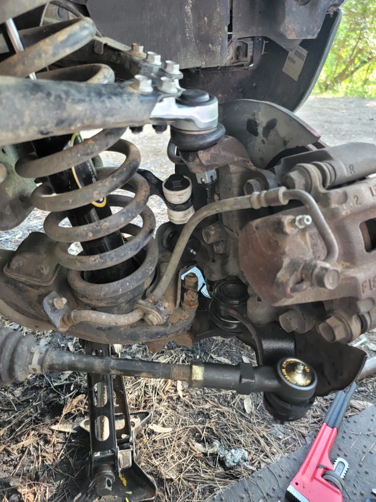

    Estuve cambiendo mis rótulas superior e imferior porque ya estaban liqueando grasa, decidí hacerlo antes de la tragedia. Las compré originales en toyotapartsdeal.com
    [​IMG] [​IMG]Cambié tambien rotula terminal de cremallera: "moog" con grasera y terminal de barra estabilizadora: "moog" también, ambas con pin para engrasar.
    (si saben a qué kilometraje o uso debo engrasarla, se los agradecería)[​IMG]

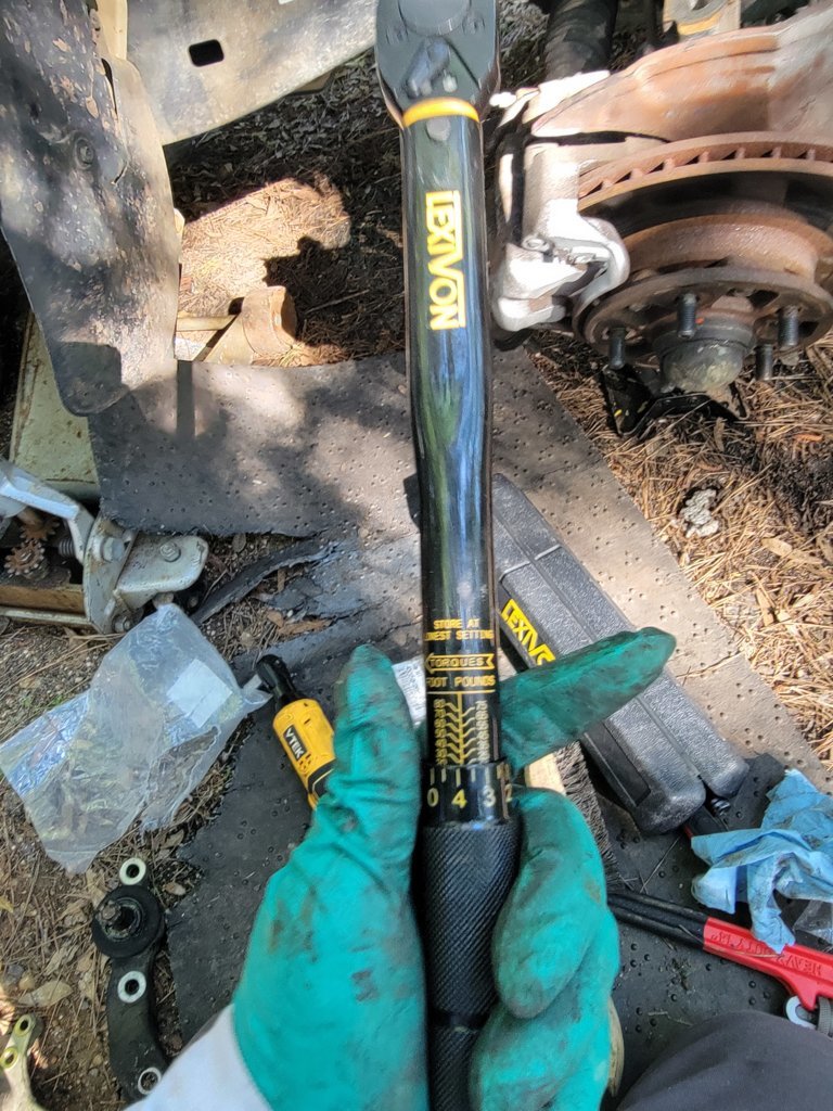

    Estudié usando esta llave dinamométrica para mis torques, todo con base al manual de usuario
    https://www.amazon.com/dp/B07M68G49R
    (Cabe recordar que se devuelve con bastante frecuencia )
    Las otras herramientas que uso, todas calidad-precio son:
    Llave de carraca
    https://www.amazon.com/dp/B0DKTNSYMQ
    Taladro de impacto
    https://www.amazon.com/dp/B08PW5Y2J9
    Kit de herramientas craftsman
    https://www.amazon.com/dp/B0CNKXHGZT
    Saludos

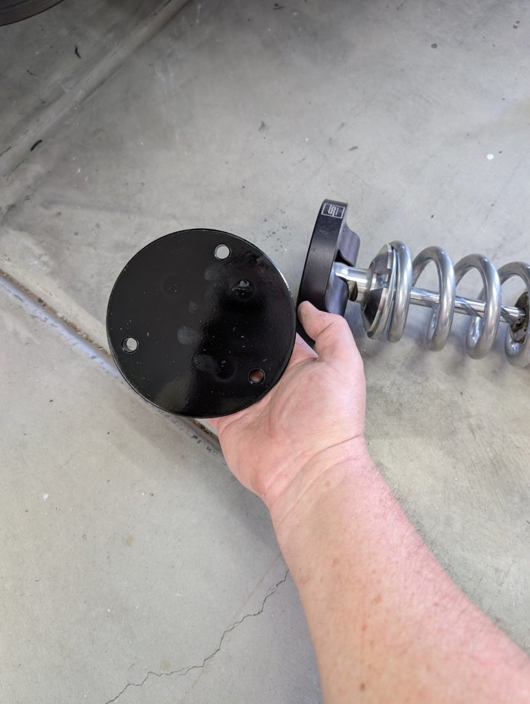

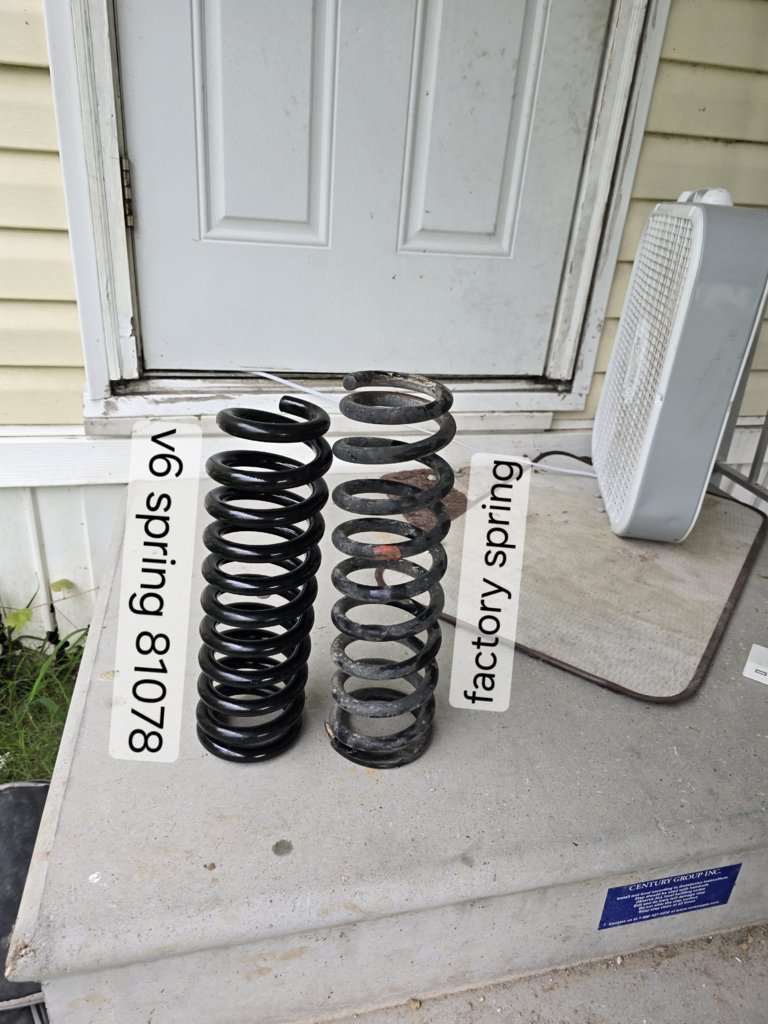

    This weekend's work was fixing my taco lean the correct way. After upgrading all of the suspension for a lowered ride height I ended up with the usual taco lean of 1/2" on the driver's side. Cranked up the driver's coil over to compensate for it like many do but I noticed going over bumps the truck would try to jerk to the right even though everything checked out at the alignment shop. Eventually I decided that the uneven spring rate due to preloading the driver's side for the extra lift was the problem. I figure I'll order a 1/2" spacer and test out my theory. Well that didn't work out well as every spacer I could find stated that they only fit the 6-lug. Ended up buying a small section of 1/2" aluminum plate and 'machining' my own spacers using and angle grinder and my woodworking tools. 5 nicks, 2 scrapes, a pair of burned finger tips and 1 bruise later I had a 5 1/2" aluminum disc with three holes in it that I painted black and fit on top of my coil overs.
    Ride quality is day and night. The truck no longer tries to jump to the right over bumps and stays pointed the direction I want it to. All due to a stupid 1/2" thick piece of metal. Ignore the finger prints, I picked it up before the paint had fully cured.

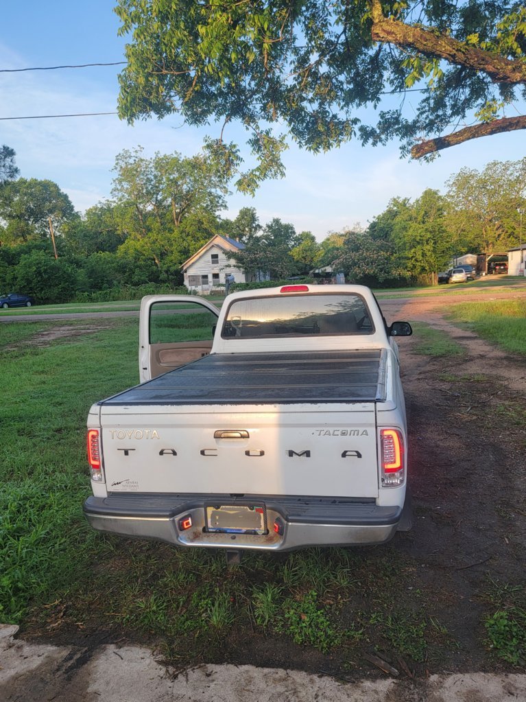

  5. May 13, 2025 at 1:50 PM

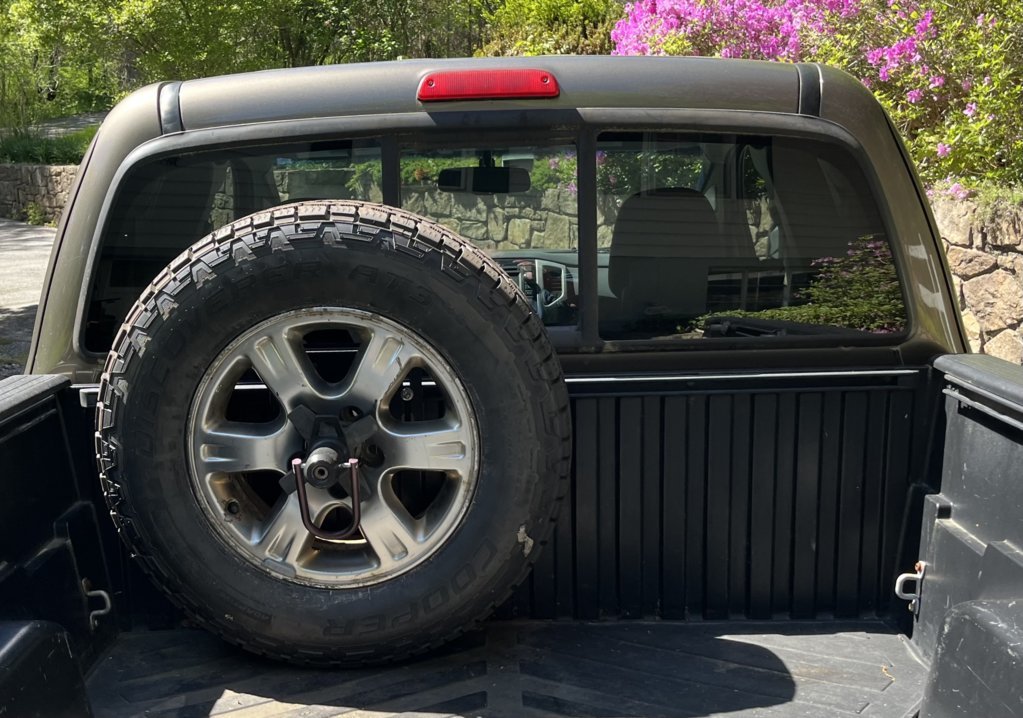

    Added a (used) Wilco in bed tire mount.
    Had to remove the front rail to get the mount on.

    Qué rims do you has?
  7. May 17, 2025 at 2:29 PM
    #187
    TheBigKahuna
    TheBigKahuna Well-Known Member
    Jul 30, 2018
    #261053
    331
    They are 16" wheels from a Toyota Highlander 2001 - 2007.
    I know that wheel is a bit scruffy but I got it cheap to be the spare.

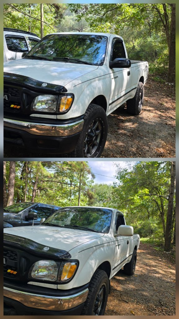

  8. Jun 18, 2025 at 6:09 AM
    #188
    trinidadlad
    trinidadlad Well-Known Member
    Feb 18, 2016
    #178652
    74

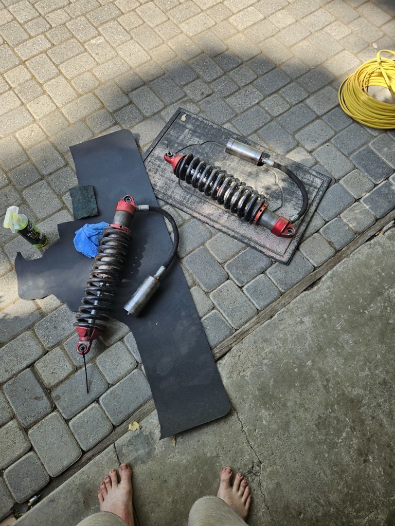

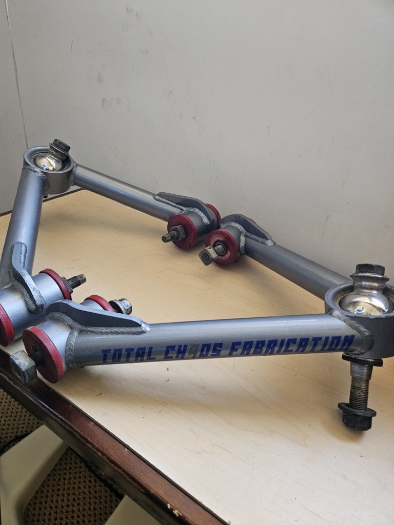

    Dakota
    08 white base 5lug
    It took forever to find it all but I finally got some 8" away away coilovers and the ucas (also got the coilover adapters just not in pic) going to get it all rebuilt and slap it on the truck in the next few weeks
