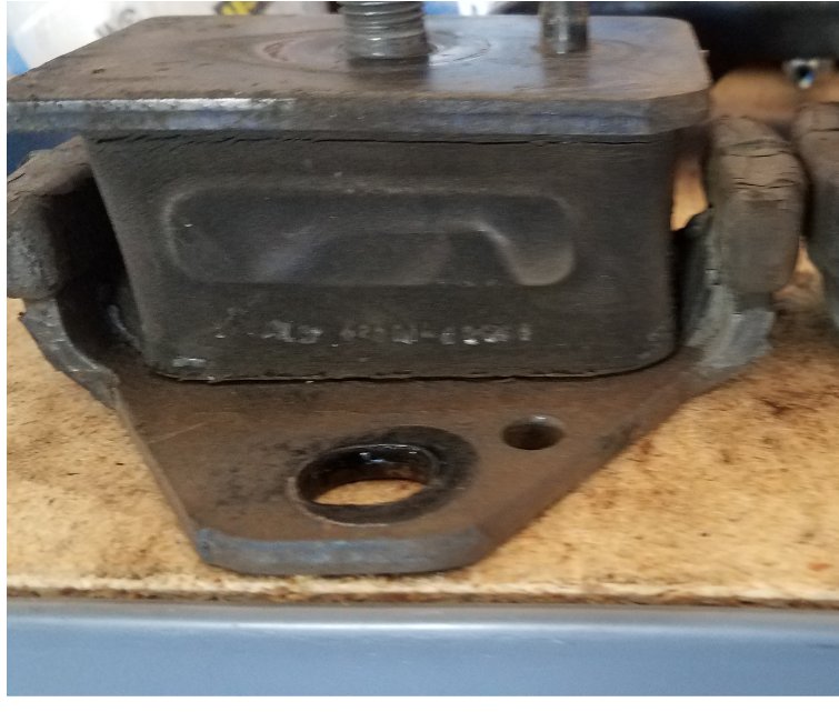

    Yep, I'm going through replacing things as time and budget allows. Suspension is coming up. At some point...
    I just did the motor/trans mounts. They didn't look too terrible but were starting to separate and I felt like 20 year old rubber probably needed to be replaced. I feel like they honestly could have gone longer before they really needed replacing...

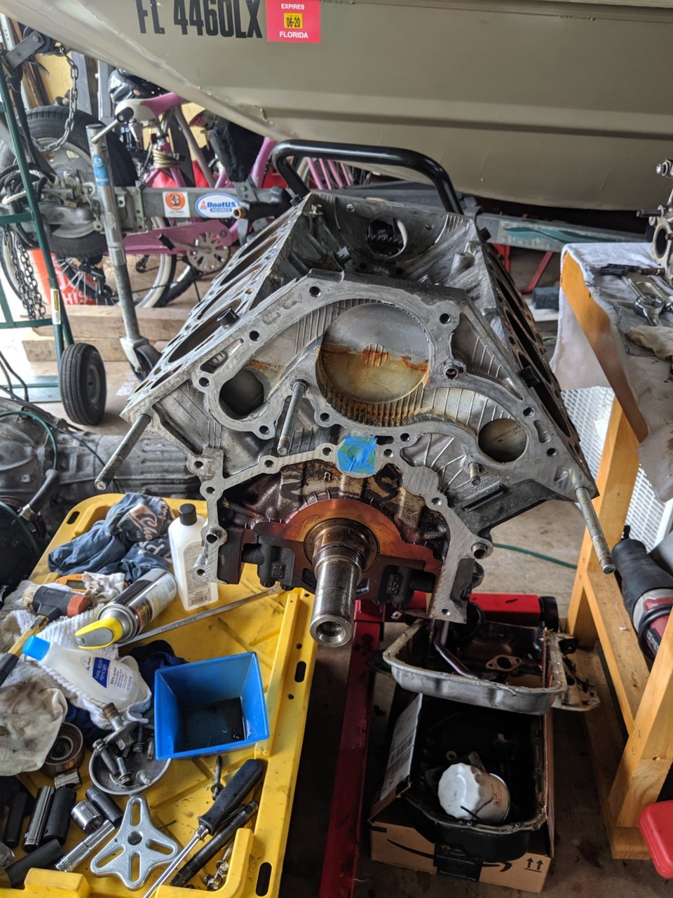

    Got a lot of stuff lol

    I know we have different motors, but out of curiosity how many miles did you get out of ur previous 4 cyl mobbing it so hard lol? Please keep us updated, I'm excited to see this thing come to life!

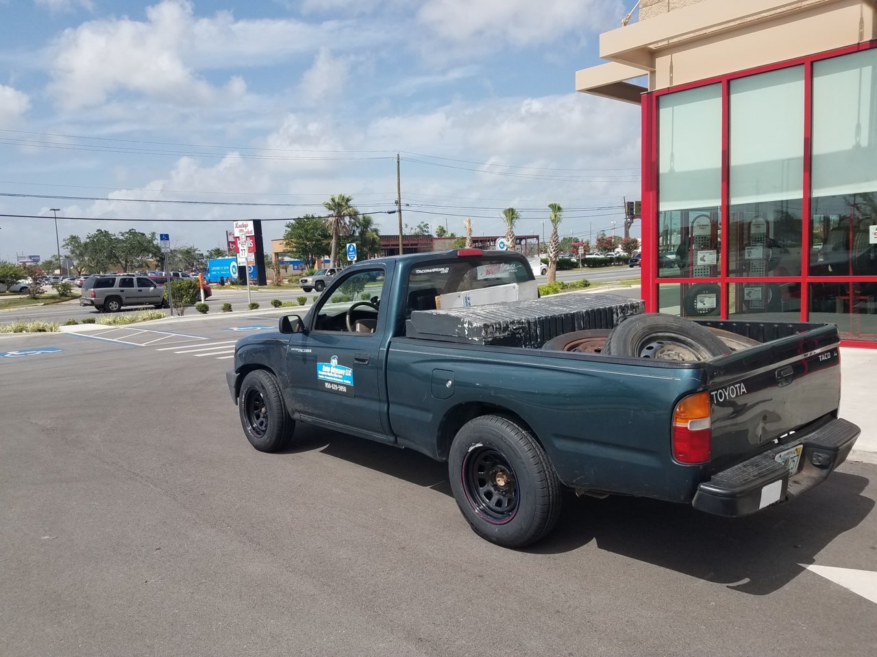

    235k and counting... good thing about Florida weather is it doesn't cause too much rust.

    going to add a wing too? you could probably achieve lift-off after the swap, the 5 lug glider

    How many miles are on that work horse

    235k. Keep scrolling though... updated its looks a bit.

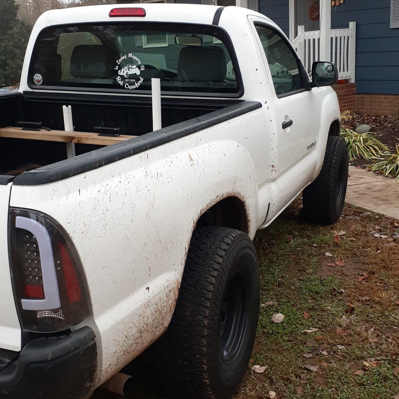

    3" lift on 31's with bart d trucker wheels
    I got 31x10.5xr15 with bart wheels i just bought some dick cepek wheels. To put on since they are lighter

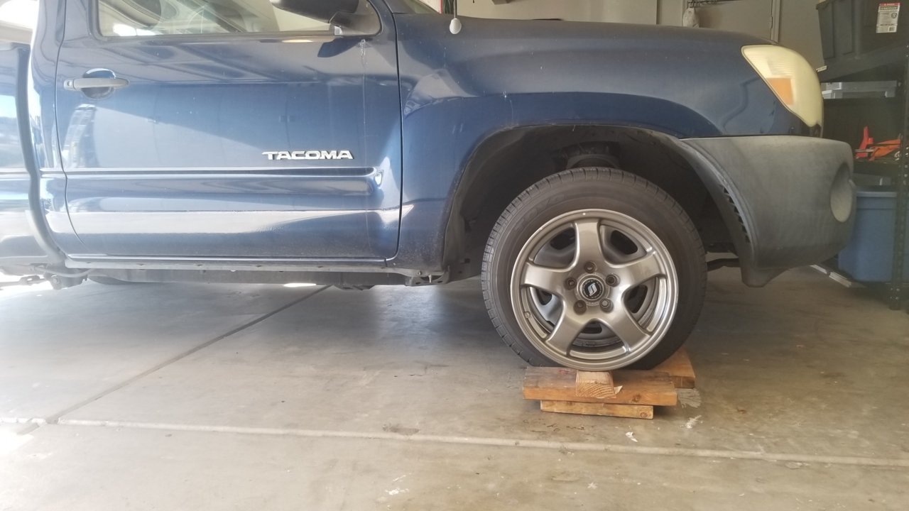

    Inspecting this bad boy. Rotate tires. Torque on. Cleaned up back of rims and front of rotors to rule out bad seating as a reason for some shimmy of the wheel under braking. Seeing some crack bushings and some weeping. Front right steering rack boot leaking. No major play anywhere I could assess by hand. Every suspension part basically appears original. 140k on it. 2007.
    Edit: test drive results
    No improvement.
    Going to double check right side tie-rod. Maybe bleed brakes
    Edit: tie rods feel fine. bleeding fronts didnt help. Rotors and pads look good and symptom is not all the time. Gotta be the bushings. Fun

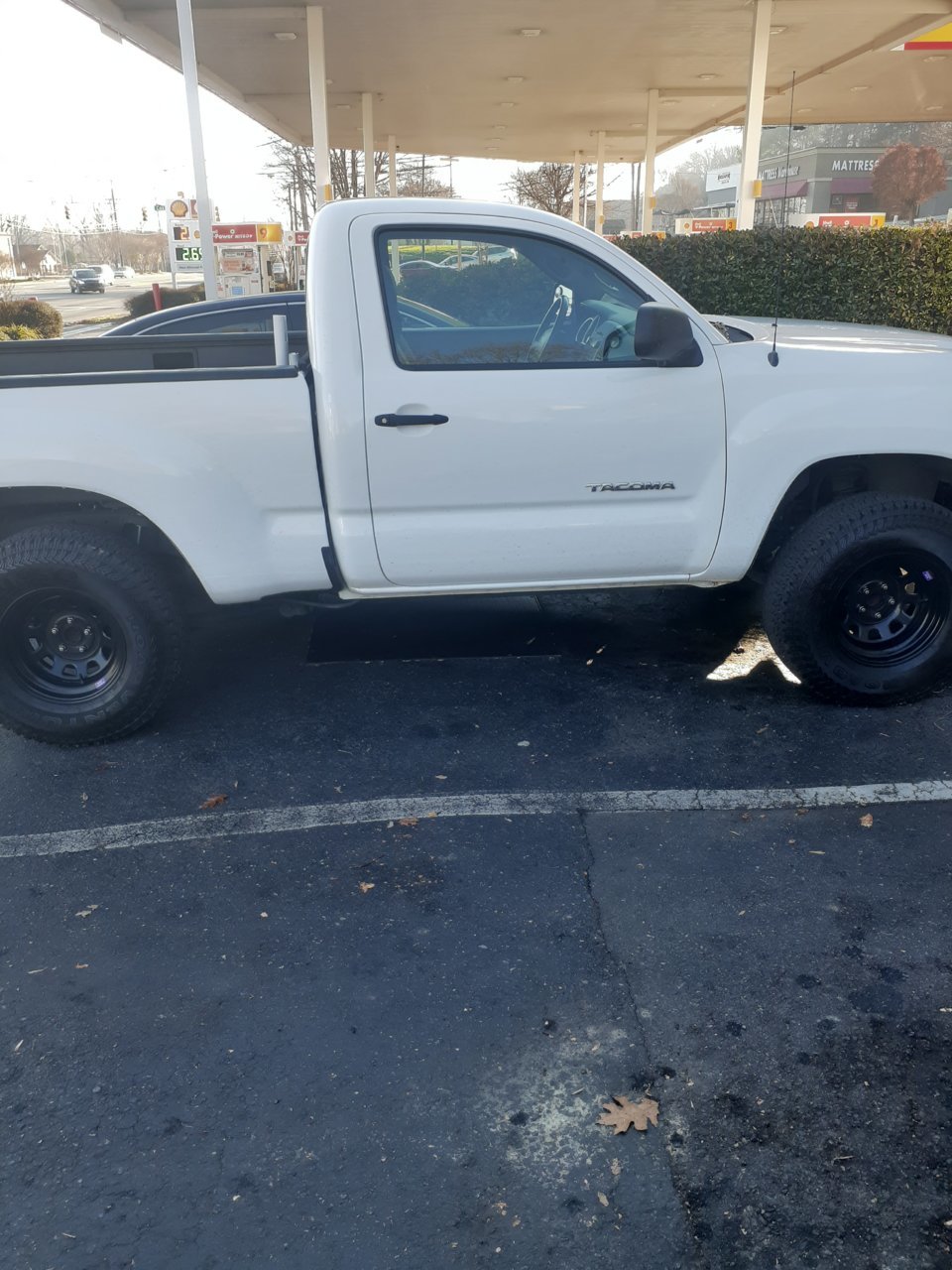

    Here is my truck transformation. Went from bart wheels to lighter dick cepek wheels. Im honestly suprised how good it endes up looking.

    What does it take to replace these motor mounts in your own garage?
    engine lift or jack up engine from bottom?

    I put a board I had laying around (like 1" thick and maybe 6" x 8") on the jack pad and jacked it up from the bottom. Overall, it was much easier than I was expecting!
    Not sure if 2nd gen will have same issues as 1st gen but I had to undo my air box and remove the fan shroud to be able to jack the motor up high enough to get the mounts out.

    Cool. I find that motor mounts go neglected as a wear items on many cars. Some actually have frequent issues. These look very std though. But! as you can see on yours, gravity, weight and heat has defeated them. Same with transmission mounts.
