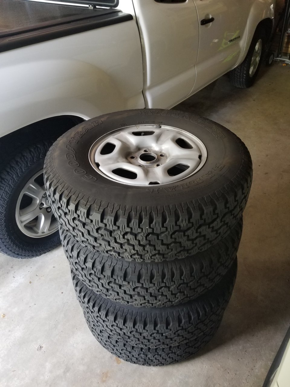

    Happen to know the difference in weight between the steely and alloy wheels?

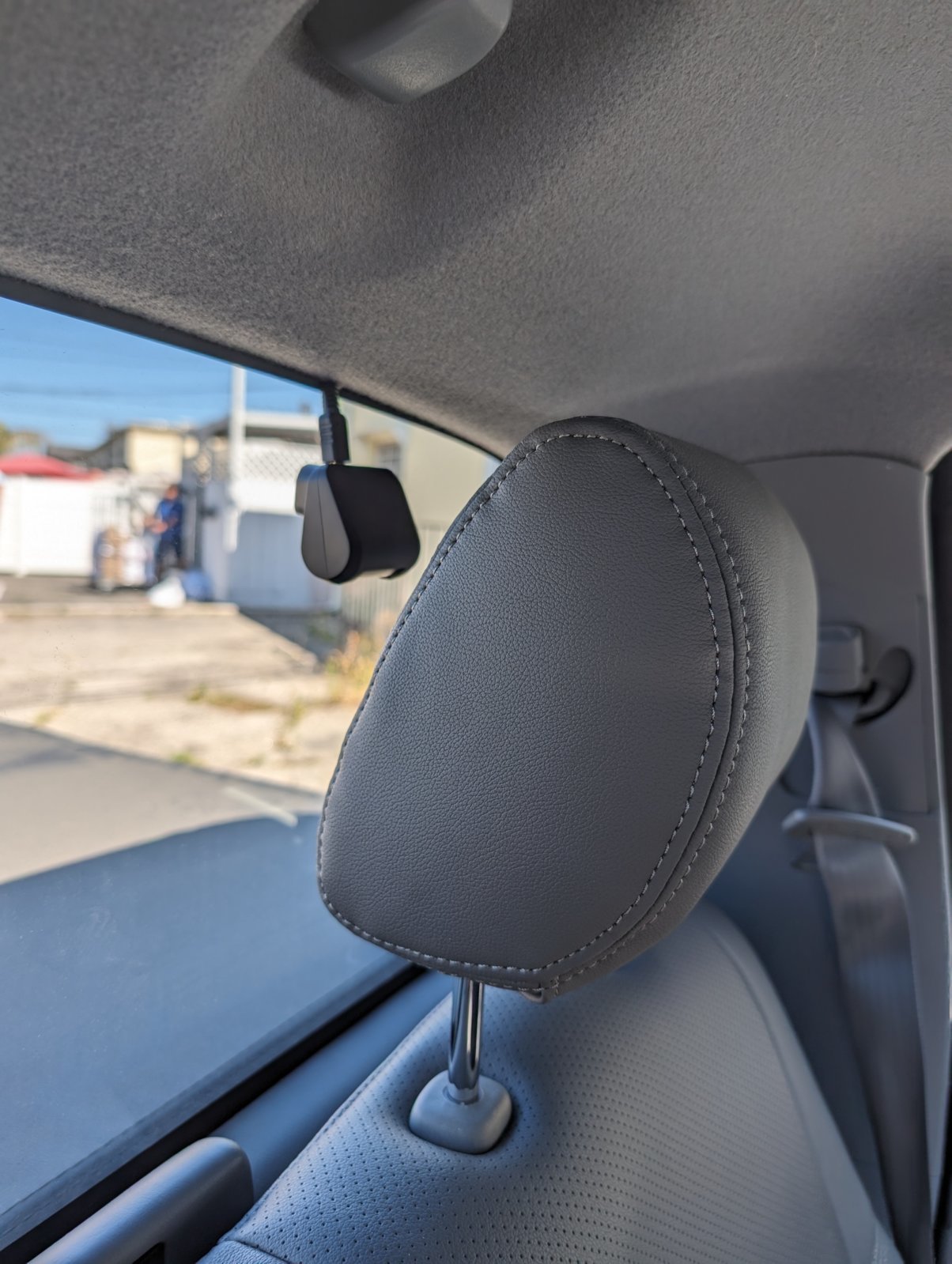

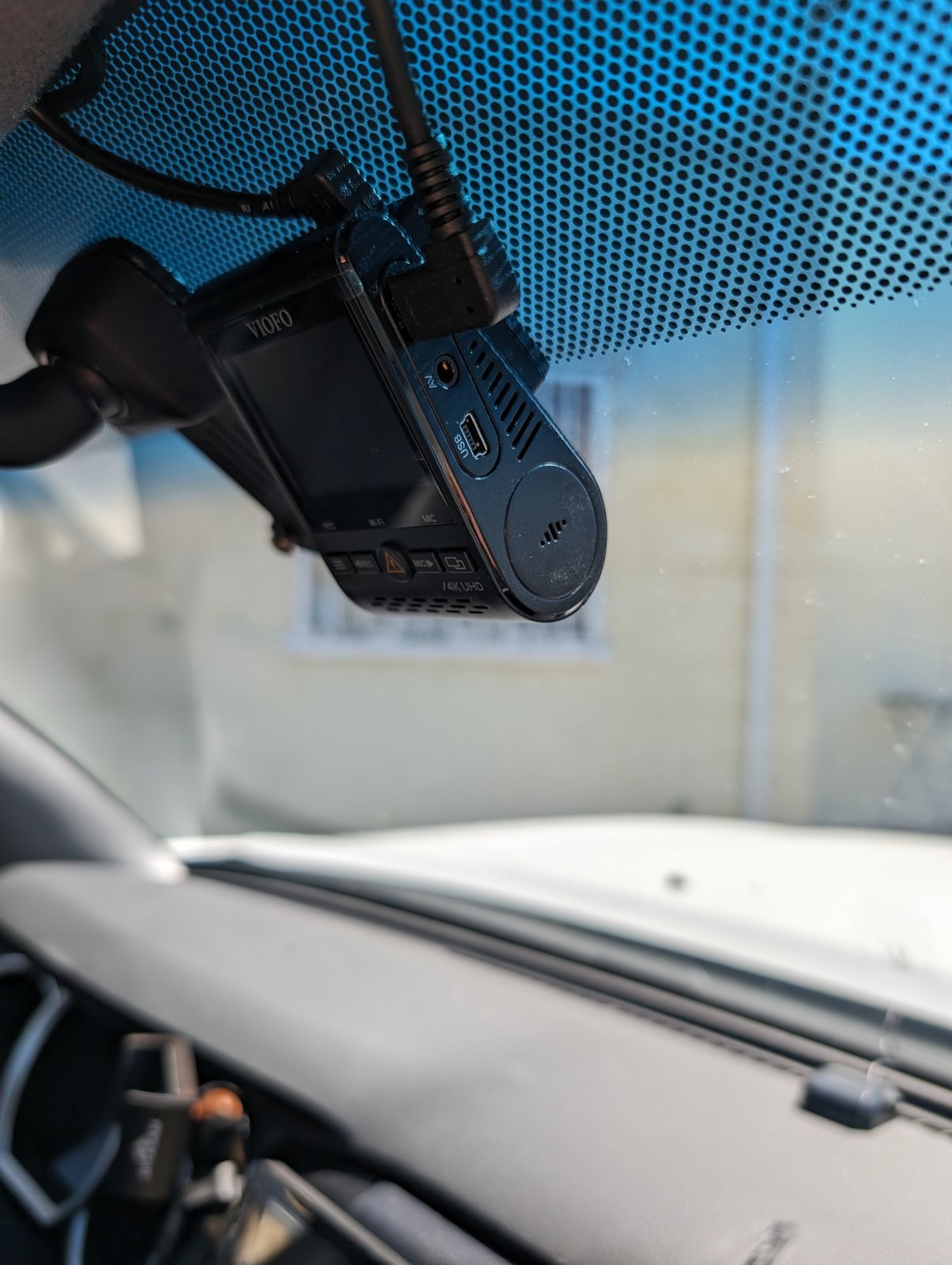

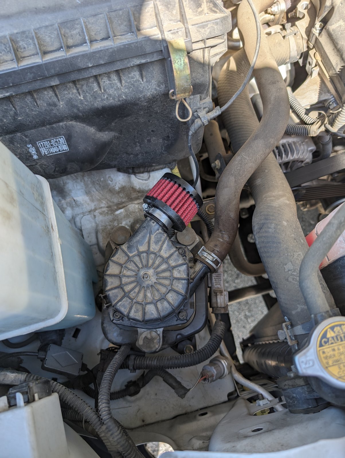

    Did the air pump filter mod as a preventative measure over the weekend. Ignore the dirty engine.
    And added front and rear dash cam setup. So far the only use is I see that I speed a lot.

    Just dropped that cam system in mine as well, very happy with it

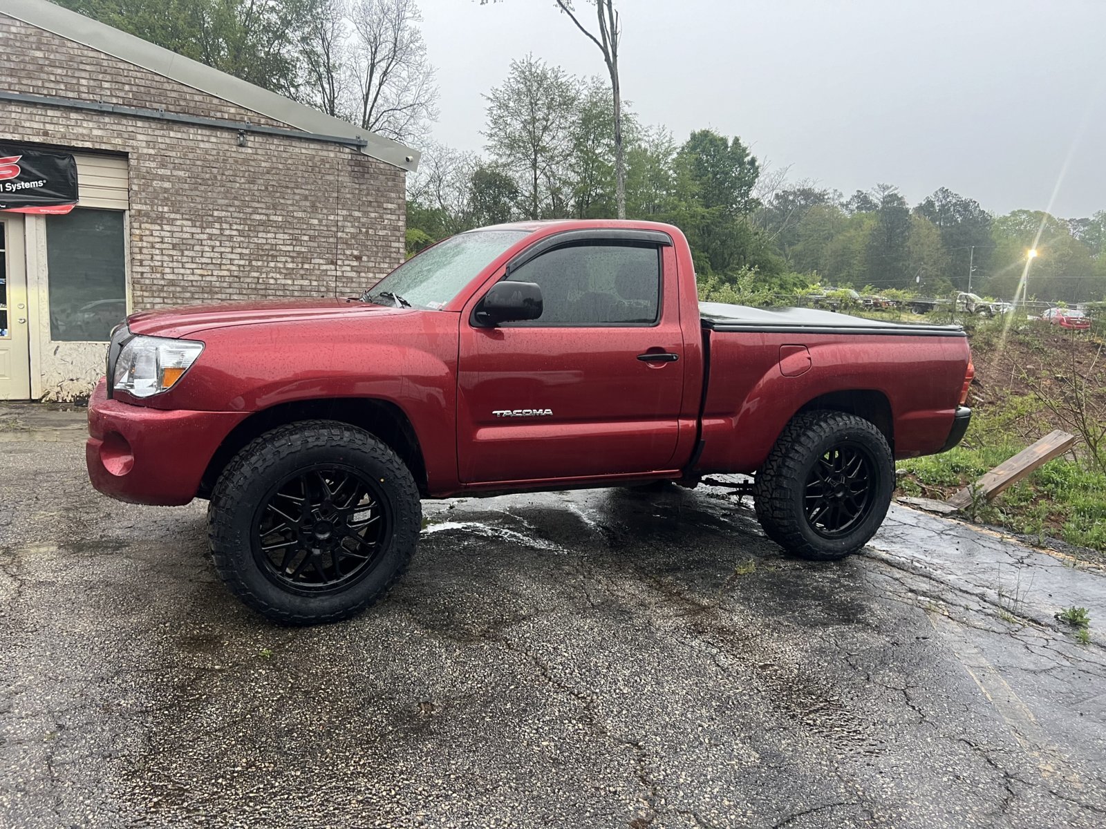

    IMG_4226.jpg I don’t know what I would have done if it wasn’t for this page.
    Let’s start off with, I have been looking for a truck for my sons 16th birthday and didn’t want to give him a full-size truck.
    Found this 2008 Tacoma, org. 68k (old man owned it). $10k out the door. A straight up STEAL of a deal.
    Well, long story, but I should have done my research before hand because I didn’t know the 5 lug and 6 lug tacomas were completely different.
    I was pretty much building this thing for him and ran into quite the issues.
    I Purchased the first lift kit not knowing the suspension difference from Rough Country and Had to return it. Went and bought the Readylift with the AAL.
    Fog lights, rock lights and new led headlights were a huge upgrade. MAIN issue was the wheel size, couldn’t find a wheel I liked that would fit my taste and would look good was my issue. Finally, I decided to go the wheel adapter route and purchase a 1.125” adapter converting the lugs to a 5x5.5 instead of the 5x114.3
    Went with a Fittipaldi Wheel 20x9 with a 275/60r20. Some minor cutting from the local wheel shop. Minor scrubbing, nothing major.
    truck turned out pretty damn sweet. Gave it to the kid and he loves it.

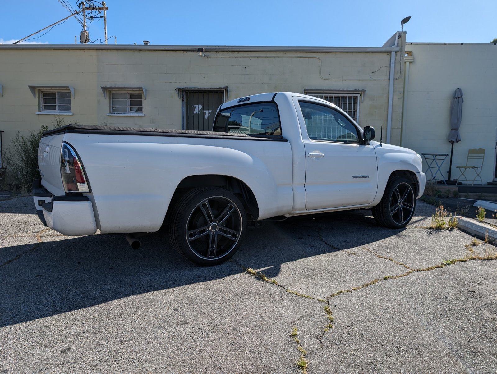

    Switched my 20s out of the garage and on to the truck with some new rubber to boot. Definitely time to buy that DJM 3/3 drop and install it. And for anyone interested in specs the wheels are 20x8.5 +48 and tires are 255/35R20s.

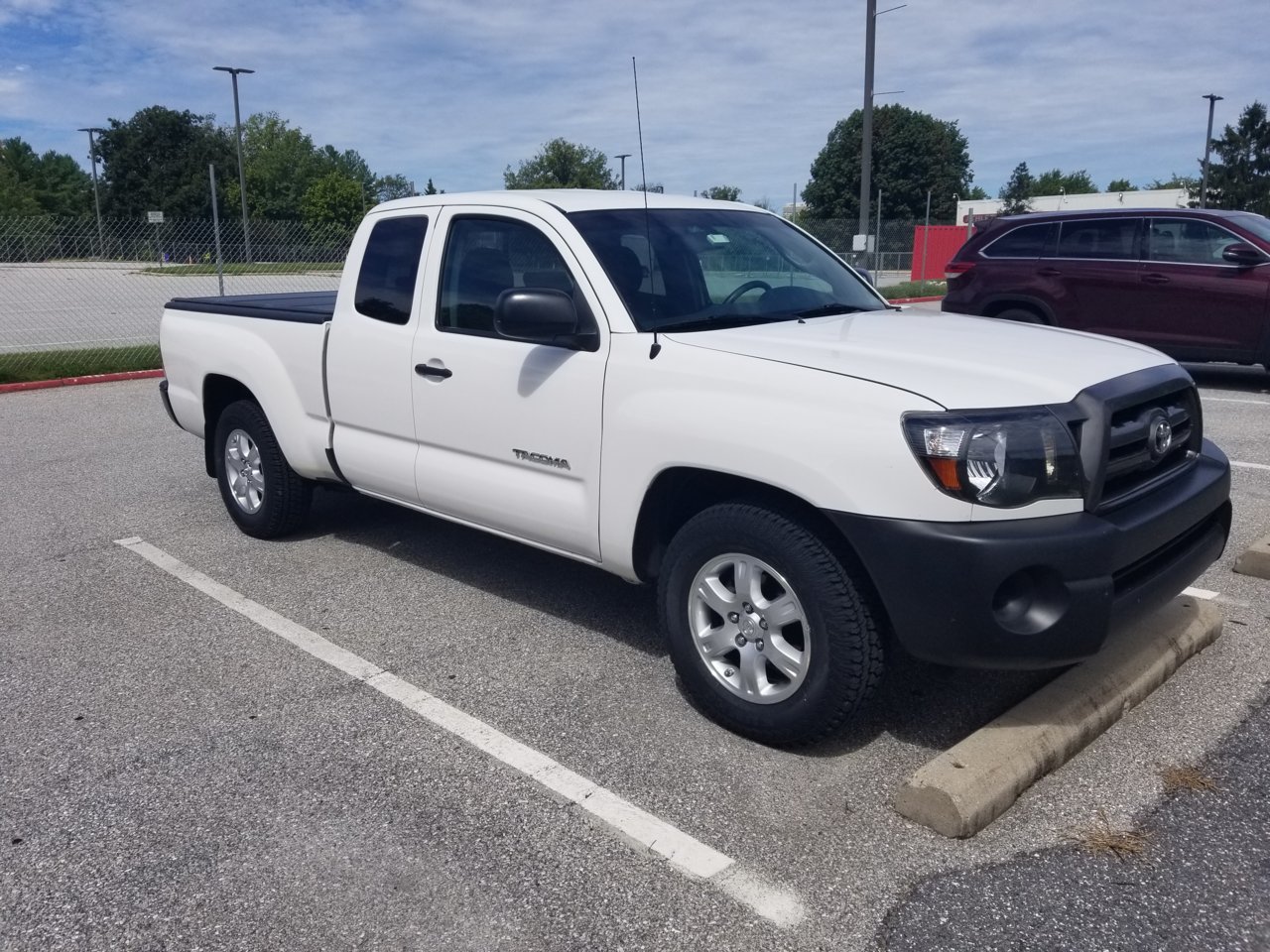

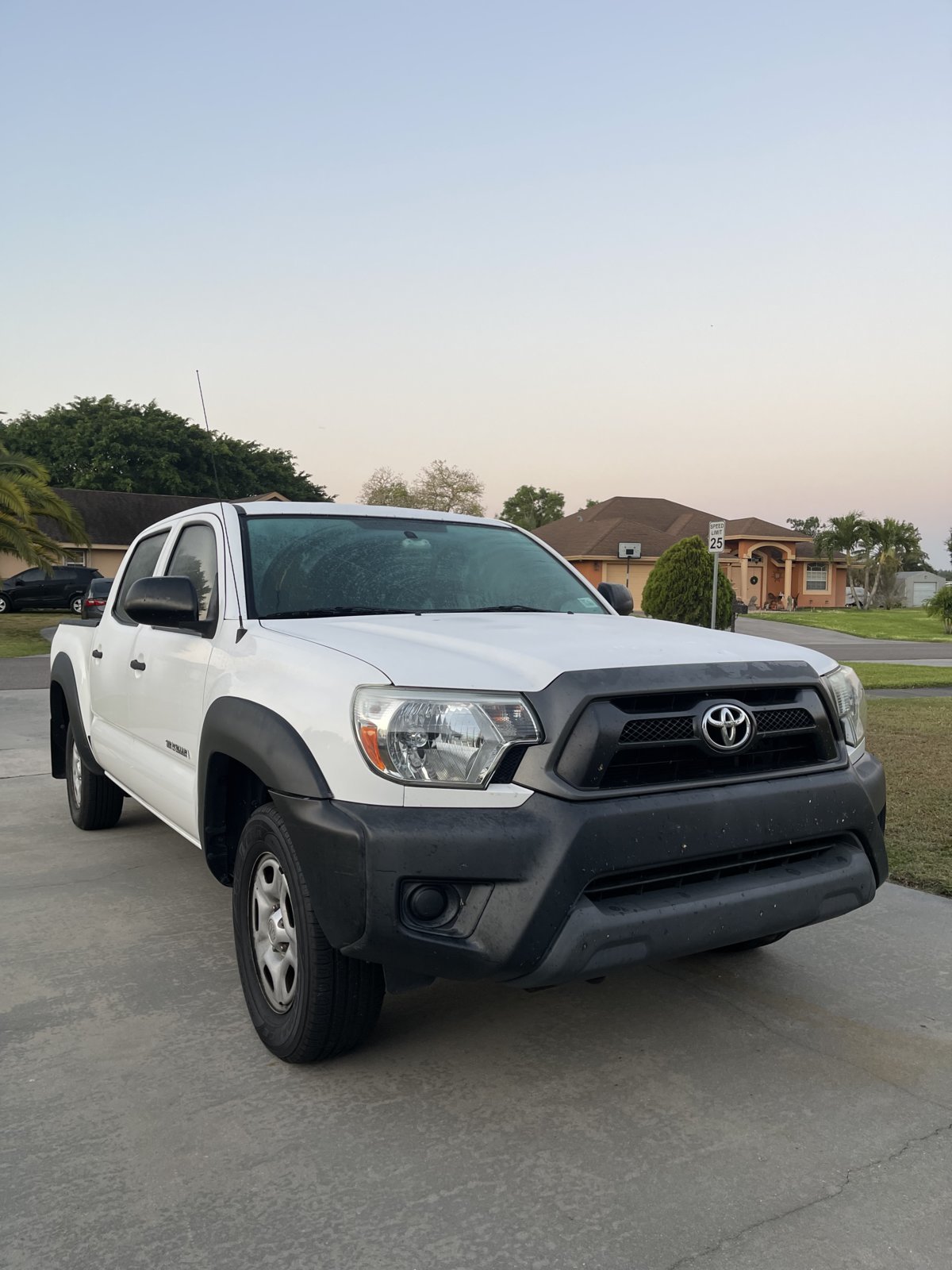

    Didn’t add any significant mods yet but I did try to restore the plastic trims on my wittle twuck. Need more work to do but she’s new to me 2015 dc 5 lugger

    I tried a bunch of products but ended up painting mine with plasti dip. It's crazy how fast alot of the back to black stuff washes off.

    I did the CeraKote wipes on my wife's Rav4, worked great.

    All of those black plastic restoring products look great upon application, but seem completely worn off after a wash or two. I went the route of removing and spraypainting all of my exterior black trim.

    The best way to do it.

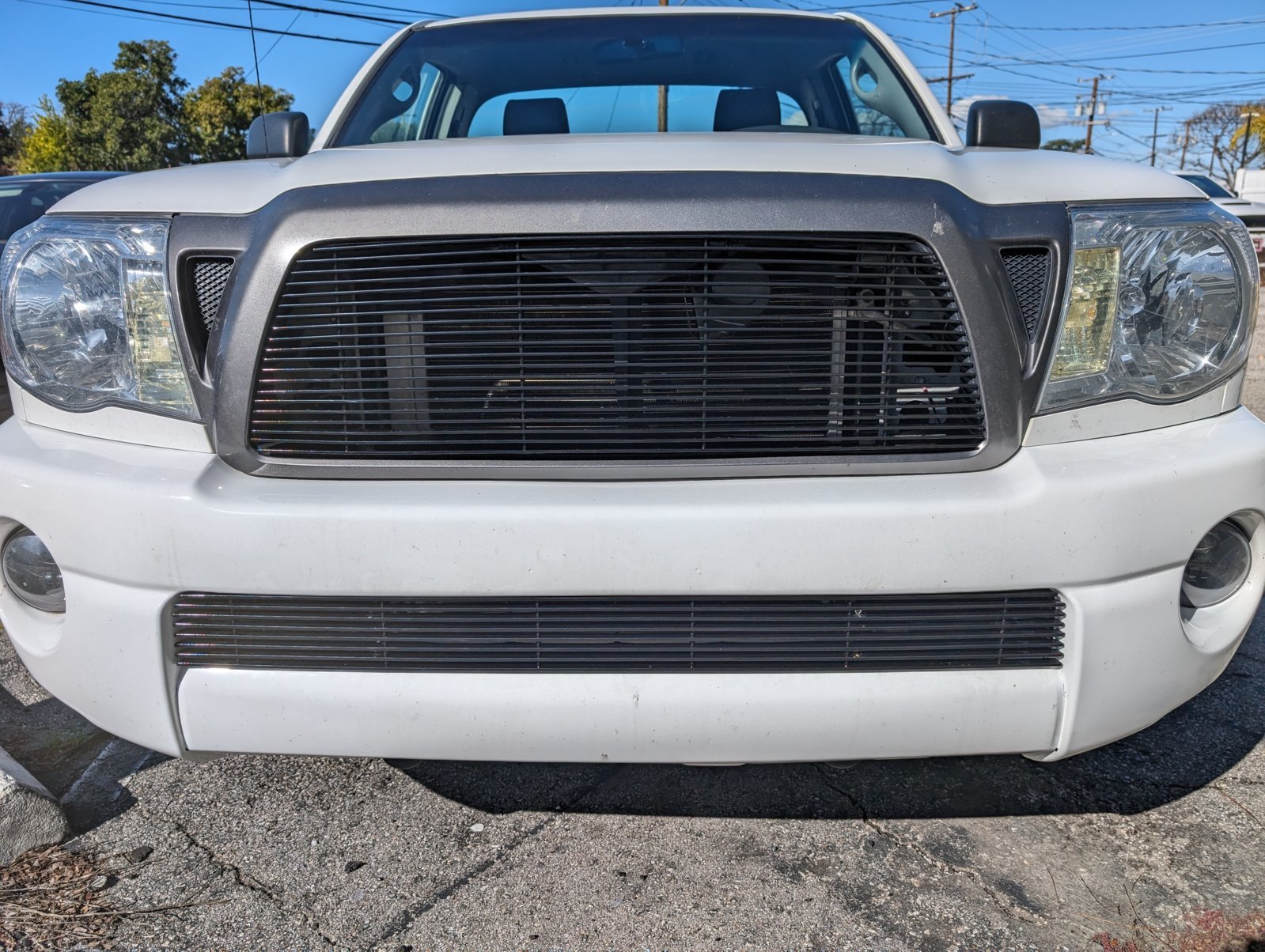

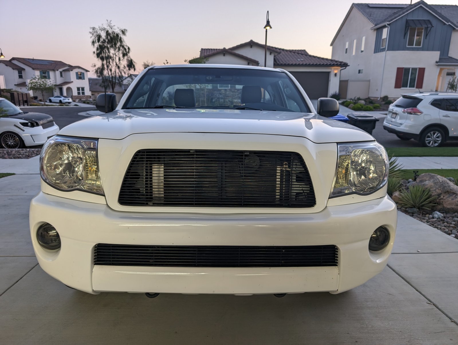

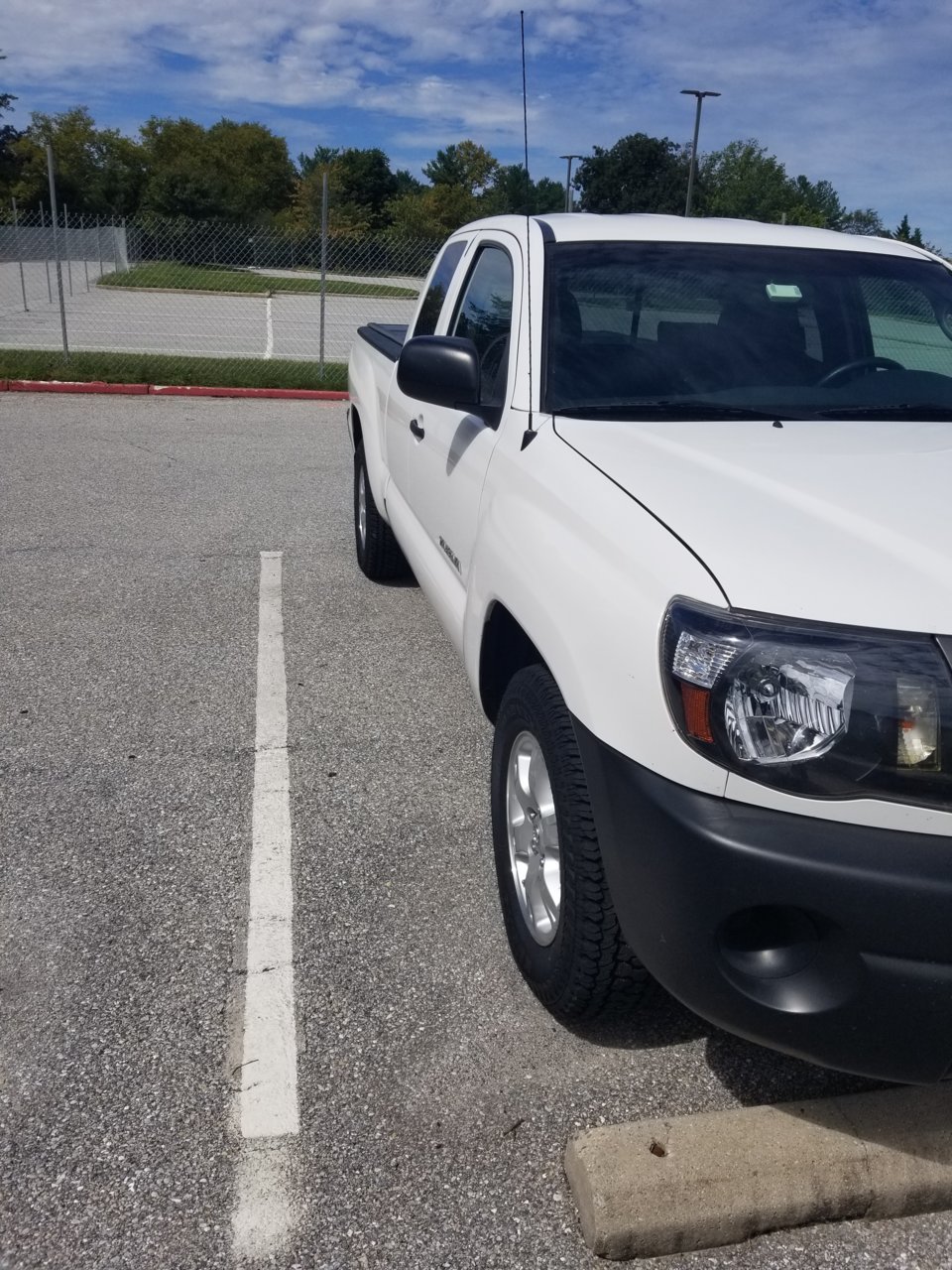

    Bit of a change up on the front end since I got my grill back from the body shop yesterday.
    Original
    And what it is now
