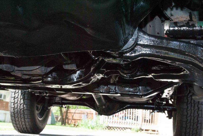

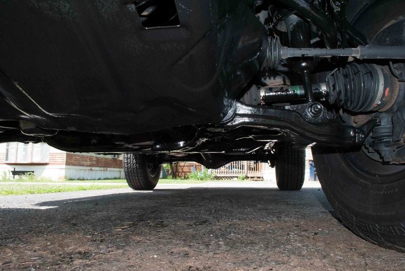

    Here are some pics of my adventures with POR 15. A friend of mine restored a 69 Bug and loved the stuff, having just lost my 2000 Tacoma to rust I wasn't taking a chance with this new to me 07. Ordered 2 quarts, the frame was in good shape really, a little surface rust in the welds that I took off with a wire brush and a red scotch brite pad. Used simple green on the dirty areas and wiped it down with alcohol before I painted with POR 15.
    I wish I had a lift, would have made life easier, thought about digging a ditch LOL. My goal was to slather this shit on, and I did get some runs but I'm not worried about it. I think without taking the body off it's impossible to get everything in one pass anyway. Next I'll take the skid plate off and light sand the drips and get what I missed the first time. The stuff is really shiny and I'm going to use a top coat as the POR 15 doesn't have UV protection, will probably spray with matte black. THEN I'm buying that Eastwood rust proofer with the spray straw and hosing inside the frame, where I can't reach with a brush. DIE RUST.
    Anyway, the POR 15 looks so pretty and clean it makes my muffler and other parts look bad! BBQ paint LOL, next project. Here are some pics, it's getting dark so I had to overexpose them so you could see the frame, makes my trim and tires look gray.
