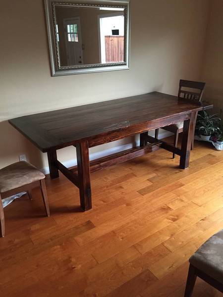

    Made this table. First thing I've ever built.

    Looks great to me! So the question is, did the bug bite you? Did making your first table inspire you to create more stuff?

    Tons of work but enjoyable work. I plan on taking on more projects. Table was easier because the farmhouse style is rustic.
    Table measures 84" long, 39" wide. 4x4, 2x4, 2x8 and a single 2x10 for the center board.

    Woot! Bout time!;) Came out great James, well done man. Absolutely love the burn technique you used.

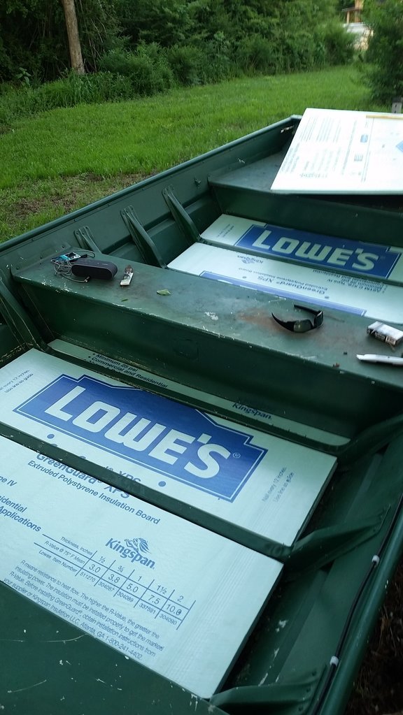

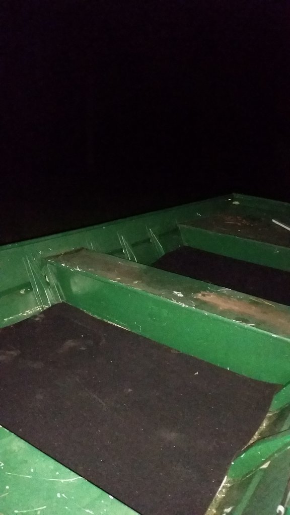

    Got tired of the plywood routine for my jon boat. Too much extra weight. Picked up 2 4x8' sheets of solid foamular, cut with a utility knife to fit, glued together with foam adhesive, then covered with 1/4" rubber mat from tractor supply. Surprisingly sturdy and tured out nice! Still needs to settle out from being rolled up for a while, and some minor trimming.

    Nice. What are the weight savings?

    I'd estimate 50-75 lbs? That might be a stab in the dark. The foam weighs like nothing, so really the mat is the heaviest part, which isn't much. That weight compared to 3/8" marine grade plywood with 2x4 supports, big difference!

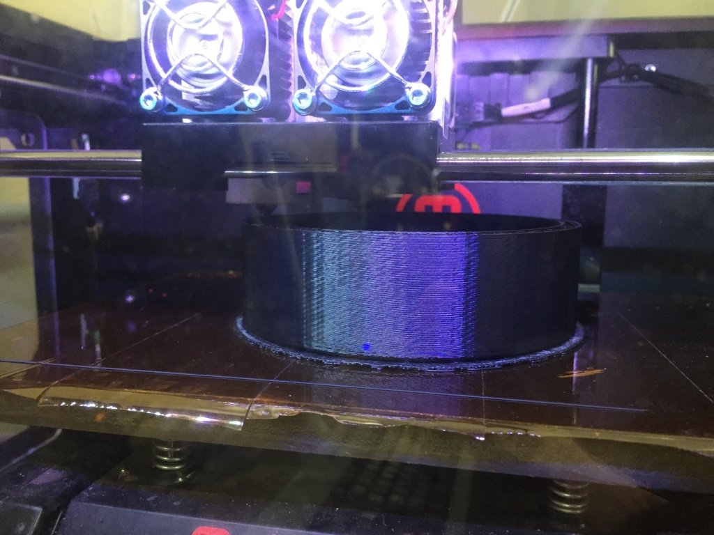

    Doing some experimenting with 3D printing today. I'm printing an insert for my cup holder that will hold pneumatic switches for my lockers. I'm using black ABS for the print, and it's only going to take 8 hours to print. :rofl:
    We'll see how it turns out.

    So far it's pretty damn easy. Which printer do you have? I'm using a makerbot. Just need a 3d model with an .stl file type. Makerbot does the rest.
    Here's the progress so far. I'm printing it upside down.
    The two holes will hold the pneumatic valves for the lockers. I'll cut out the bottom of one of the cup holders and run all of my air lines out the bottom of the cab.
