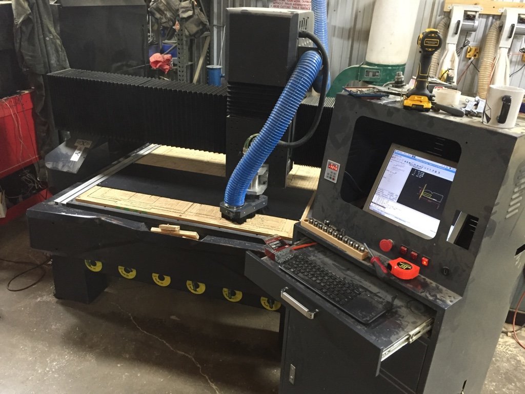

    I'm using a cnc router to cut out my skid plates. With secondary software you can also create 3d cuts, not just 2d cuts. All kinds of possibilities.

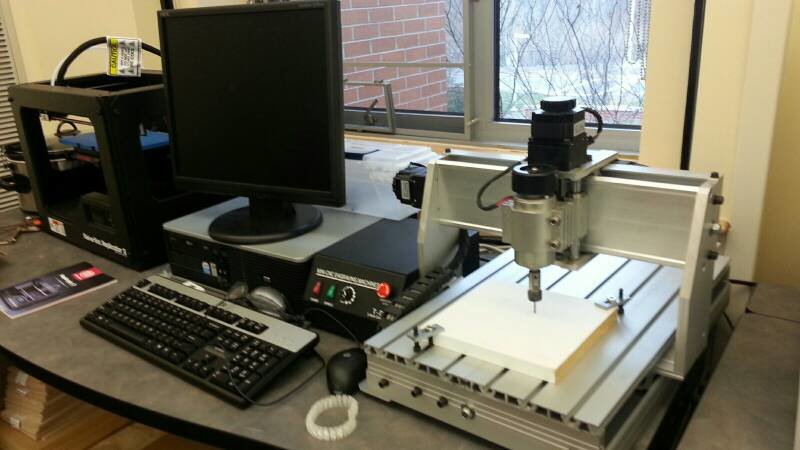

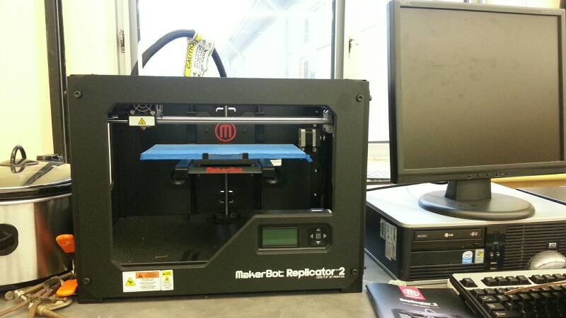

    @SMKYTXN, hey Nathan, so this is what we've got here at school, I'm in this room this morning so I'll fire up the computer at that station and see what programs operate it. here are some pics.

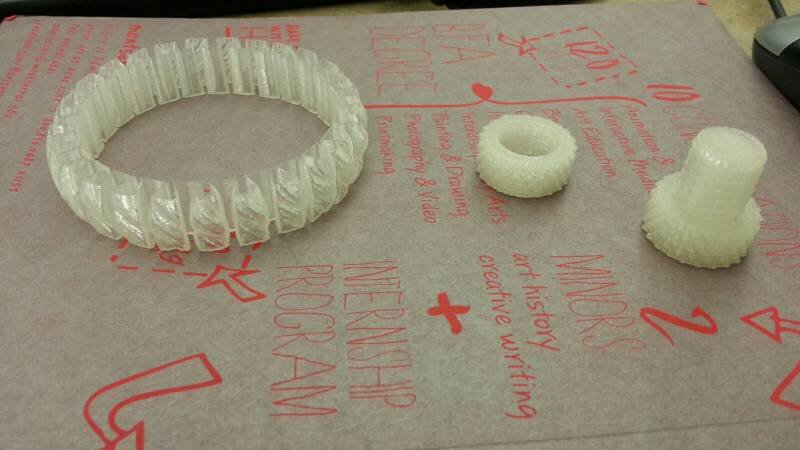

    Like what? From the information I've gotten out of the other teacher that uses this lab, she says its still not working properly.
    This is what she's made so far.

    The makerbot is pretty easy, but there are a few quirks to it. If you can model items in 3D, then you can use the makerbot. The other option is to find .stl files that others have created, but that takes some of the fun out of it.
    As far as the router, you'll have to see what software controls it. The majority of the cnc tools at my shop run on linux. We have software called sheetcam that you import a .dxf into to create your g-code for the router. The router software we have is called routerzilla.
    See what's loaded up and let me know.
