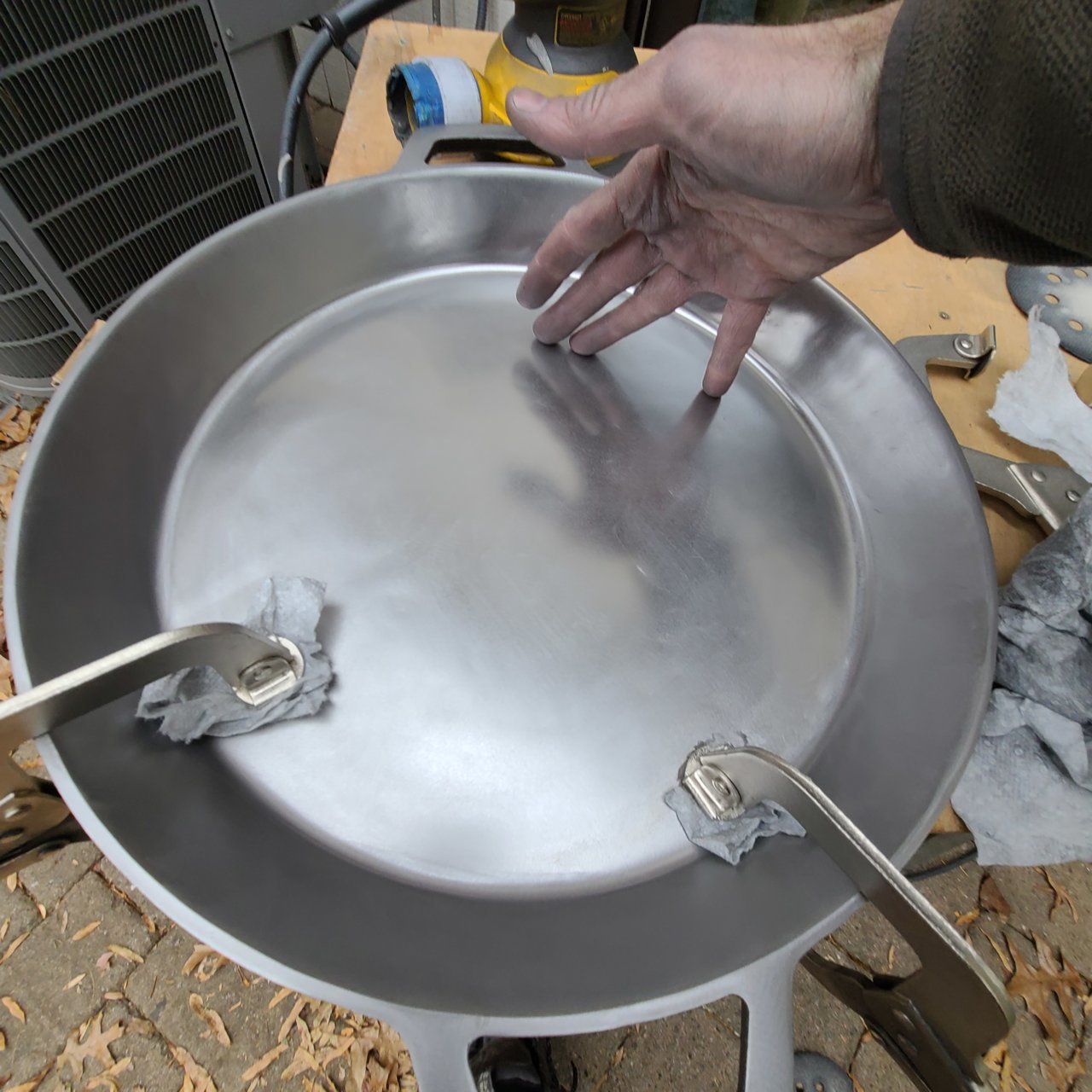

    Working on a polished cast iron pan. It was a new 16", 2" deep pan I got for $64 online. I've never had a sanded cast iron pan before but I hear they are the beez knees.
    Stared with a 60 grit flap disk then ocilating scanner with 80. I still have a few scratches from the flap disk but I'm almost there. Maybe 1 more hour of sanding before it's done.

    @soggyBottom - what is the benefit of a polished cast iron pan over regular cast iron?

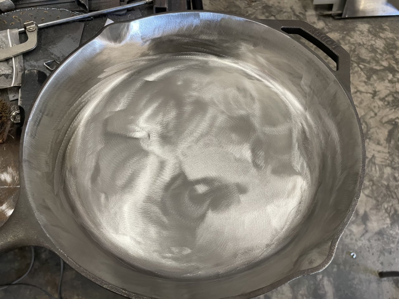

    This was halfway through my most recent one. I’ll likely avoid textured pans from here on out.
    Edit: While this one is a Lodge, they’re pretty awful when it comes to uniform thickness. I had to dig pretty deep in some areas and finish smoothing everything back out

    Butter creates a better barrier between the cooking surface and the food, while oil cooks out from under it (relative to each other). The smooth surface works better for this reaction. Textures create pockets for food/seasonings to wedge into and cook unevenly - that isn’t to say there aren’t uses for it.
    Seasoning the pan is the same as textured (process of polymerization), but maintaining it DOES take extra care because it does not have those “pockets” for better adhesion. After 5-6 cooks, rinsing/scrubbing, wiping with high temp oil, and bringing beyond the smoke point, I can get a solid seasoning worthy of metal utensils.
    Again, there’s science arguments for both, but it all comes down to preferred cooking style/method.

    Better non-stick properties than the rough stuff. How much better? Not much. But cast iron pans last a long time, and these make great gifts that don't cost too much time or money to make.
    Way back like $100 years ago they didn't use sand casting to make cast iron. Pans were made by hand. The sand casted stuff we have today costs a lot less. You can find old sanded pans but they generally run about $600+ for a simply frying pan.
    The down side to sanding is that it's a little harder to season. Too much material removal can cause a weak point and result in cracking over time.

    What did you use to sand it?

    Get a whole bunch of sanding disks and a good ocilating sander. Don't bother with a cheap one like a Ryobi, they break too fast. If you've ever polished metal before, it's the same exact way. Staring with the roughest grit, sand u til uniform. Be sure to wipe the pan before moving up to a higher grit. 320grit is more than enough.
    If you want a mirror finish, after 320, wet.sand to 600, and use jewelers rouge on a buffing wheel. The last part goes really fast a.s will make it look like chrome. This stuff rusts very fast so don't take too long. Cold temperatures slow the rate of oxidation.
    There are lots of.youtube videos too.

    40/120/320 flap discs and then went 800/1000/2000 wet sand by hand. Polishing wheel to finish.
    N95 mask, cotton shirt wrapped around my head twice, and a grinding shield :rofl:

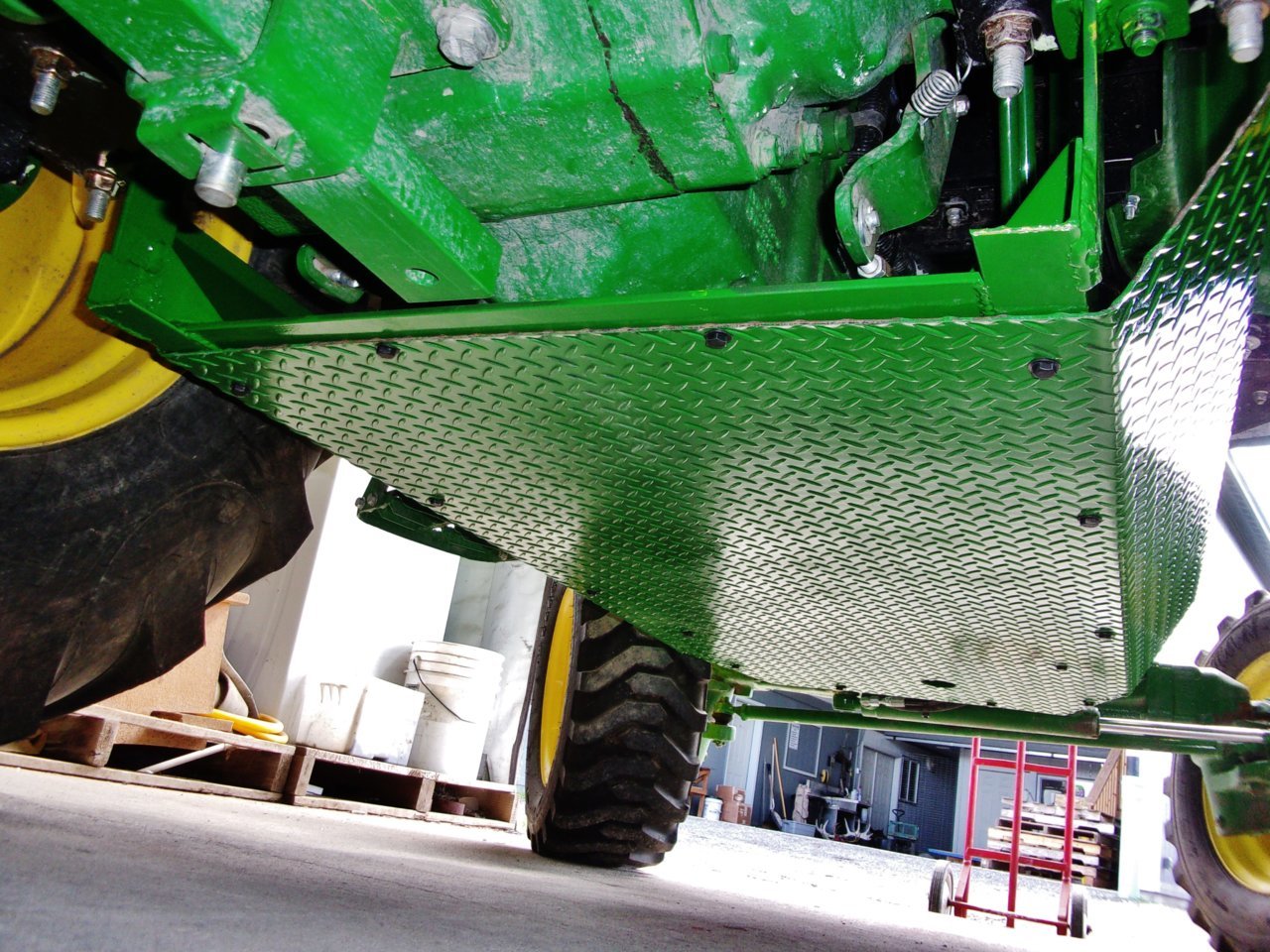

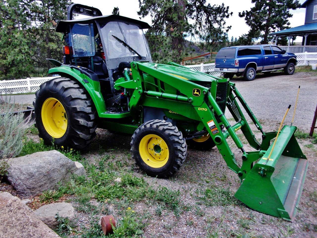

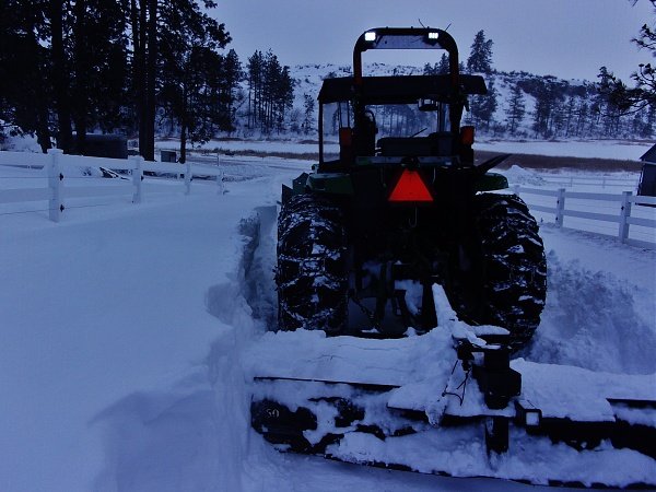

    I bought a JD4044M 4x4 Tractor with out a cab so I made mine. I waned a Soft Top with Lexan Windshield and Side protectors for me from branches getting wacked. Side ABS protection on the engine from sticks too. I also wanted a Skid Plate and both of these are not offered. Needed some heat so I used a Oil Cooler at my feet with a fan to blow heat up. Skid Plate can hold up the tractor and was a fun build. Made a Brush Guard and Put a Winch on it too. Lots of LED Lights to see in the winter night plowing snow.First one out (600x450).jpg They made a Hard top for the JD Tractor but way to high to me? Here are a few pictures of this project. A before picture when I got it.JD 4044M.jpg 100_0355.jpg 100_0351.jpg 100_0355.jpg 100_0538.jpg 100_2587.jpg 100_1700.jpg 100_1698.jpg 100_1126.jpg 100_1122.jpg 100_1118.jpg 100_1135.jpg 100_1104.jpg
