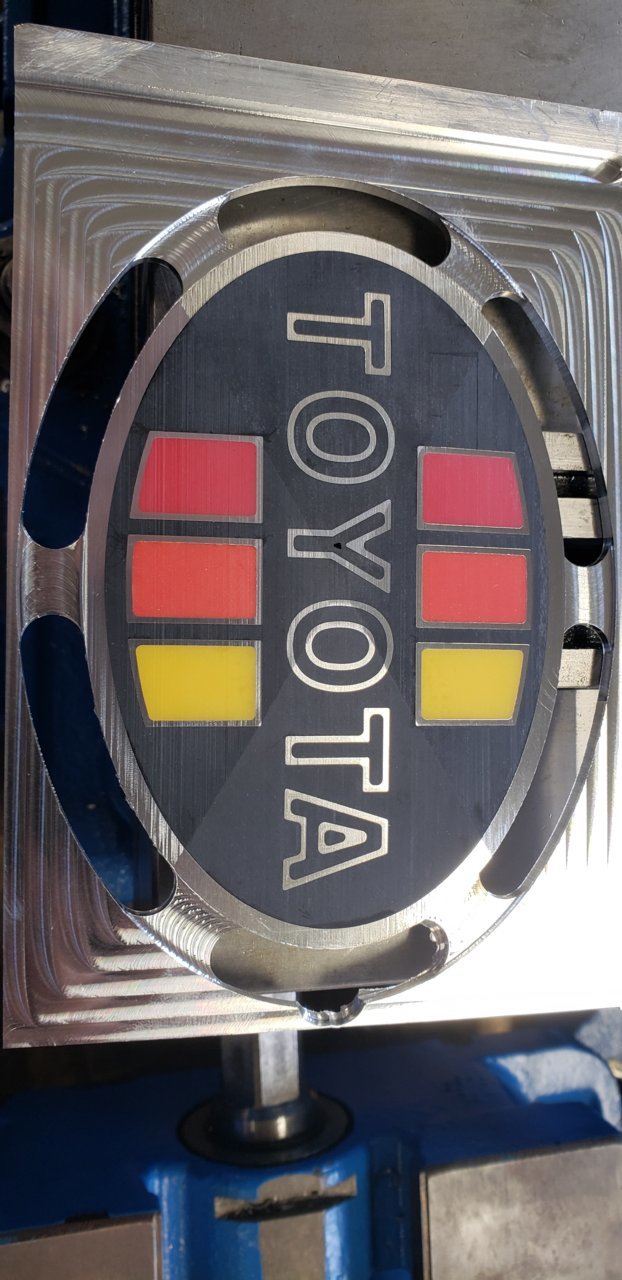

    How is this done? cnc milled, then filled with colored epoxy and sanded flat? Looks like whatever filled it in was automated too?

    Cnc Mill, filled with colored epoxy using a syringe, no automation, after letting it dry for a week it went back in the mill for a 3d profiling op and finished with a sanding pad to break the edges. The pic with the steps was just a roughing op.
    This is it after the 3d profiling, before hitting it with the pad.

    Ahhh so this pic was after it went back in the mill again, that makes more sense now.

    Yes. I just thought it looked cool.

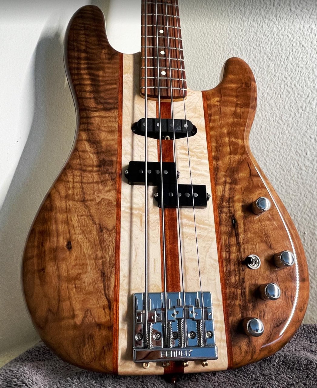

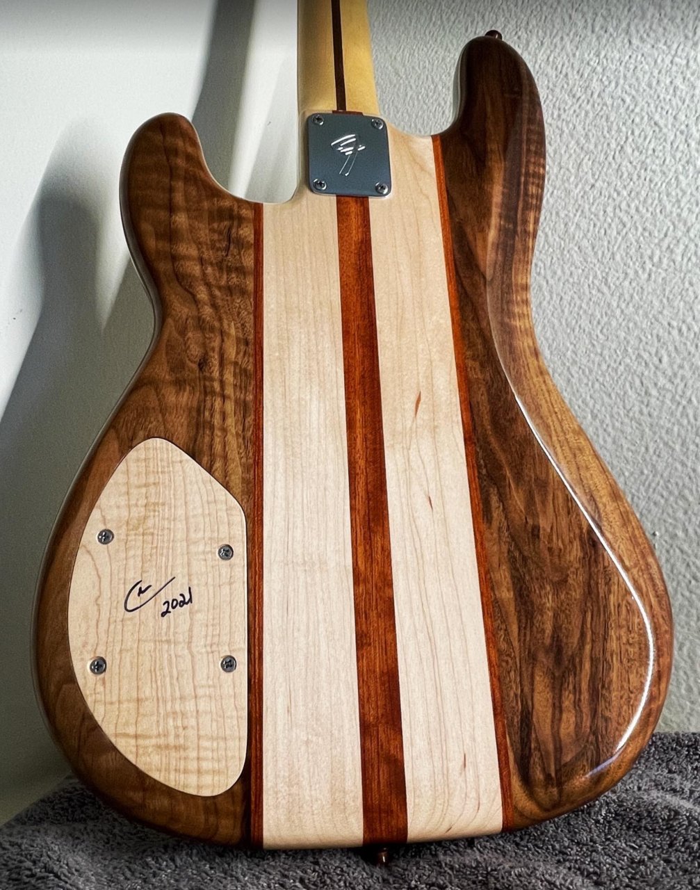

    Made this for my dad last year. First attempt at a bass/guitar:

    10/10 - it's got all the funk.
    Maple, walnut, and...padauk?
    Edit - mahogany? I think I recognize that grain...

    Mahogany, Maple, and Bloodwood (don't remember which one though)
    I was thinking Walnut when I typed Mohagany. It's WALNUT. :facepalm:

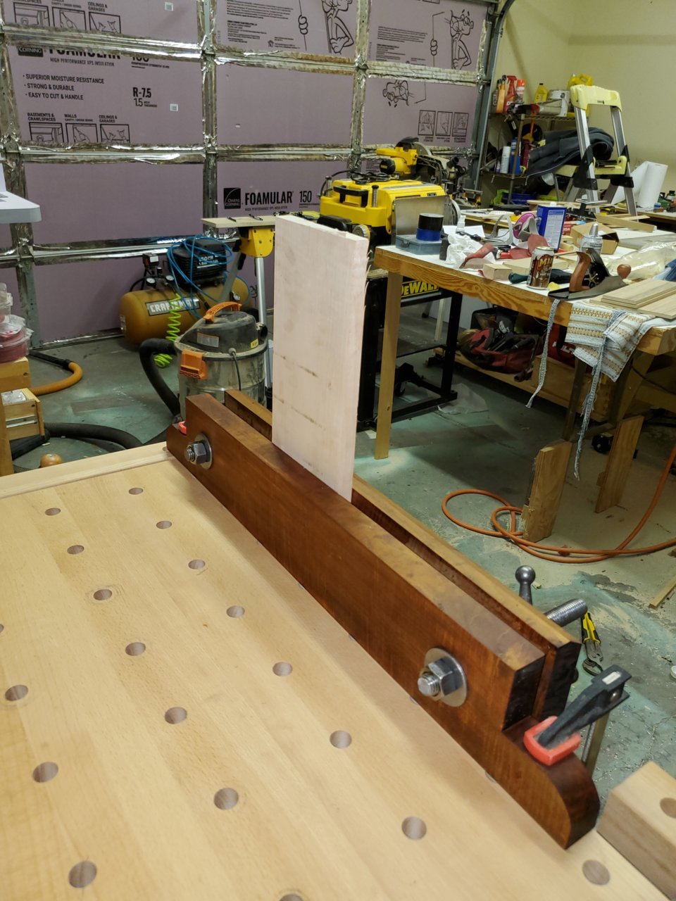

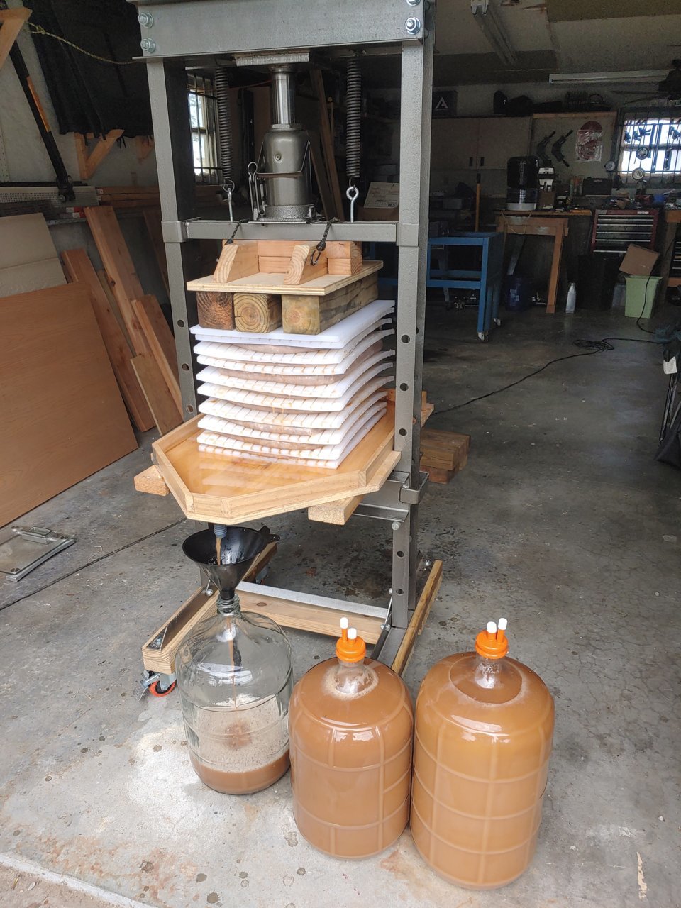

    Made sixteen gallons of juice from roughly 123 lbs of pears. In a few months I'll have a decent-sized batch of hard cider ready.
