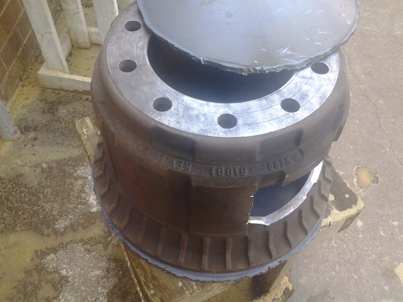

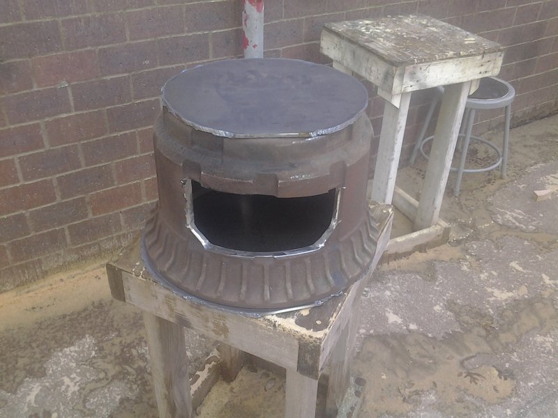

    Drum brake from a city bus. And it was free.

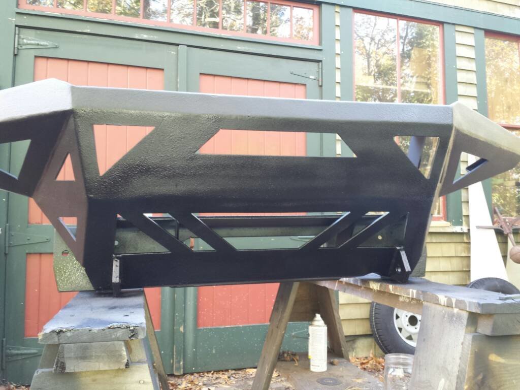

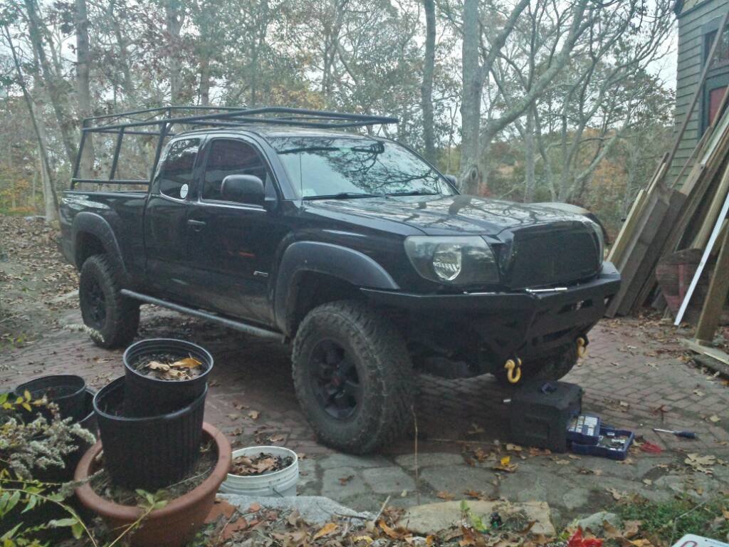

    This weekend I took my front bumper off I built a couple years back, and chopped 4" off the bottom, added some gussets and put some shackle mounts on it as well. Put the final coat on this morning before work, hoping it'll be dry enough at the end of the day to put back on the truck! 2cff91caf479d07364f9b3bd12f06de7_e515134e680feab63468bbf147829ceafbebba3c.jpg
    Early test fit after adjustments yesterday90c6d545860abd1155f0dc3b47236d1a_438755201c0f3142c9dcefbf44f9c3db93d19108.jpg

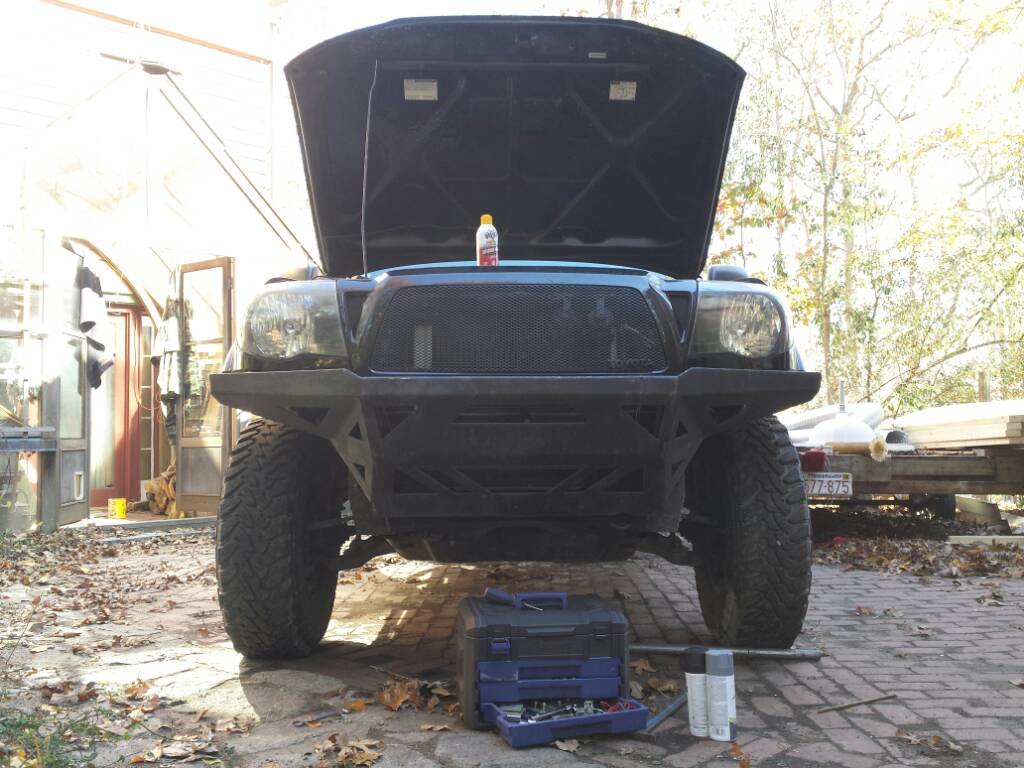

    7c45a72476738fe948956f3a82bd33cf_baf799707bc1ef18d1e6bcb9c53cd853d7f289a4.jpg and it's all buttoned up! Next weekend... Rear bumper...

    Nice work Cam, that turned out great along with the rack too! What's left for the rear, are you adding anything to it or just sand it down and paint?

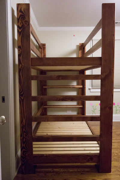

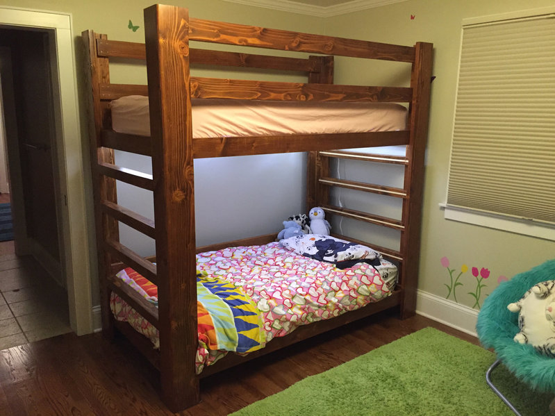

    I finished this last week.

    I like where this is going! :popcorn: can't wait to see more!

    Massive drum! Very cool.

    haven't gotten around to it yet, but the rear needs sanding and paint

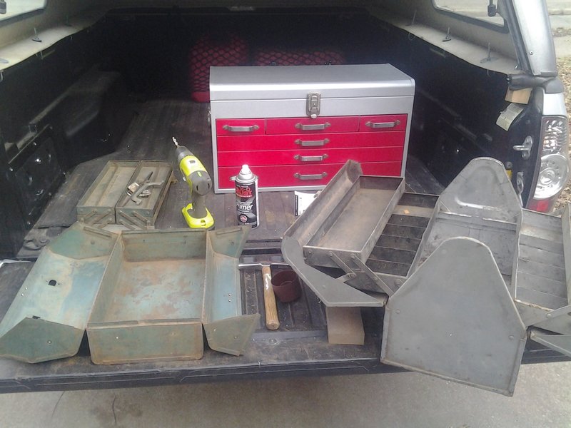

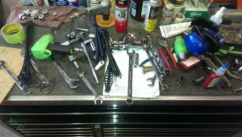

    I think I found my new hobby. How I have spent my afternoon....1449871794713-1066196448.jpg

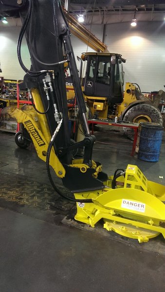

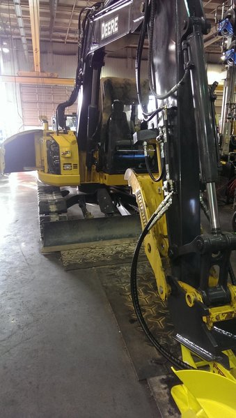

    I turned this excavator into a big mower it took me 40 hrs to do everything about this was custom nothing from a kit , and yes Im a huge snap on whore

    That's pretty impressive! I take it that's not a normal attachment so you've created a way to make it work?

    Ya I had to plumb into the 2nd aux spool on the control valve it's nice the new G series excavator has 3 pumps rather then 2 so I could get enough flow to run the mower and still have a second function work , I did all the fab and plumbing up the stick and the boom . All the custom brackets are so time consuming and double and triple checking hose lengths. Hydraulic hoses are so expensive

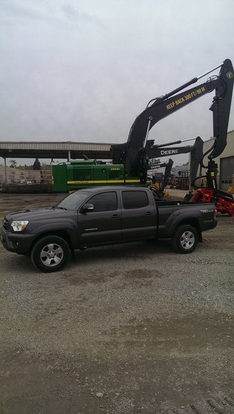

    And heres one of my truck with a processor, that head is crazy it cuts the tree down, bucks all the limbs off , cuts it to length and grades the wood and it has WiFi , the attachment on this guy is worth a 1/2 million then what ever the machine is worth @3/4 of a million

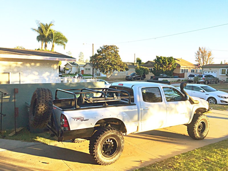

    Finished up the bedrack for my truck this weekend. Has gussets/tie off points and hi lift mounts.
