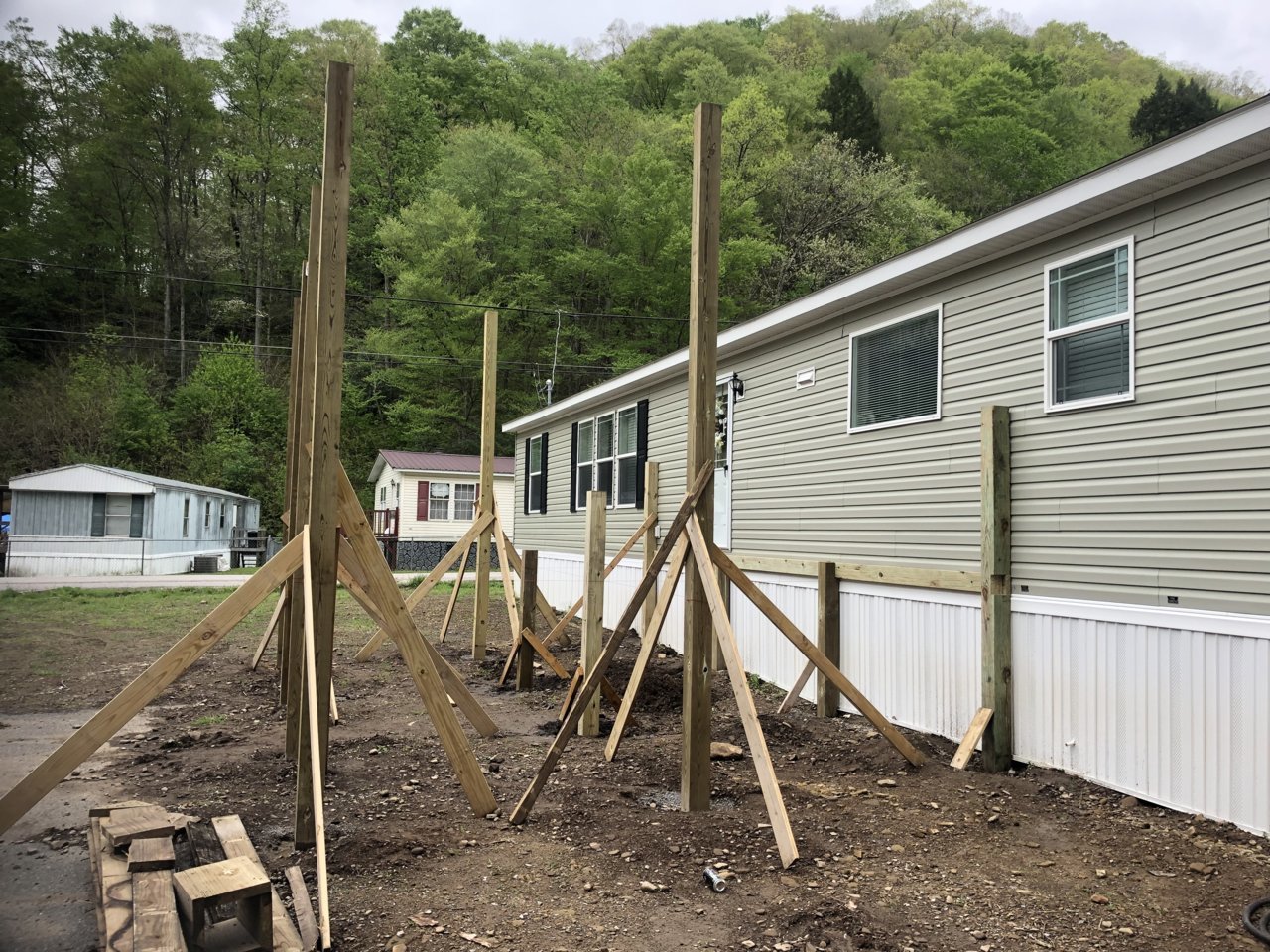

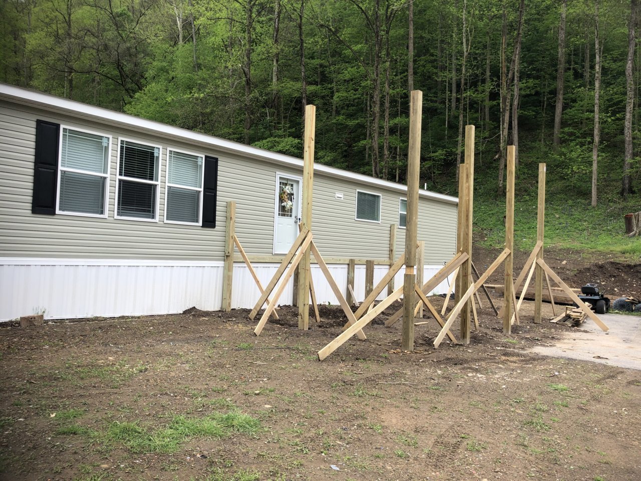

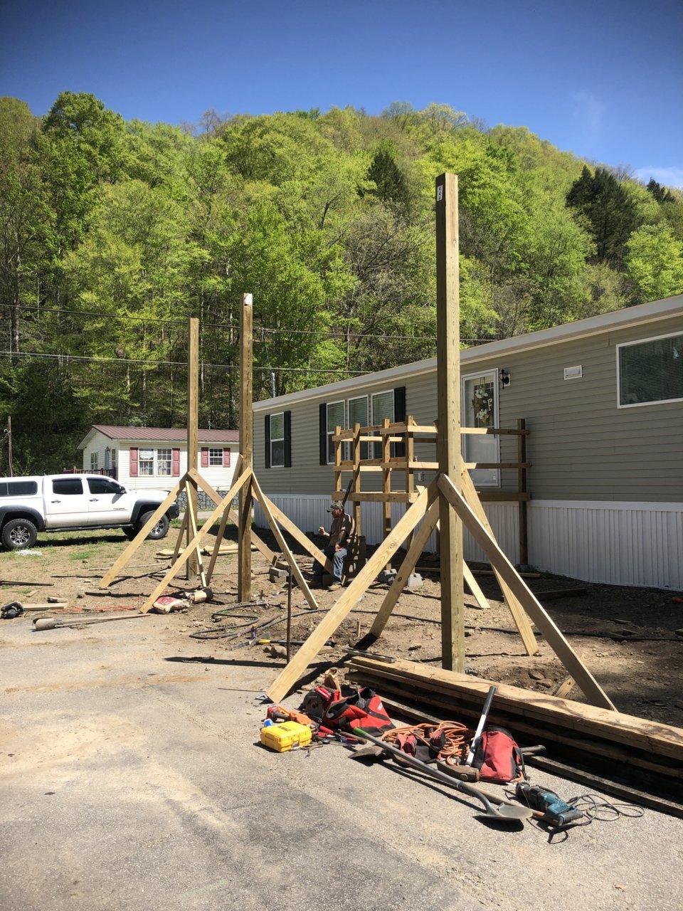

    got a nice covered deck started!

    Yea. Going to be a 16x24

    are you attaching to the house or free standing?

    Holy braces Batman!
    Looks great
    u gonna run a metal roof?

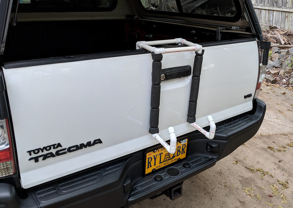

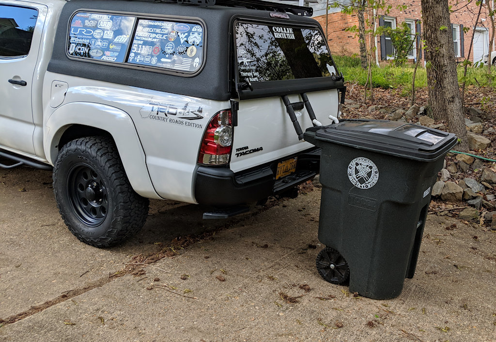

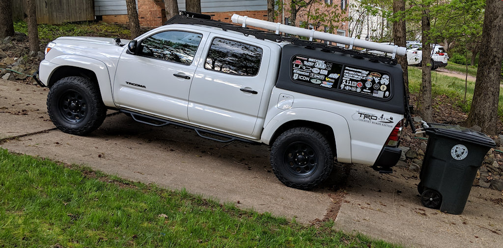

    Necessity, it is said, is the Mother of Invention.
    I live in a hilly subdivision and my house sits up on one of the hills. I have a 100-foot, somewhat steep driveway from my garage down to the street. Every Friday, I have to take my trash and recycle bins down to the street for collection. Taking them down hill isn't too bad. Dragging them back uphill, despite being empty, is quite a chore. And I'm too old for that shit.
    So last night I conjured up this idea to use the Tacoma to pull the bins up the hill for me. But since the bins don't have a hitch, how would I attach them to the truck?
    This is how. I went to Lowes, picked up about $20-worth of PVC pipe and various fittings and came up with this. When it was done, I wrapped some pipe insulation around the middle section to avoid scratching my paint.
    First time I tried it, the bin fell off. But with a little re-engineering it worked out great.

    That’s cool, we got a long steep driveway also. Will have to do this for the wife when I’m away

    Great idea, We don't have a long driveway but live on a steep hill. Sometimes the wind takes them to the bottom in a big pile. I did use a stencil and paint the address on all my cans.

    Great idea and a nice design to boot!

    Attaching to house. Posts are sunk is 20 inch round, 24 inch deep holes. Dont want it to move, lol

    Going to shingle into existing roof. Its a new home or would do metal. Maybe down the road its possible.

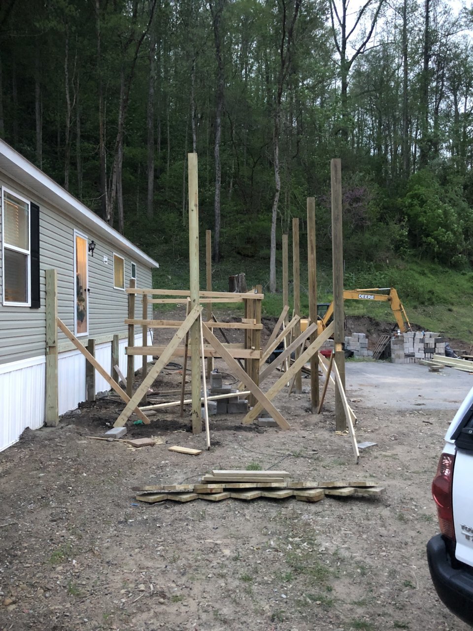

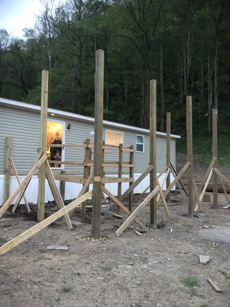

    89B5A0EB-0164-4D04-9DC0-2A3EE3000B3C.jpg D0FE0AA6-F902-41C7-9651-A86AD9FEE1D0.jpg Set my last two supports in the middle. They both have to be trimmed down a little, but will hopefully start my framing for my floor joists tomorrow evening, and have them framed by wednesday morning. So i can start laying my deck boards, once their on i can start working on my roof. So hopefully within the next two weeks at most it should be done. Hopefully. Ill post pics as i go, this is the biggest thing i have ever done. LoL

    Right on :)
    I would for sure run frostguard (bituminous peel and stick underlayment) all the way up the porch roof due to shallow pitch but u prolly already knew that lol

    Looks useful. That hill looks quite steep.
    Nice job! I cant stand a crappy deck. The foundation is a major portion of the work.
    I put a small one in on a neighbors place about 4yrs ago now...sadly its outlasted the owners. Deck still looks nice though
