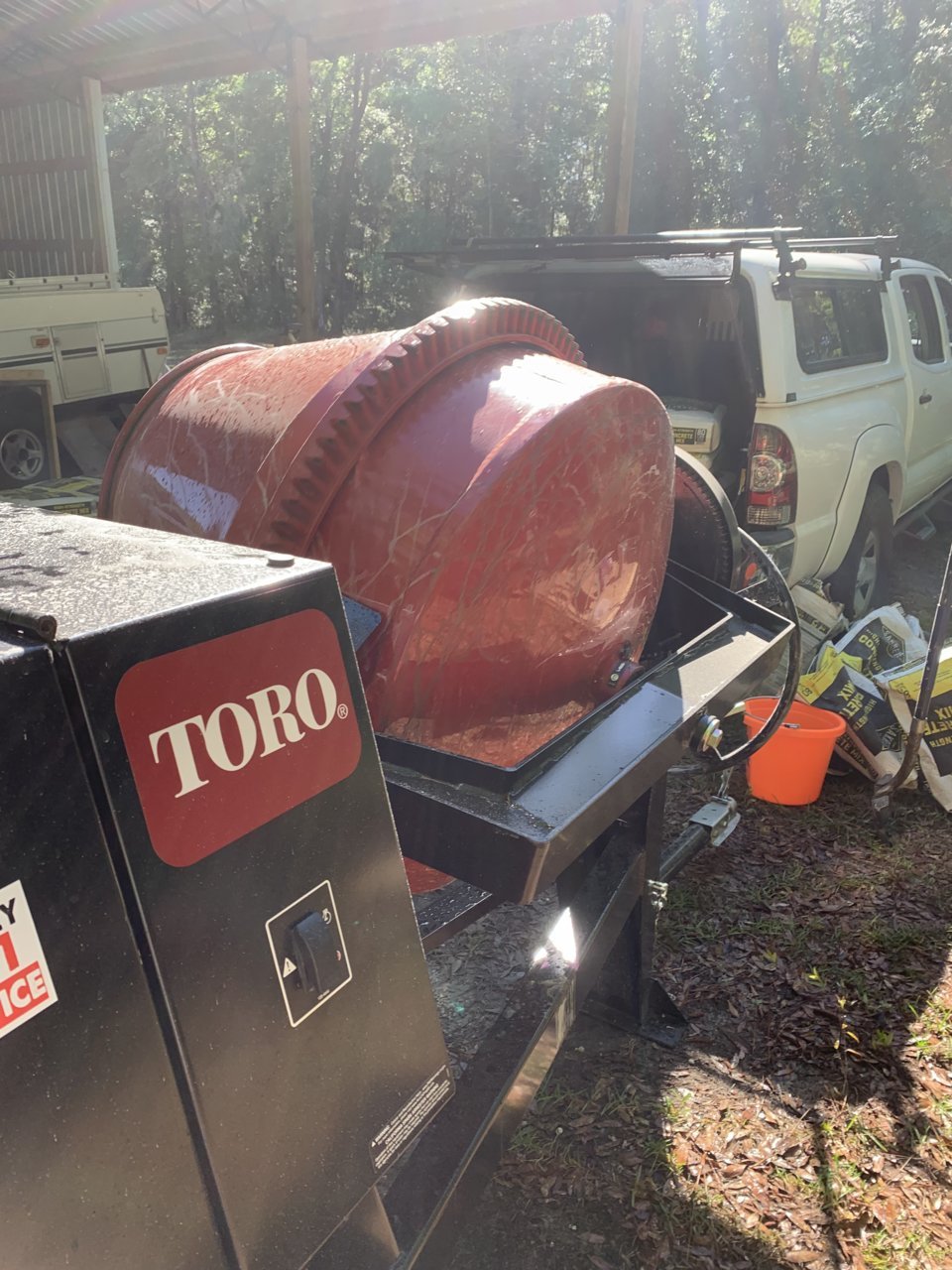

    6625390F-7E01-4DF8-8378-862D81F4D705.jpg Rented the mixer for the win

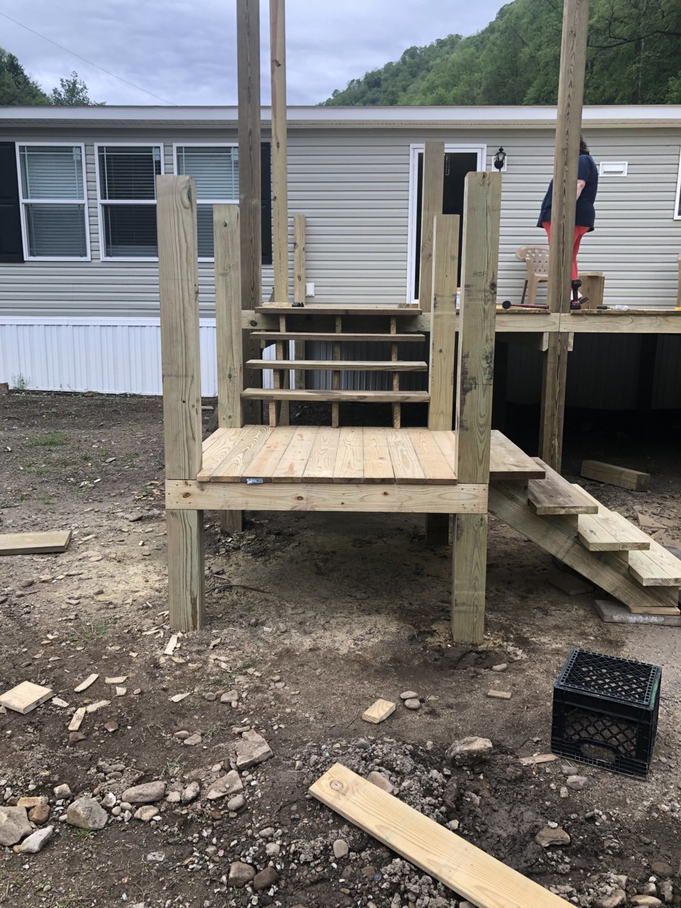

    F5B0D445-60B6-4BA2-AE59-B5347A8DB6AF.jpg 76A75BC5-ED4C-461B-B2C9-9084F66A7407.jpg 6290A482-AE3C-40DE-BD74-0D29CD335B56.jpg
    Got a little more accomplished today, finally have steps to the front door again, you have no idea on how much ive missed using my front door, lol

    When you make something with posts like that you leave them long. Then you’ll use a line level to mark them all at once and cut them to the correct height.

    looks great!

    Thanks, i need to recut the step stringer on the bottom to have 5 steps instead of 4. I wasn’t thinking when we cut it, and thats why i have those blocks on the bottom because that last step was about a 11 inch step instead of a 7 inch step. So i may recut them sometime in the next week or two, or maybe just pour me a concrete pad under it. Im going to get my driveway resurfaced in a couple years so ill need to make sure thats seperated anyways. So it may be a pad in the near future.

    You might do better with the concrete pad. We built something like that at my grandfather’s place in Georgia, and surrounded it with gravel. He used the gravel to wipe his feet before getting on the step, then wiped his feet again on a big used tire mat he kept on the slab.
    Man hated that red mud on his stairs - if it got remotely damp it became frictionless lubricant.

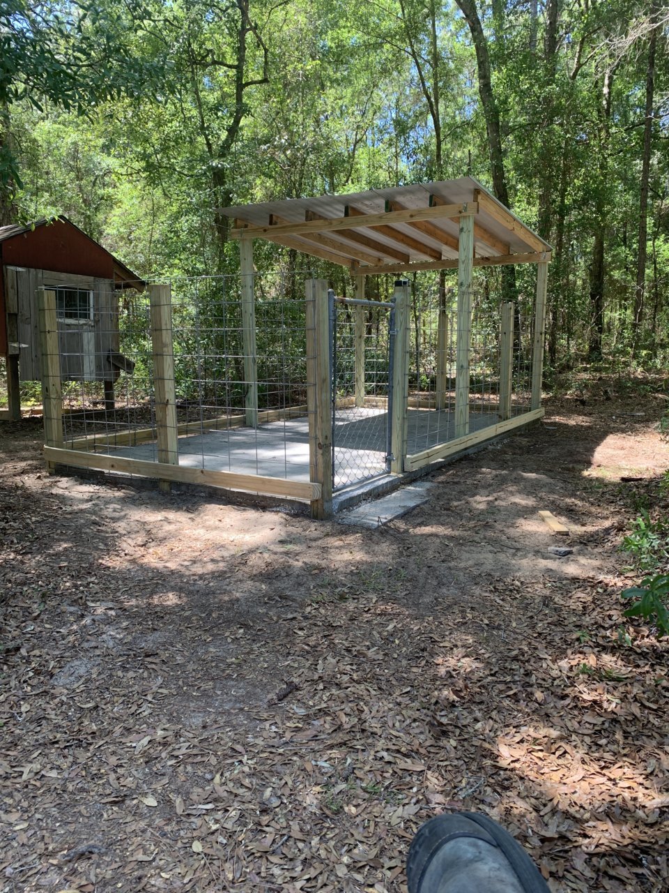

    image.jpg Just have to cover the post with wire cloth and move the pigs

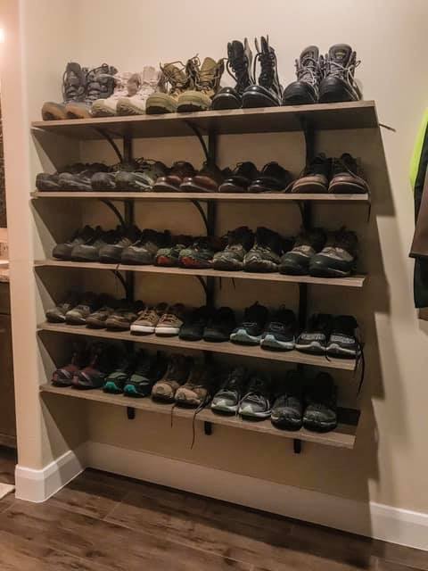

    You need a pair of Chacos in your life... :boink:

    Looks good man. Looks good

    Thanks pigs should like it for a couple months

    I do have them! I have a whole separate storage bin for them! There’s 3 pair in there plus the ones on my feet.
    I had half a dozen more... but, you know, that fire thing ate them.

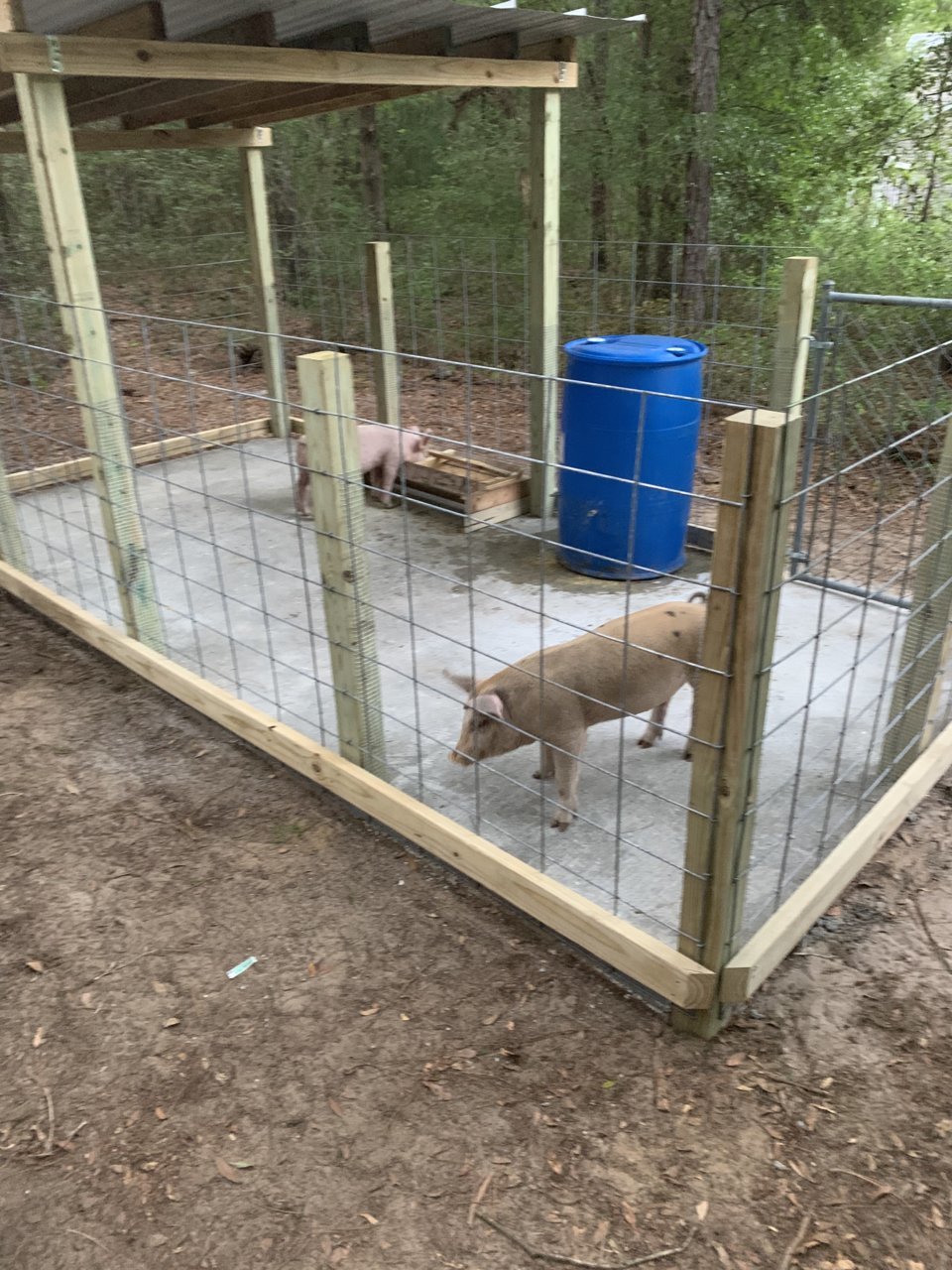

    Moved in and done 9EB3DC79-2CED-4817-BF07-9A0D186A1ECA.jpg B9045369-415A-48DB-943A-83E487A612E8.jpg

    Mmmm... Bacon in the makin'. :hungry:
    Pen looks good too.
