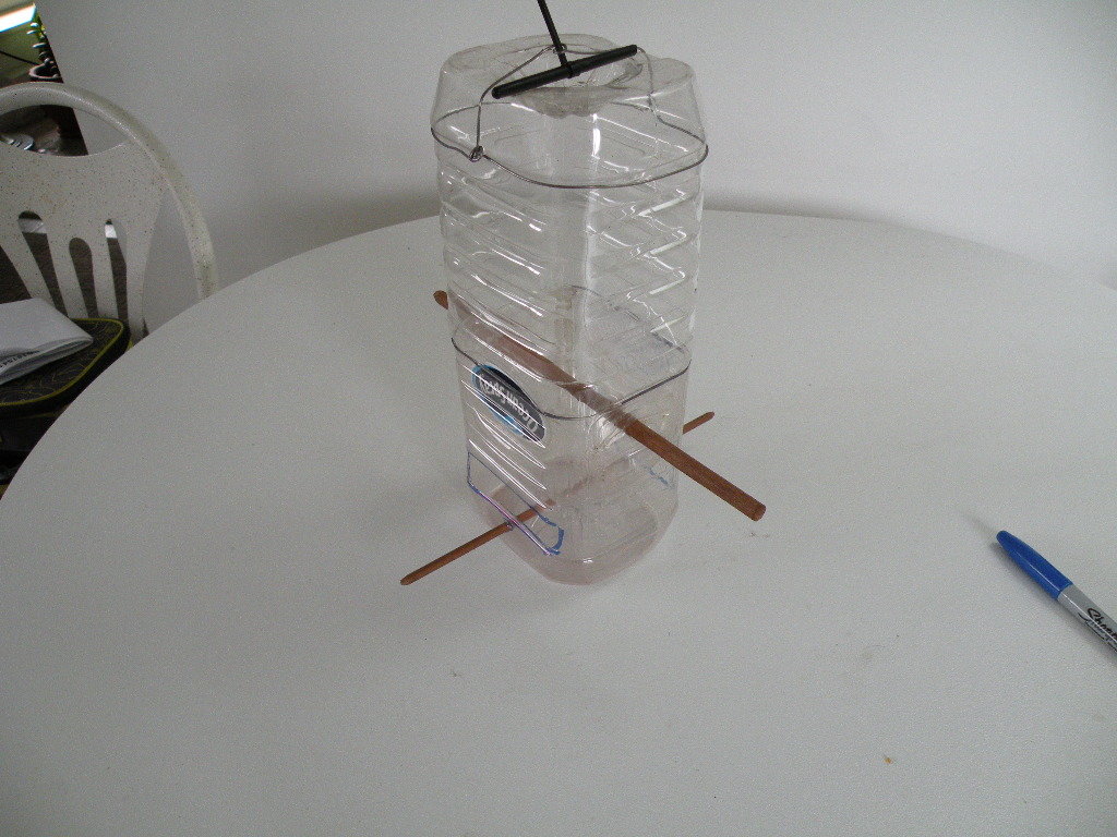

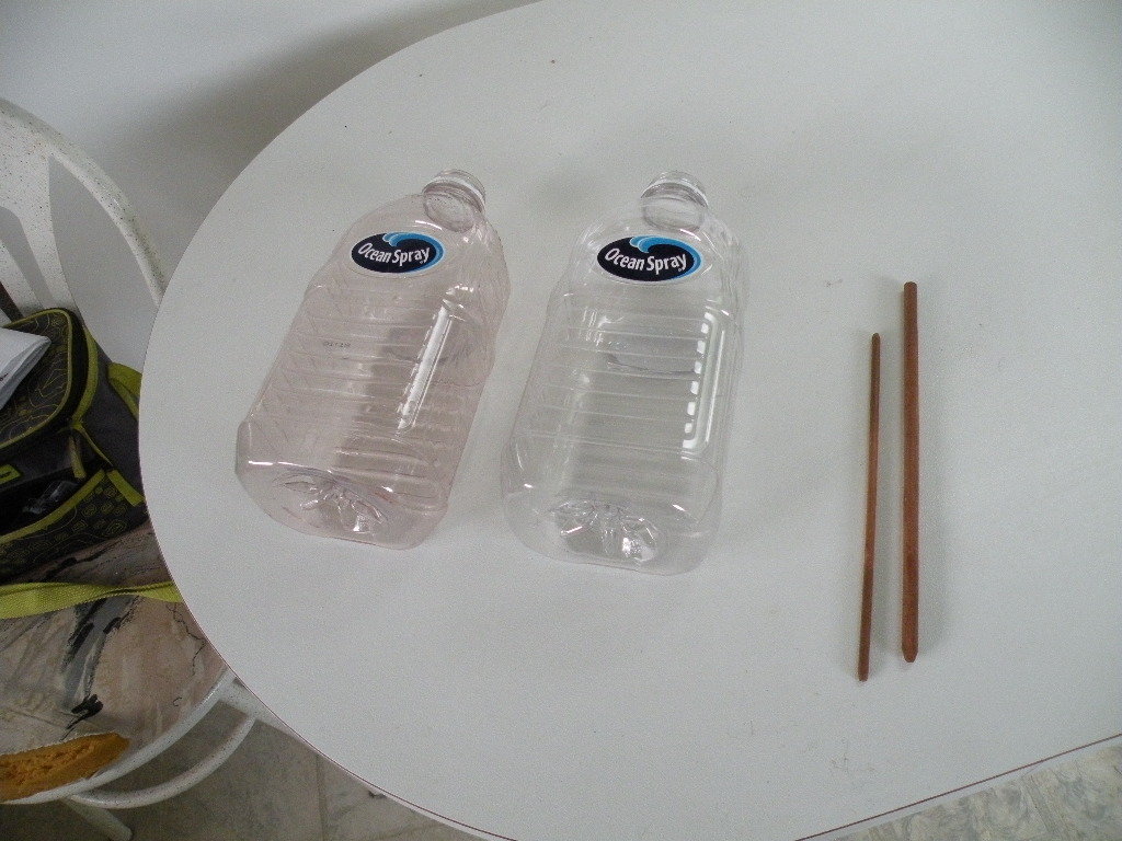

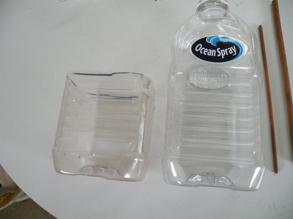

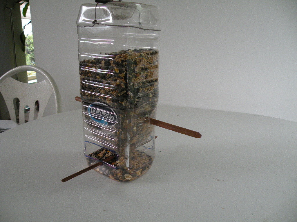

    How about a bird feeder made from two plastic bottles and two pieces of dowel.DSCN4183.jpg DSCN4185.jpg DSCN4190.jpg DSCN4192.jpg

    looks like it will work! Good re-purposing!

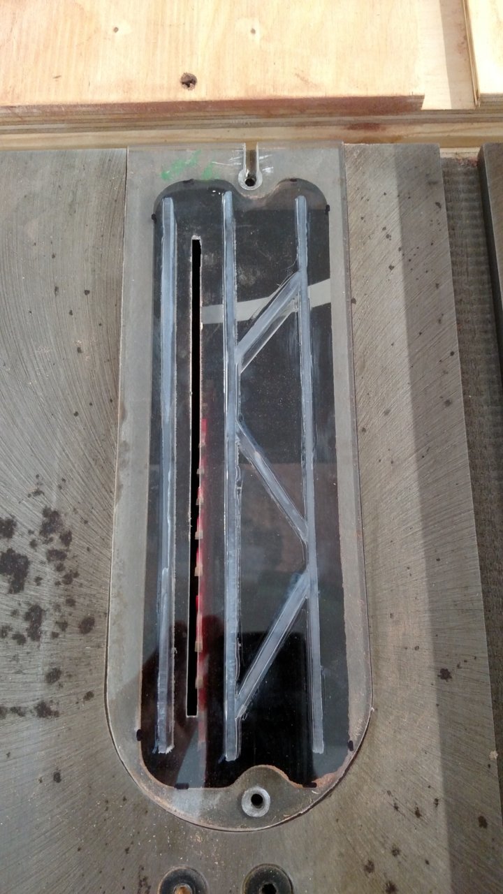

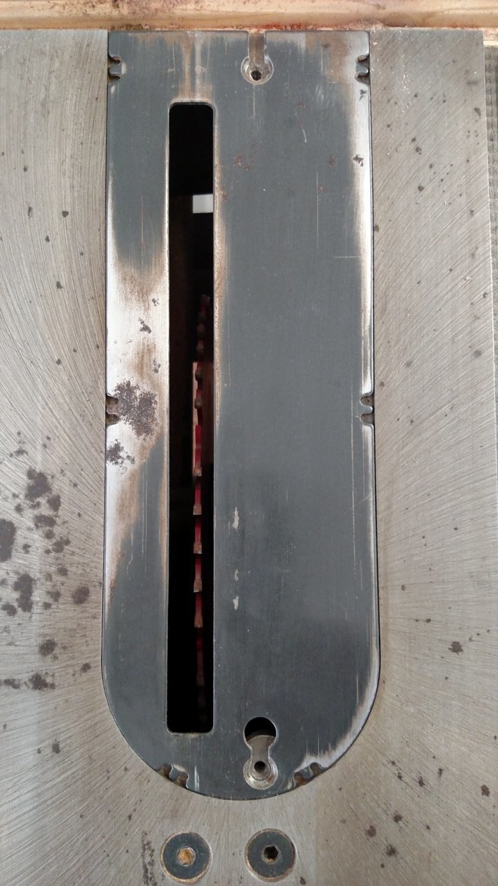

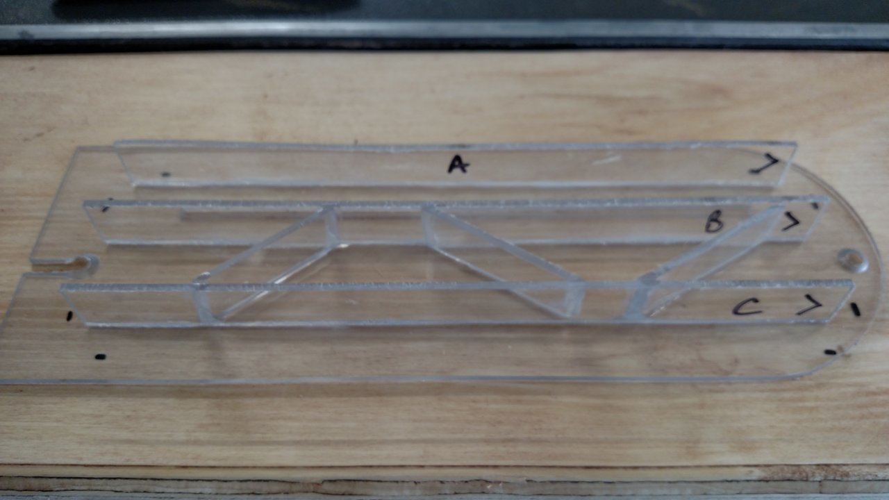

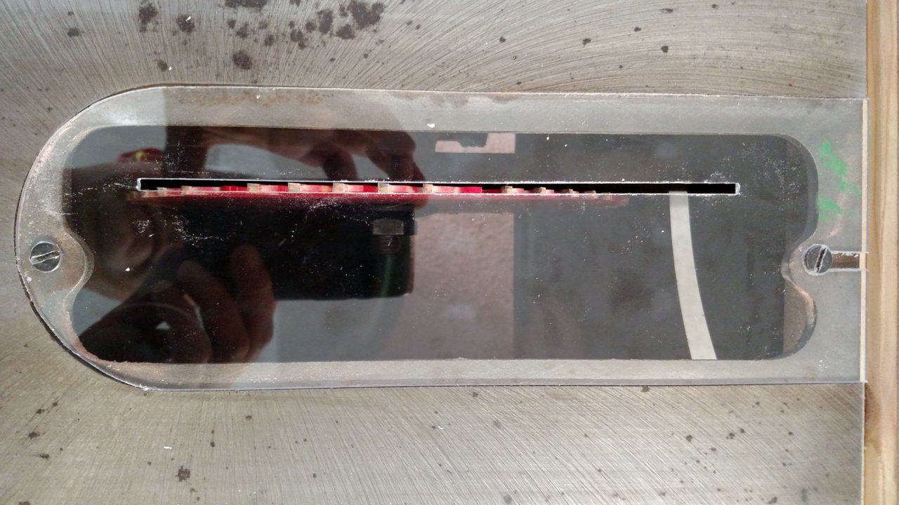

    So.. this table saw I acquired recently was made in 1974. Obviously safety has come a long ways since then but despite many online searches I could not find a zero clearance table saw insert for this 9" table saw.

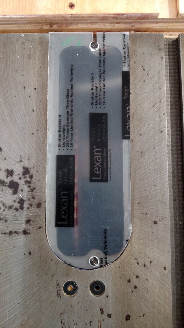

    So after some pondering I decided to use a piece of Lexan (this is NOT plexiglass).
    Luckily for me Home Depot carries a selection of Lexan and in the perfect thickness (0.93").
    A quick outline from the original piece and a few minutes on the bandsaw and violà!
    No it's not perfect but it's pretty close. After fitting the screws and making sure it was all smooth I plugged in the saw, turned it on and slowly raised the blade to the maximum height.
    Now I have a perfectly sized hole without having to worry about small pieces falling in the large original hole and getting flung at me!
    With that project done I moved on to cutting down some boards and found the Lexan was a little too flexible.. so ... Back to the band saw I went with some of the left over Lexan and a few minutes later I had a solution.
    Basically I just made some support strips and then superglued them to the bottom and added a couple of cross pieces.
    It's not pretty but it works and increases the safety in my Garage.IMG_20190810_172019641.jpg

    Nice job but what happens when you want to make an angled cut?
    truchador and wilcam47 like this.

    Put the original piece back in?
    Not being a smart ass.. just never thought about it since I haven't made any angled cuts on the table saw.
    Edit: After a quick search it would seem that I would have to build a whole new insert for say a 45° cut and then set the blade to 45° and raise it through the new piece

    Correct. You typically want separate zero clearance setups for any of your common cuts.
