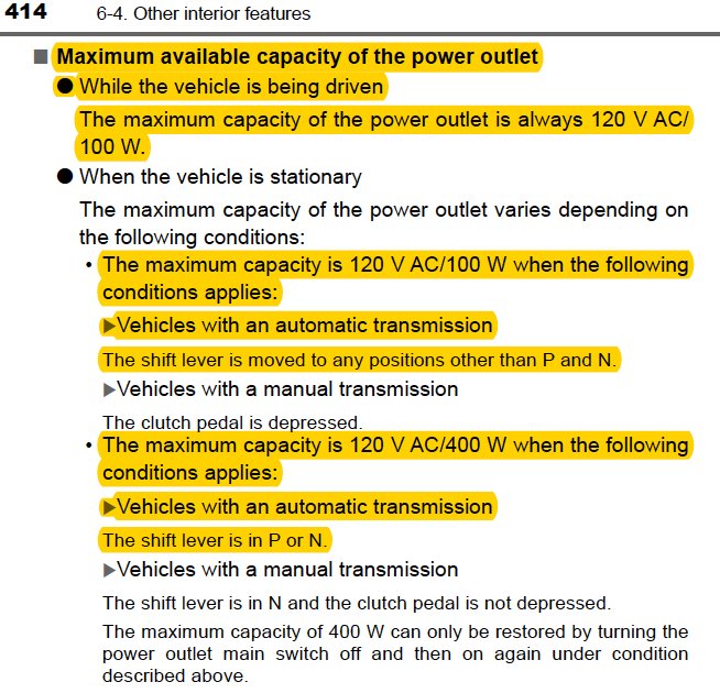

    Did you have any problems?

    Remember that to get the 400 Watts the truck has to be running ! One can only use the 100 watts while it is off or about .8 amps. So a phone charger or a lamp with a 75 watt bulb are safe to use .
    Edit , this may be wrong , the page from the manual is a couple posts down from here . It is not clear to me .

    Oh , so I guess it is when the truck is off it is 400 watts ? I think the manual could have been written a little clearer as it talks about what gear it is in rather than running or not .
