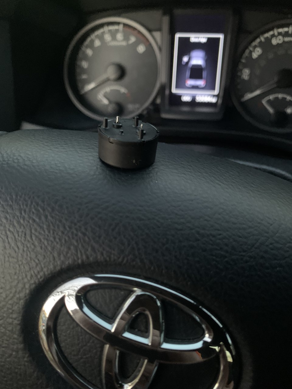

    #194699
    5,708
    Imposter
    By breaking off the speaker thing on the cluster?

    Neatly cutting it off, but yeah.

    Ant regrets? I’m probably doing that next time I remove the cluster or am bored. Haha

    I was a bit worried about losing the turn signal chime, but even that was a pleasant surprise. Sitting at stoplights, I found that I was not feeling frustrated at the longer ones with chime being gone. Just wonderful silence. There's enough indicator lights on the dash. Haha!
    I have found that I have left my turn signal on just one time after a lane change. That's about par for the course for me. Of course, it was when a friend was following me, so I got a radio call about it.
    The silly thing is that most folks forget their signal was left on when driving down a highway. Anything over about 45mph, the tone is pretty much inaudible anyway.
    So yeah, zero regrets. :D

    Nice. Mine is coming off this weekend then! I was also worried about the turn signal thing. But after thinking that I’ve noticed that at long lights I’ll turn my signal off because I get sick of hearing it.
    For signaling I just do the bump and get over. No leaving on. But like you said, above 45 you aren’t hearing that thing anyway.

    Bye bye little buddy. Took about 15 minutes including putting tools away. It’s glorious. Had the door open and turned turned on the truck to make sure the dash still worked before I put it back together. Turned off to put it all back together. No more beeping with the door open!! Signals are a bit weird with no sound. But worth it.

    The signals take a minute to get used to. In the end, a very small price to pay.

    One thing to keep in mind since you like the drivers aids - from that link @tonered posted it might also remove the lane departure tone. I’m a peasant with a 2016 so I don’t have any of those fancy features to confirm.

    Yup. All tones, chimes, and bongs for the interior would be gone. All visual indicators are unaffected.
