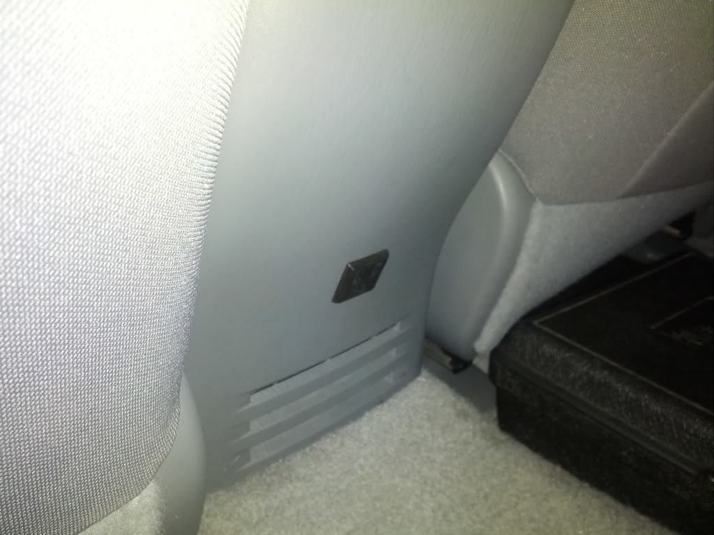

    I added a second outlet inside the cab using the same inverter and switch. I also installed a 12v outlet just above that after this picture was taken though.
    This has been useful for charging a laptop or camera battery while driving. I've also plugged in a glade home air freshener :D

    Nice, is there a write up on this? I was just contemplating on how I was going to hook up kids video monitors for the trip to obx. I have an inverter from my old truck that I was going to use til I saw this.

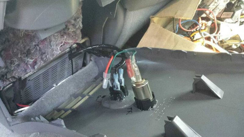

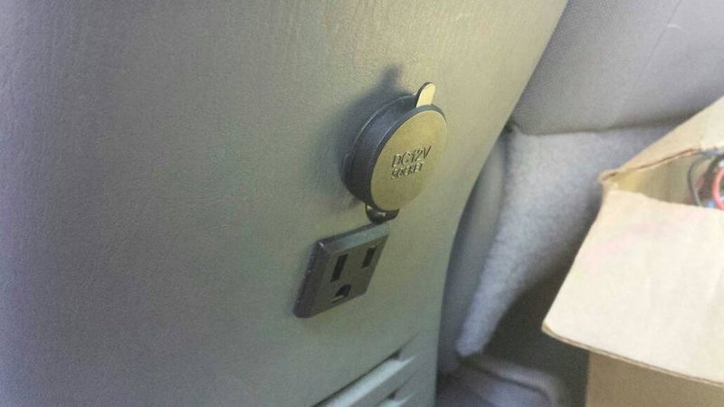

    Its really really easy and cheap. Hardest part is removing the center console (which isn't hard) and cutting a perfect square to fit the plug. The plugs are like 2 for $5 on eBay. Come from china so they take like 3 weeks but they are perfect!
    No writeup that I know of but I can help. Its only 3 wires that go from the plug to the inverter like 6" away. Need some connectors and hot glue for good measure.
    If you want a 12v outlet back there I recommend doing it at the same time.
    Here are some updated pictures...
    uploadfromtaptalk1376174552388.jpguploadfromtaptalk1376174736042.jpguploadfromtaptalk1376174632388.jpg
