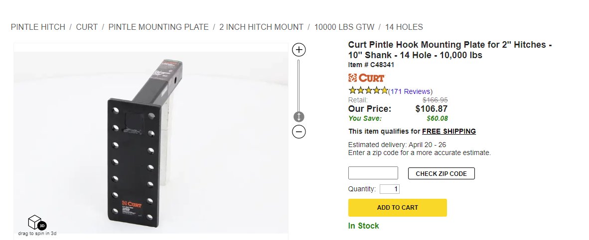

    If you are shopping around you can measure from level ground to the bottom of the ball on your Tacoma to get an idea of where you are at with your current setup. From your pics it looks like you are at +/- 18.5 inches. When walking around lots shopping, have the sales person level out the trailer and then measure to the top of the coupler. That height + or - a small margin is where you will need to be with your hitch. Nice pintle by the way - I had one like it but I mounted mine to a mounting plate with multiple positions for this very use case.

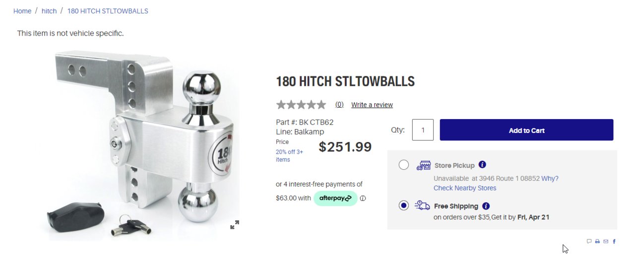

    I have one of these 180 Hitch Stltowballs on my dually and it works well since I have a 2-5/16 box trailer and a 2 in horse trailer so I just flip them back and forth on the dually. You already paid good money for the pintle though so I would just go with a multi-position pintle mounting plate.
