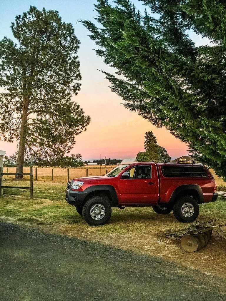

    Haha! The top one is. The red one is just what I would like it to end up looking like, minus an inch or so. It’ll happen soon. It’ll just be black, not red.

    Who makes this camper shell it fits perfectly. Mine is supposedly for a reg cab but still looks too curved near the cab

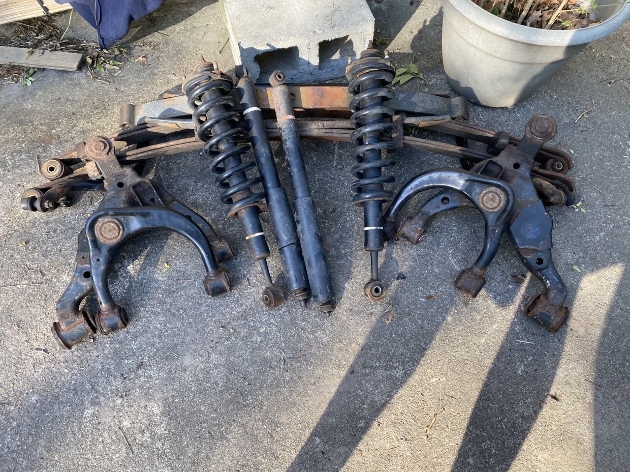

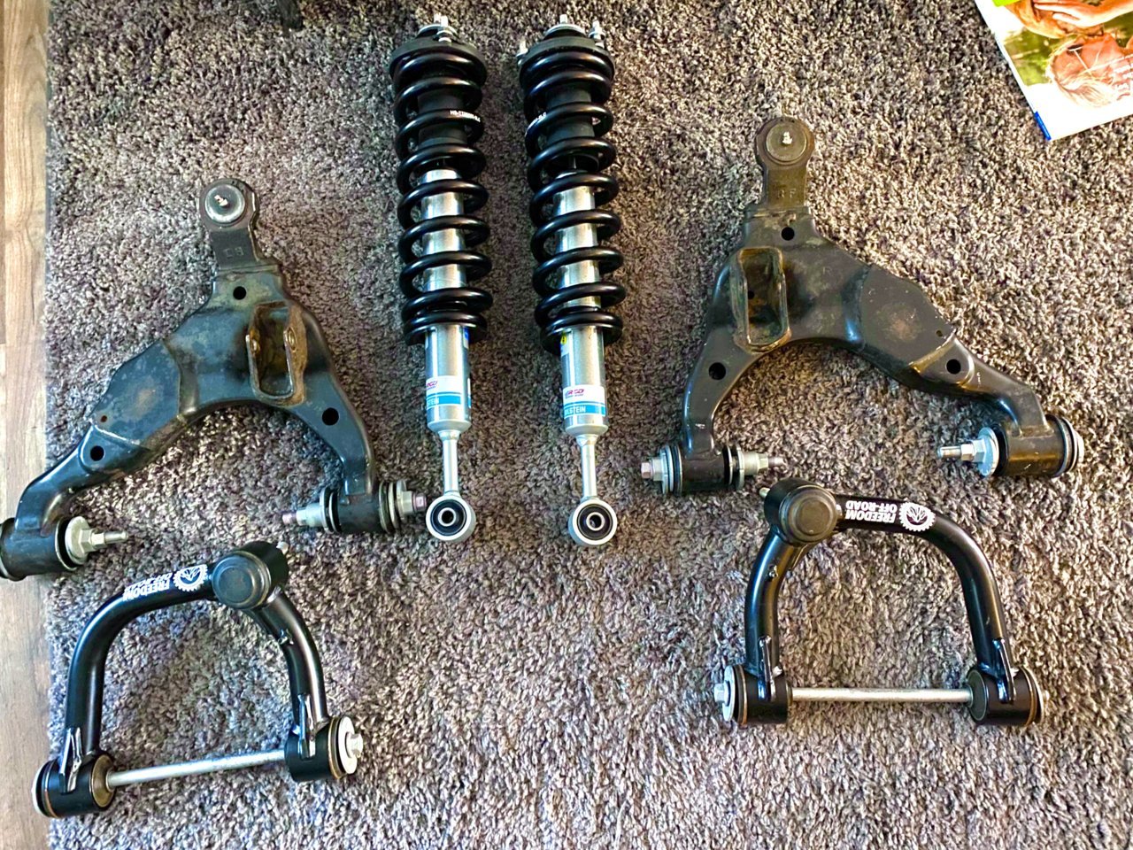

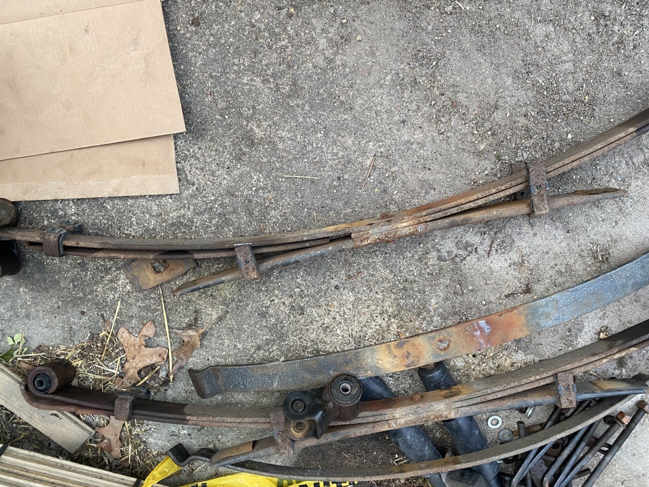

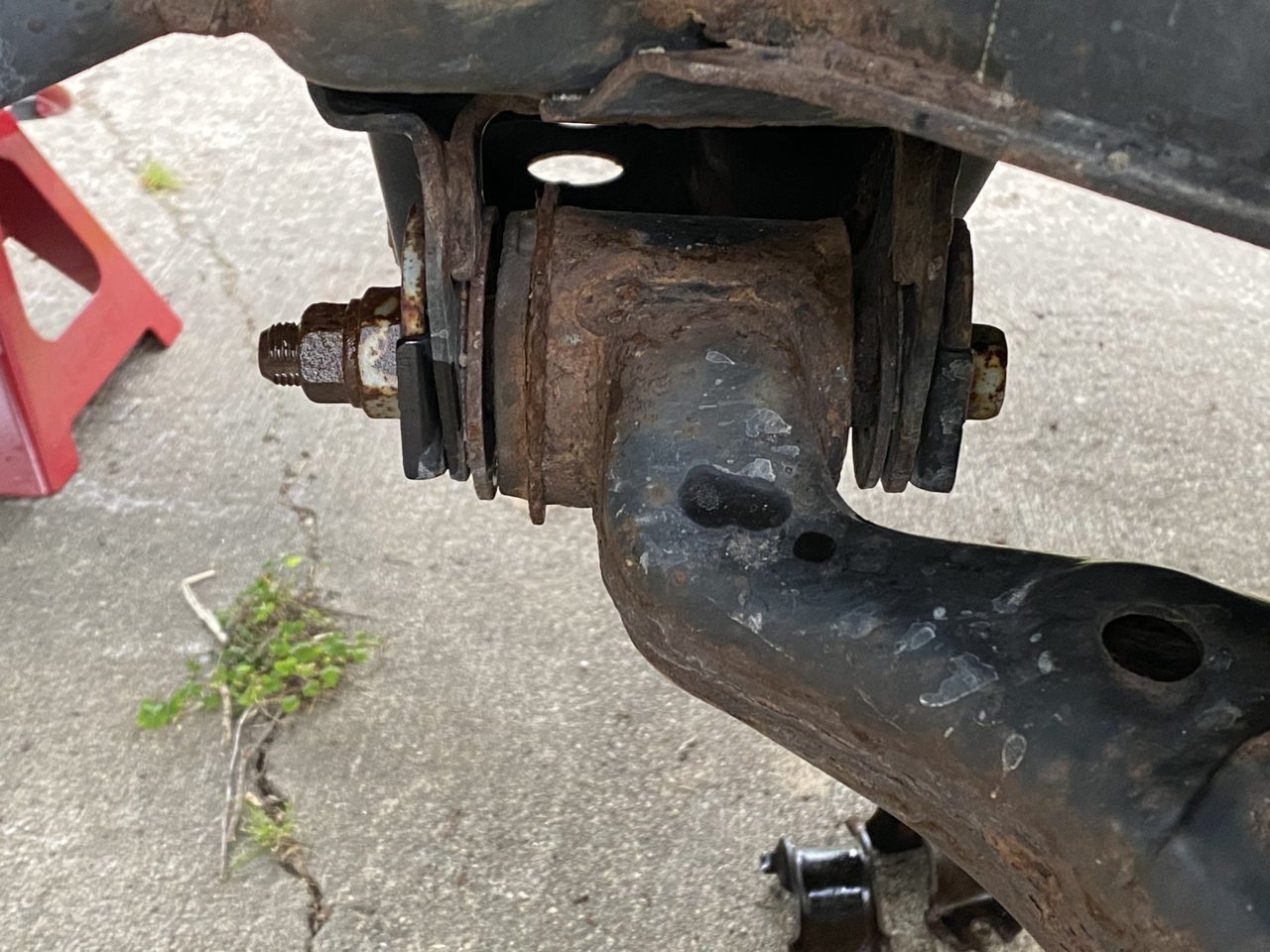

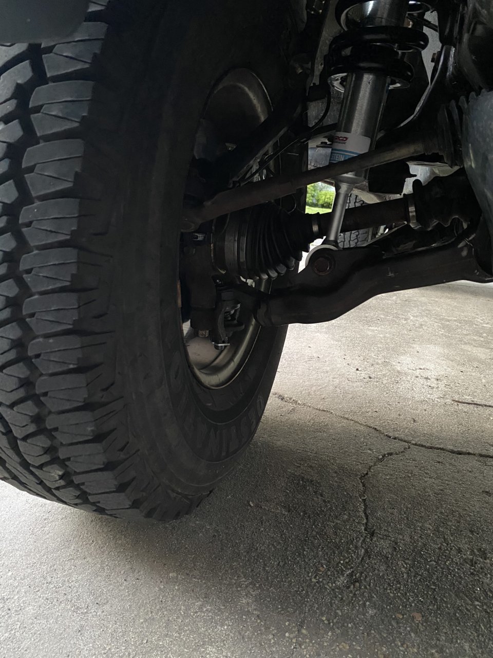

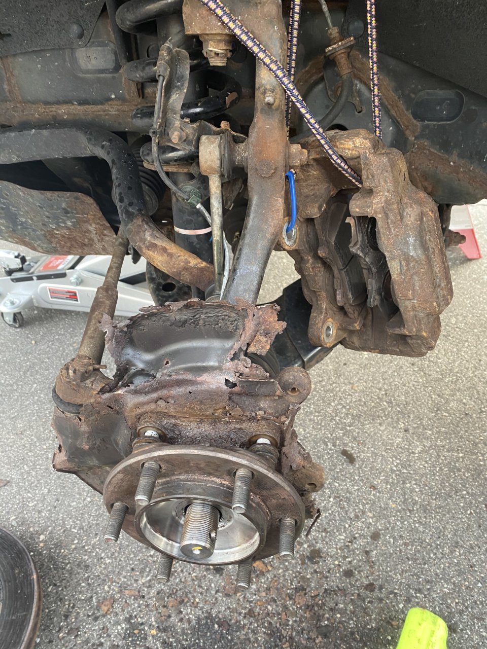

    Out with the old, in with the new. I hope I don't have to do that again anytime soon.... 0BB467DA-AC2A-4FAF-AEA5-979EAFA37AA8.jpgF8D2F9CD-30F7-4BCD-9381-B6726BBDB347.jpg B13EE642-FBF7-44F8-AC6F-2DB3B1AA034E.jpg8025A03E-A9FF-455E-89FE-716E3927E8FC.jpg 3D9C4E73-67F9-4F0E-AAA1-689AD40A952F.jpg2E0A2EEF-5D3D-4986-BA89-58AD8C4997E4.jpg 0F98A375-E190-445A-BE63-2DECE1B2F92D.jpg

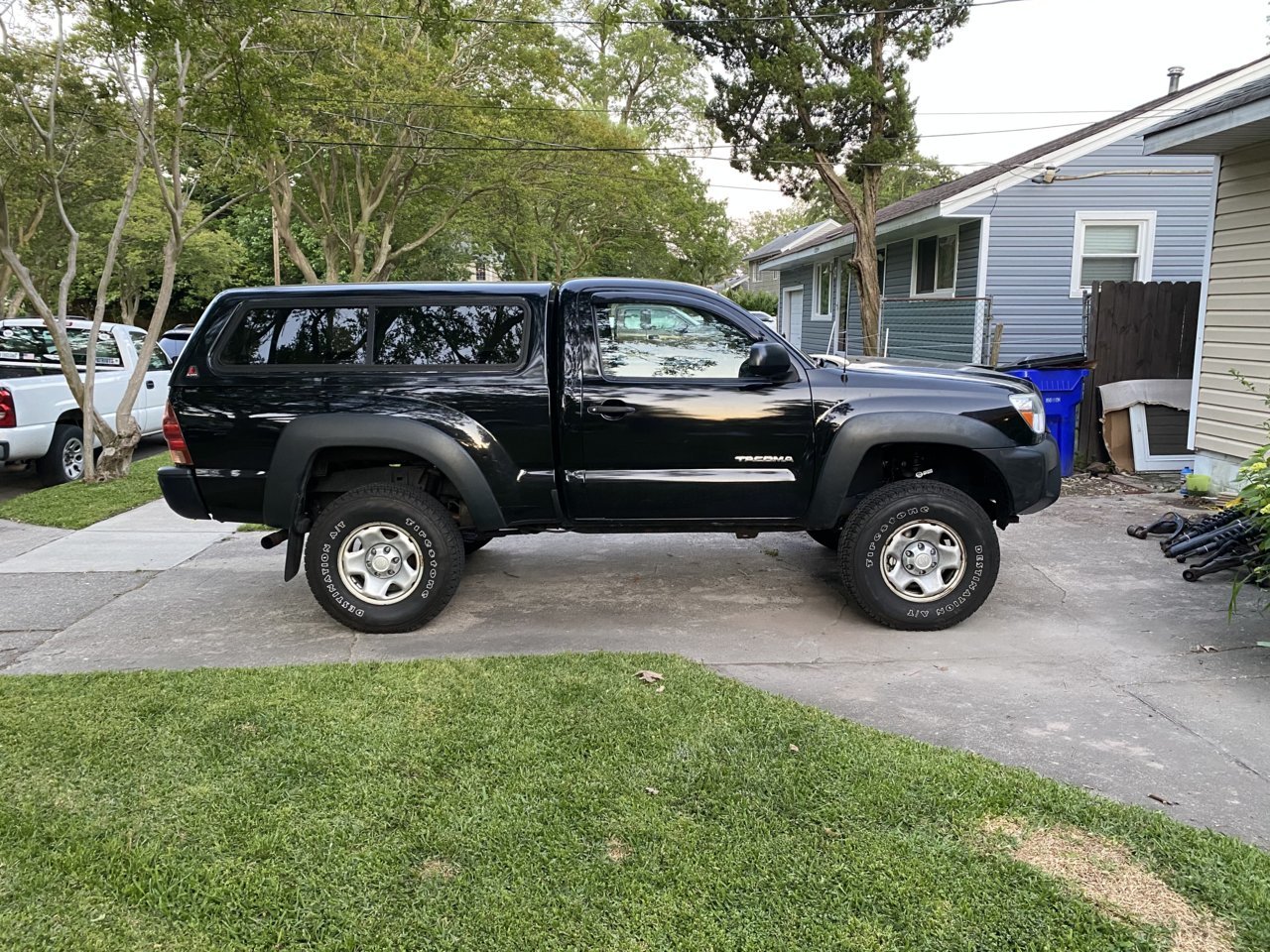

    161
    2012 Single Cab
    How does it ride? Also, is it a true 2"? Looks like more due to the low weight of the single cab and the fact that they haven't settled.

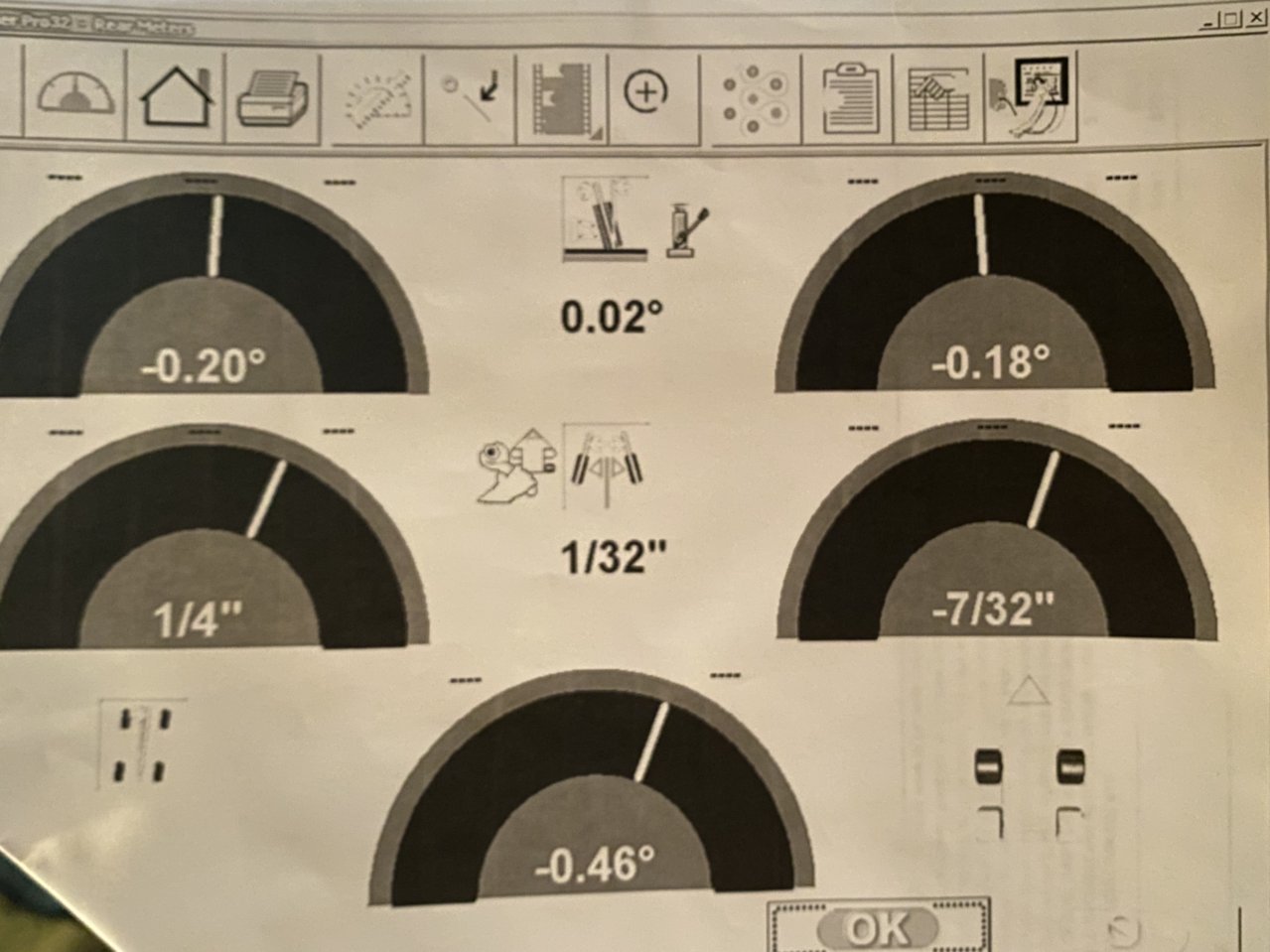

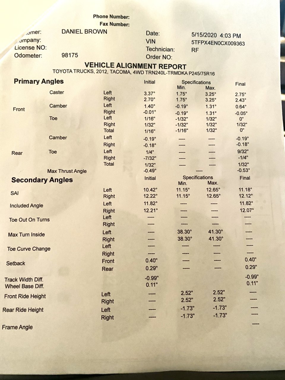

    It rides amazing actually. I was worried about how stiff it would be, but it’s pretty close to a stock ride, but just better. Kind of hard to explain. It definitely went up more than 2” I’m assuming because it’s the 4 cylinder, but I didn’t actually measure anything before and after. I just got an alignment and I guess I didn’t square the rear axle properly. Now that I look at it, the whole axle seems shifted towards the passenger side a smidge. I’ll post a pic of the alignment paperwork. Any advice would be much appreciated.
    84314358-B150-4833-A03A-06160E94A6CC.jpg E7EC79BC-F802-46A8-BB10-968151764EED.jpg

    2012 Single Cab
    Awesome! Thanks, I couldn't find any info on the spring rate on those coils, I know most aftermarket coils are made for more weight than the 4cyl. I don't know about the alignment but I'm sure someone else will!
