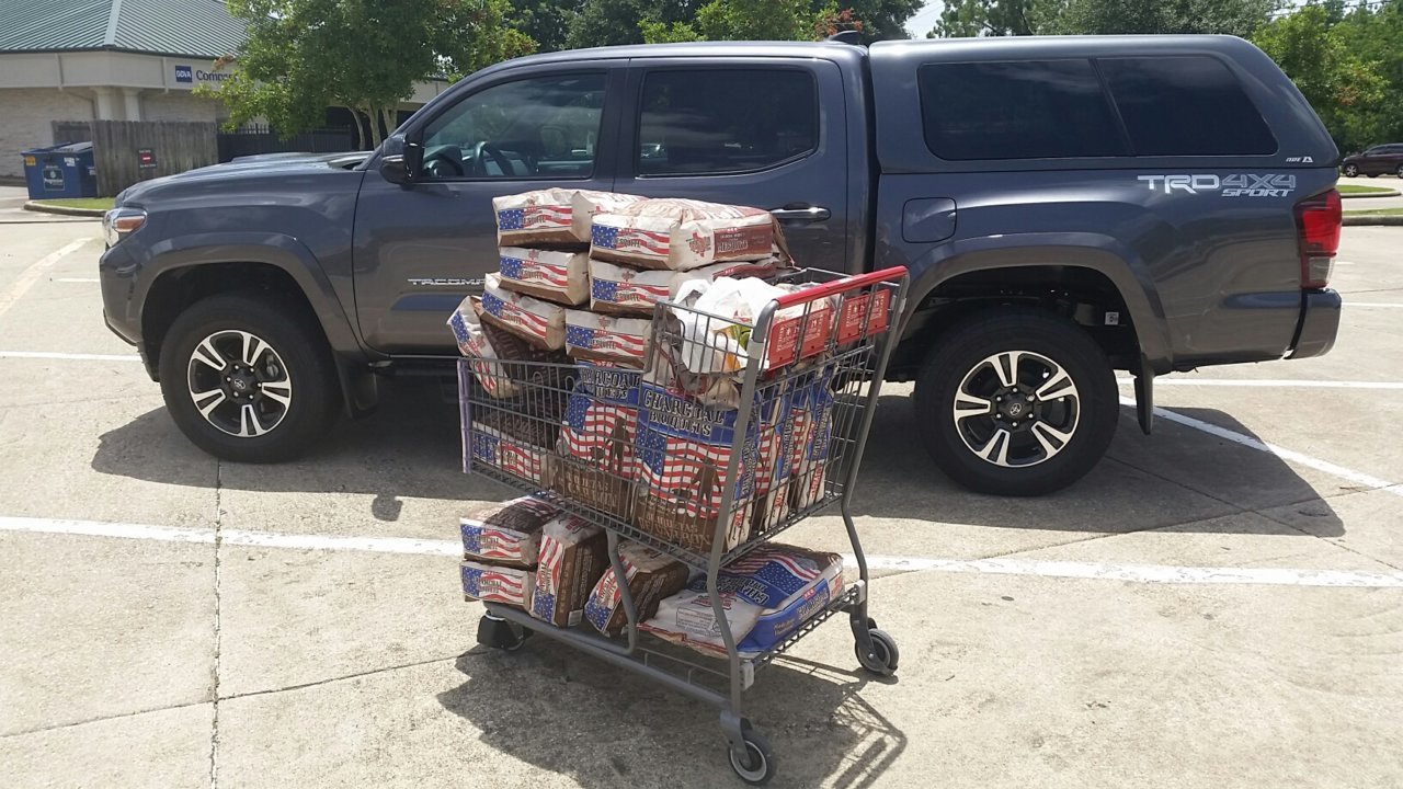

    ARE cap here. Bed stiffeners for peace of mind. I went with Firestone airbags. SO NICE to be able to load it up and with a couple of quick puffs of air you can set the ride height at any rake you want. Those two things are all that 95% of the people on here with bed caps will ever really need. I aired it up ten months ago to level it out. No discernable change in height/rake since then. Install. Forget. Enjoy.
    20190701 - Driver's side quartering forward, charcoal's on sale at HEB for $3.98, big bag 2.jpg

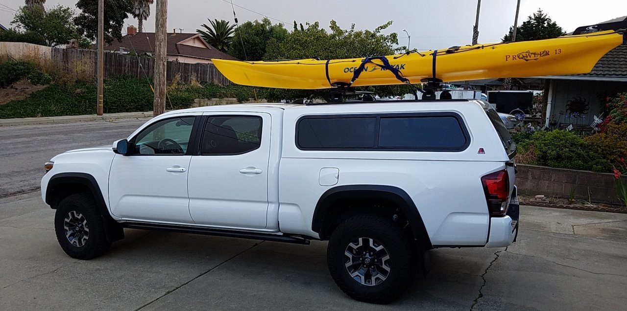

    AAL...camping gear and kayak
