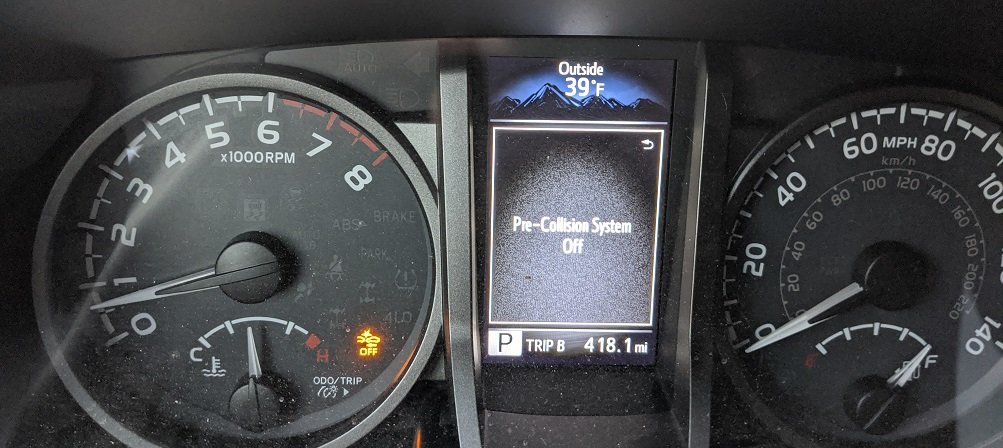

    Report: What happens when you unplug your safety sensor
    First, yes, I need to clean my dash. Glare makes it look worst than it is. This is just about the PCS. The LDS can be turned off at any time via the settings and will not produce an annoying icon.
    Case 1: Just turn off PCS via settings
    In this case, the PCS Off icon appears and stays on constantly. You get a nag screen but you can move away from it. Every time you restart the vehicle, you will have to turn it off again. I could put up with this, but I'd still have to have a functioning, properly aligned sensor in my grill.

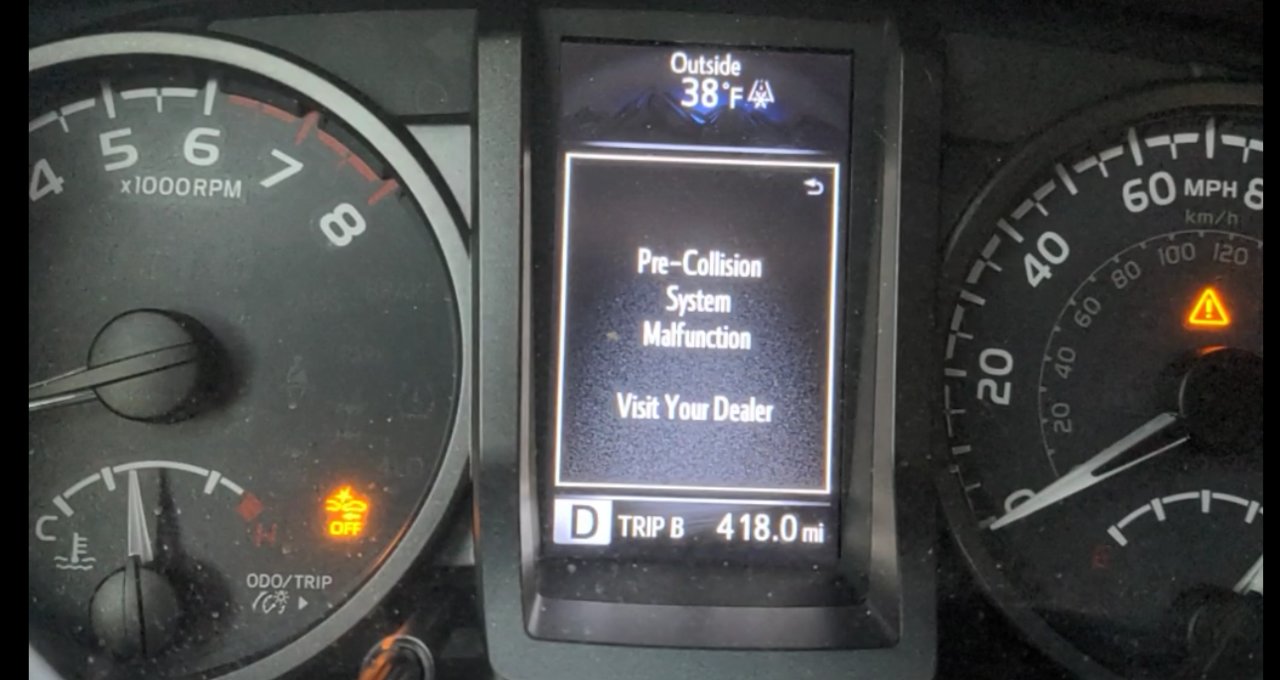

    A trouble light above the Speedometer comes on and stays on constantly. The PCS Off icon will appears and blinks about once a second. You can move away from the nag message in center screen, but it will return in about 30 seconds no matter what screen you move to. With the sensor disconnected, you do not have the option to turn PCS off via the settings. This makes sense since the system cannot detect a functioning sensor.
    I tried this a couple of other ways, disconnecting the sensor after starting and turning PCS off before disconnecting. The results are the same. A blinking PCS, a trouble light and a reoccurring nag screen. I can't imagine driving like this for more than a couple of minutes.
    Conclusion: I'm going to have to find a way to modify my grill to put in a sensor, or sell the new one and buy one that has a sensor slot already installed.
    Thanks for everybody's input.
