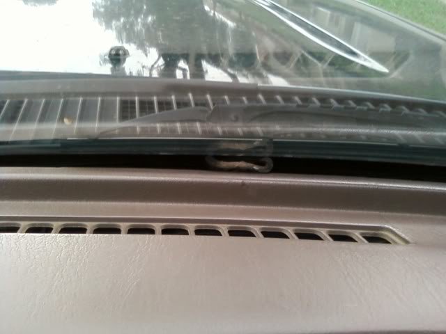

    sure, pics, up by morning,

    That damn dash rattle!! It always seems to get worse when I have someone else in the truck with me and then I have to hear them make comments like "is your truck going to fall apart?" or "your truck is really noisy". Yeah thanks, I didn't F-ing notice!!
    I've thought about doing this too. Good to hear that it fixed the issue :)

    There's lots of methods that people have came up with to fix or temporarily fix the issue, some methods that even dealers came up with, like stuffing rubber gloves or rags. :laugh:
    Here's the proper way to fix it (supposedly)
    http://www.parksoffroad.com/tacomamods/tsb/dashrattle/dashrattle.htm

    idk the small peices of rubber hoses, by the glass works, thanks to my dad and his tacoma rattle aswell

    Donahoe CO, Donahoe Rear Resi, Deaver J59, 16" Pro Comp, 33" BFG AT, Hayden Trans Oil Cooler, Oil Filter Relocator, FM 40, ES Bushings, Beefed CB Drop, Deckplate, K&N Drop-In, DO Bed Bar, Cobra 75 WXST, Firestik Firefly, Philips D1R, Clarion Remote Start, Husky Liners
    Where do you put them exactly, literally between the windshield & the dash? Are they visible? I've been meaning to fix mine, probably not up for doing all that work listed in the TSB, but I don't want anything visible from the top of the dash.

    no if you cut them small enough you cant see them,
    heres the pic
