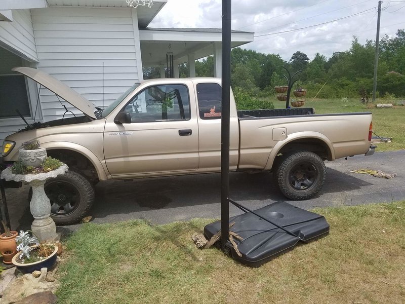

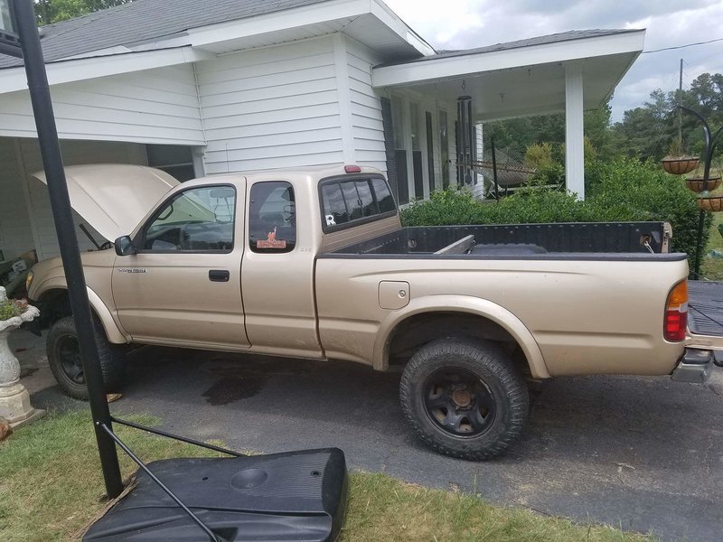

    Photos of truck:

    They seem to bring different prices in different parts of the country, I think they fetch the most out in the south west. You are sort of getting a pig in a poke as far as the engine is concerned, Looks like a descent truck, need to check the frame out, find out prices in your area, maybe on line at car dealers or maybe Kelly's blue book, then deduct a big part of what a engine rebuild or replacement would cost from price of what a good running one would cost.
