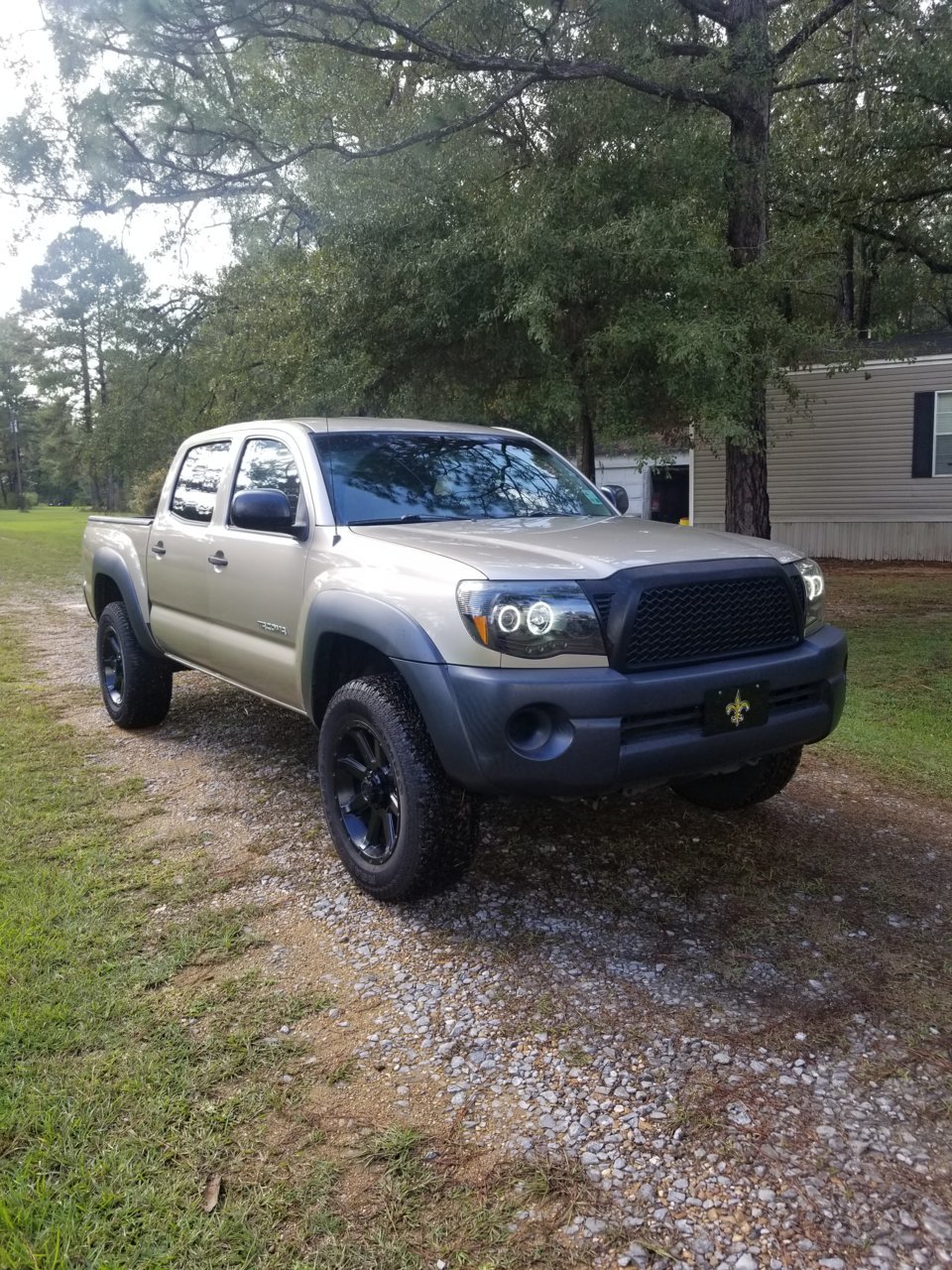

    2008 Desert Sand Mica Tacoma Prerunner DCSB
    18 inch Black rims with 265/65/18 AT tires. Bilstein 5100 shocks. Black Halo Headlights and Black LED taillights. Window Tint. Black Aftermarket Grille.
    I have an 08 prerunner. I put bilstein 5100s all around and set the fronts at .85. I then put some black 18 inch ultra crusher rims with -10 backspacing and some 265/65/18 A/T tires. I think it gives my truck a nice stance and ride. It cost me around $1700 for everything.

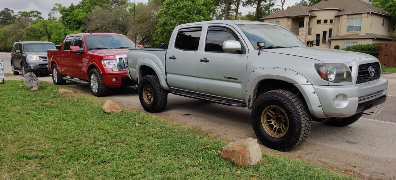

    Bilstein 5100 Struts Fox 2.0 Shocks 33x12.50r18 Yokohama M/T ICON Uppers Fuel Mavericks S&B CAI 32" LED Auxbeam with Cali-Raised Flush Mount Pedal Commander & Ultra Gauge
    No strut spacers, they ruined my Pro-Comp Pro Runner Struts within a year LOL
    Trust me, you'll avoid bad ride quality and problems down the line such as blown struts and them hockey pucks don't really look that pretty.
    I have Bilstein 5100's thats giving me 2.5" up front and a 1" in the rear. Rear Blocks are budget friendly and have worked for me. Personally I think its pretty level, but don't worry about any front or rear "rake" because most of the time I park, the ground is never even enough for me to notice any "raking" at all. However, I DID notice that 2" in the rear does show a noticeable rear rake.
    If you want actual 3" lift then maybe the Toytec 3" Coilover (not as budget but seems solid) or new Rough Country 3" Coilover (cheaper but idk much about it).
    If you want something bigger like a 4" lift, Rn I'm actually looking into the Maxtrac 4" Spindle Lift for 2WD's. It allows for a the lift of a 2WD truck with cutting into your frame.
    Budget Wheels and Tires can be found at your local Discount Tire. I see people running their stuff all the time.
    Although I got 18's, I found 17" rims and tire combo's to be cheaper and have a bigger variety.

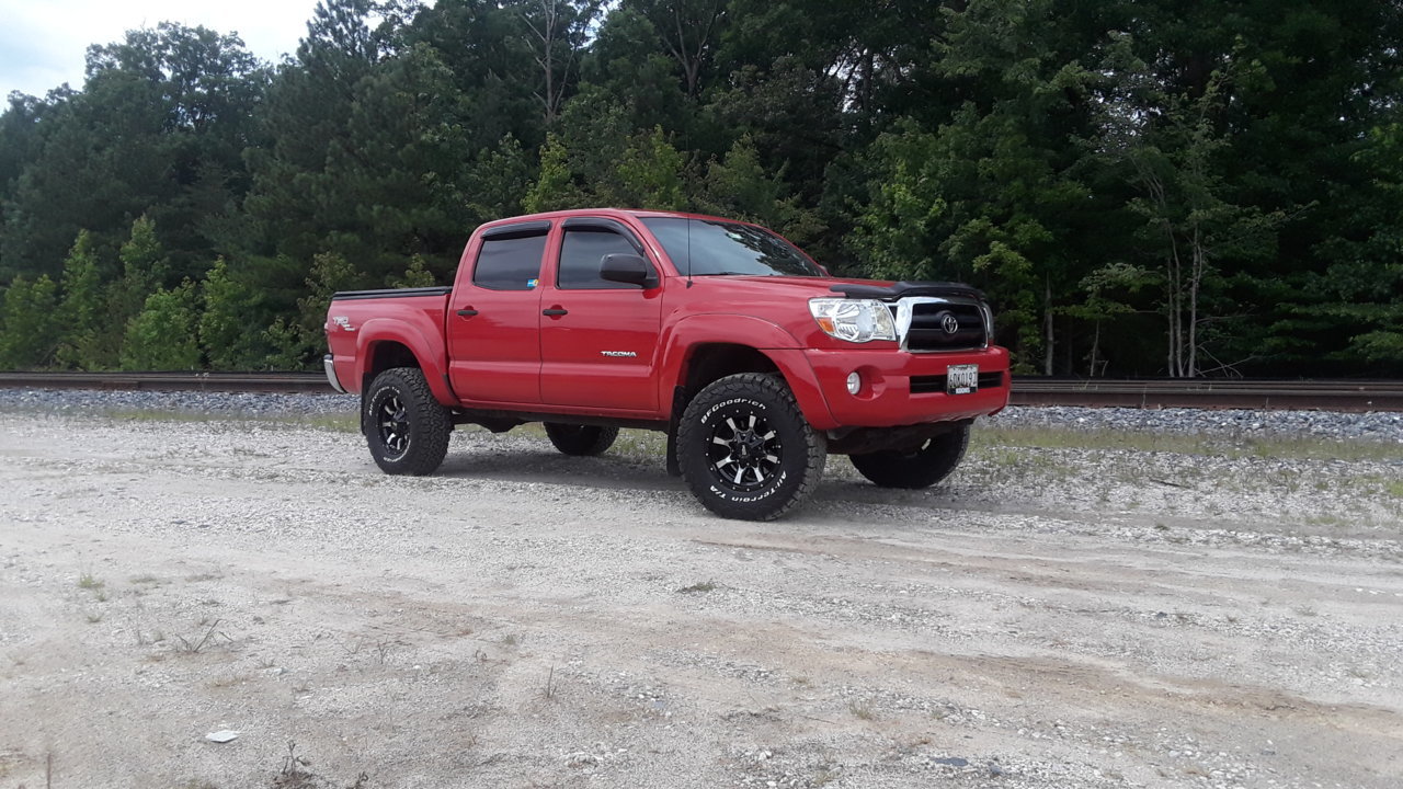

    3in lift, 5100s front and rear, OME 887 springs 2in aal, 285 75 16 Duratracs, mb 352 black wheels, white sport grill, derp'd lower valance, derp'd front toyota emblem white, tinted windows, tinted tail lights, trd shorty antenna, trd hitch cover, trd valve stem caps, trd neoprene covers, trd all weather floor mats, kenwood double din, stampede window visors, flyzeye interior leds, anytime fog light mod, flashlight mod, kool vue intake, LED dome light, Lund bug shield, TRD shift knob,front mud flaps removed, Debadged, truxedo roll up bed cover, led fog light bulbs, led parking light bulbs, led dtrls bulbs, led headlight bulbs, led back up light bulbs, led license plate bulbs, tinted license plate covers, 18" magnaflow muffler, 32in ebay, light bar, coverking neoprene resr seat cover, oem trd skid plate, trd decal on center caps, oem trd exhaust tip, blacked out pinch welds, color matched mirror covers.
    Mb wheels are on the cheaper side. Tires are always expensive but discount was having a sale. Spacer lift up front to level it out is the cheapest route.
