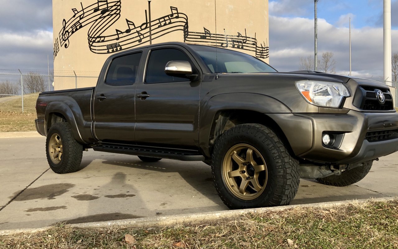

    23AA13A1-59BC-432F-937C-699A8CA4CC7C.jpg FN Wheels Konig Countersteer Off-Road 16x8
    18lbs each.
    Did wonders for my barely 100hp little 22R-E 4cyl.

    Granted these are 17" wheels, but my FN Wheels (Konig) Six Shooters are right around 20lbs if I remember right. I noticed a little bit of difference compared to the stock alloys that are the 5 spokes (I think they are about 26-28lbs). Tires were the same, just swapped from stock wheel to the FN's. You may benefit going to a 17" wheel as well if you compare weights of wheel/tire combo. I believe the lightest wheels that work on the tacoma are Volk TE37's......but they are like $600 per wheel if you can find them.
    You can also look into tires as well. There can be a considerable amount weight lost in the tires as well. tiresize.com has most tires, sizes and weights for the specific tire/size.
