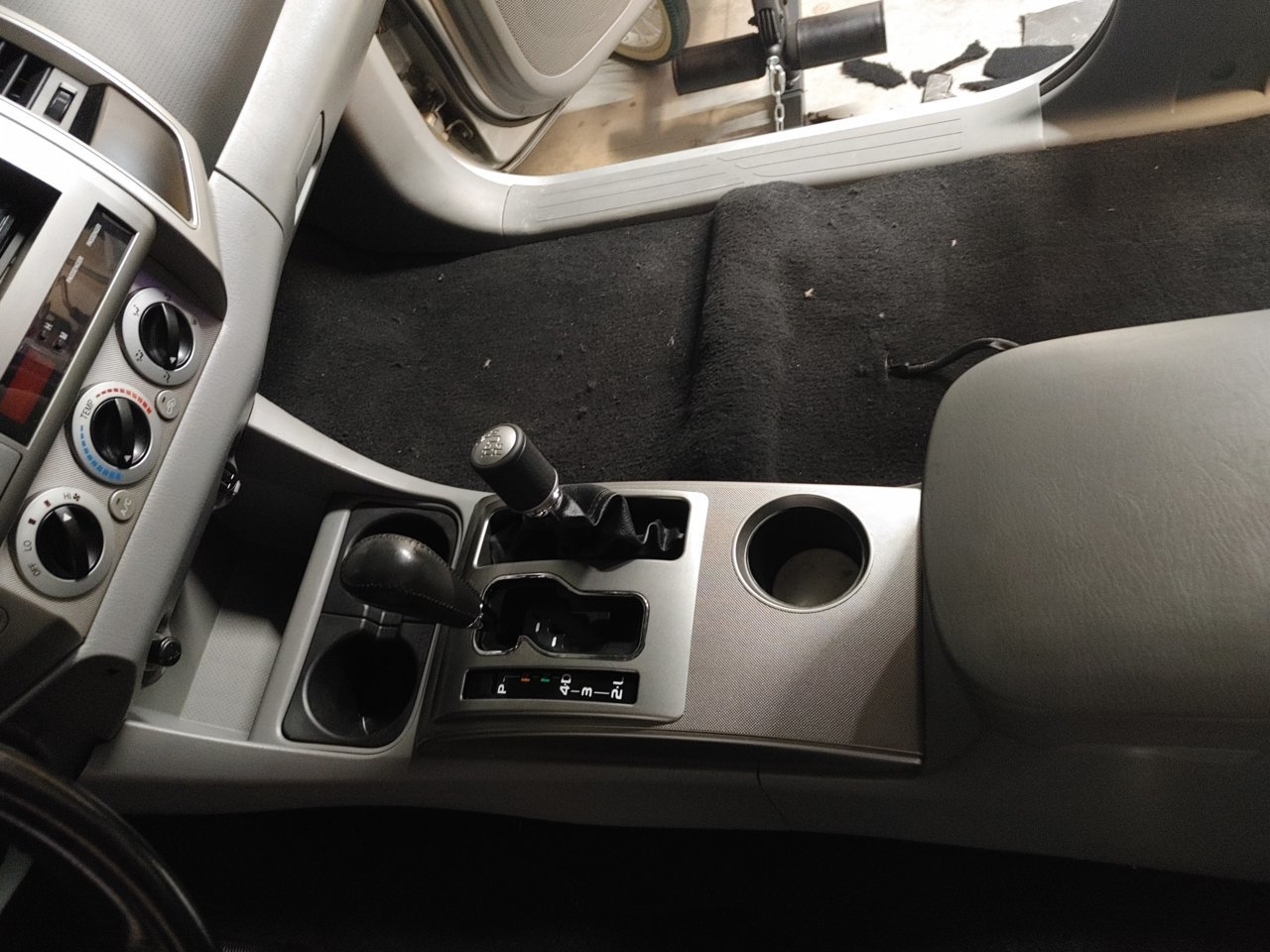

    If you have the mechanical inclination and the facility and tools to do so, then absolutely.
    My truck as a prerunner with over 200k was worth about 10k, and a 4x4 model comprable to mine was worth near 20k. Even if I traded in I would still be deep in the hole. It is not cheaper to "just buy a 4x4" if you know what your doing.
    The prerunner and 4x4 frames are identical with the exception of the transmission crossmember. Which can be easily modified or replaced.
    That being said my truck is mechanical 4x4 now, I have a fj cruiser transfer case, and a momentary switch for my front diff actuator. I have no 4x4 module or anything like that.
