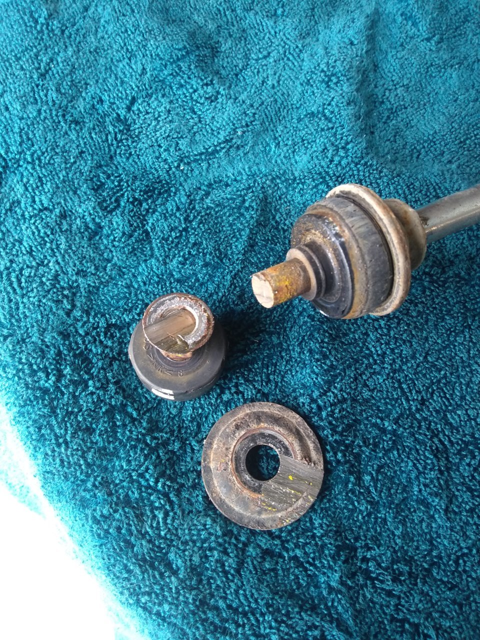

    Thanks for all the replies. Some useful, some not. I used a sawzall and it was 10 times easier than a cutoff wheel. New shocks installed. Here is a picture of the old shock and cutoff nut.
