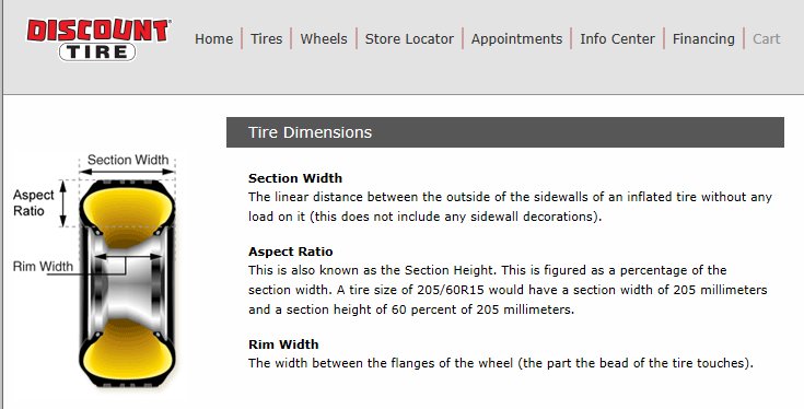

    I was under the impression that 265 was the width of the tire and 70 was the height of the sidewall. Is this incorrect?

    265 is the width, you are correct

    What in the fuck....
    Dude...please tell me you're trolling?
    Seriously, you're calling @Aussiek2000 out like he's an idiot? Dude he knows more than you. Seriously wtf?
    A quick google search would educate you so much on how fuckin wrong you are. 265 etc is the width in mm, 70 is the ratio for sidewall height...like seriously wtf.
    use the tire calculator on here it will even tell you that.
    https://www.tacomaworld.com/tirecalc
    No, you are correct.

    You'd be correct. A/B/C
    Where A is the width of the tire (265), B is the percentage of the width in the I believe radius? (70) and C is the wheel size.
    Edit: or look at what @Joe23 said above me, that's what I was getting at
