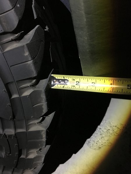

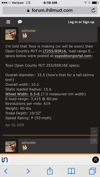

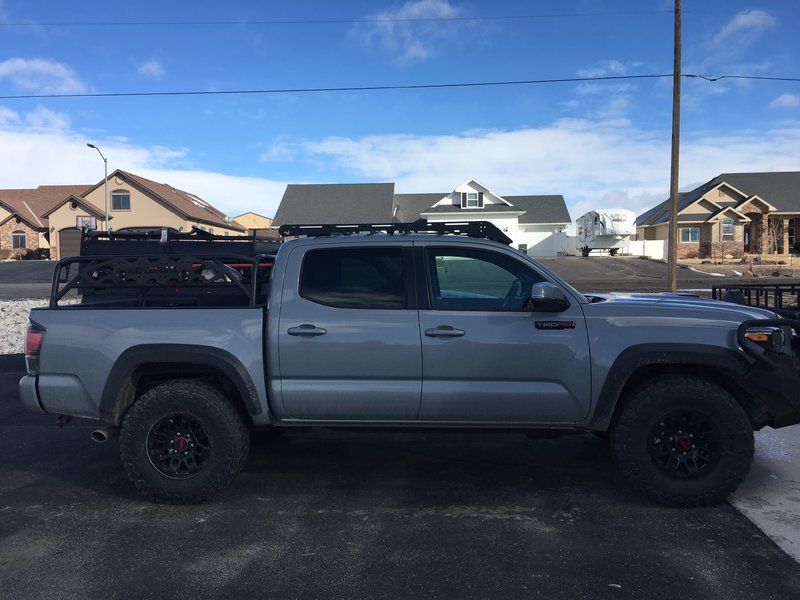

    IMG_1842.jpg IMG_1797.jpg IMG_1767.jpg 255/85/16 on stock pro rims. Just got them but will have to do some trimming on plastic where mud flaps mount. Haven't had time to off-road it but two weeks of driving it it around town and no rubbing even while turning steering wheel all the way. Toyo mts so their the tallest of the 255'S.

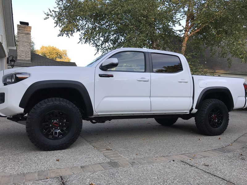

    285/70/17.. Had to trim behind the front wheels. I used a heat gun to remold the front of the fender liners.
