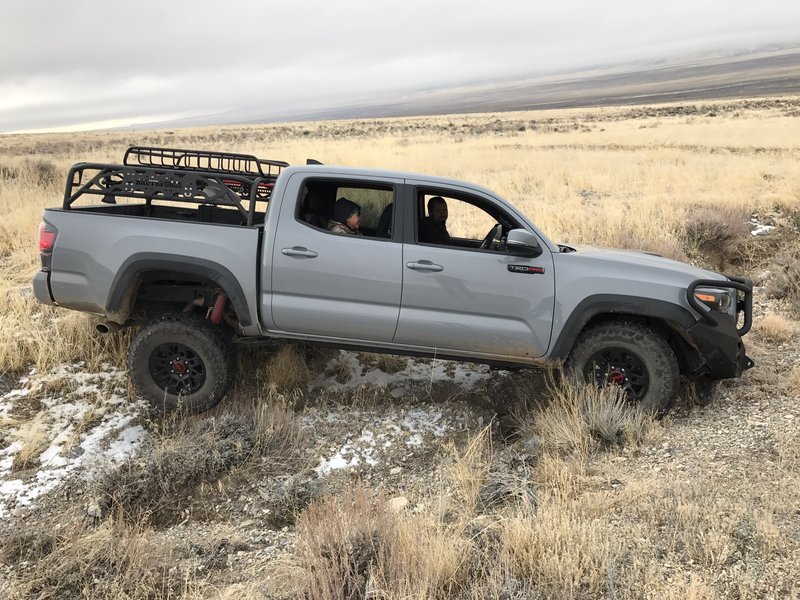

    0047832D-57BB-4AD6-BFC5-8CC1C1303AD9.jpg Definitely no rubbing even while off-roading. I had toyo mt's 265/75/16 before I upgraded to 255/85/16. You will be fine.

    265/75R16 is almost 32 inches. 255/85R16 is like 33 inches but too skinny. Did you do any modification to stock trd pro for both of them to fit.
    Why did you dump 265/75R16 for 255/85R16? Just curious.

    Look back at #53 post I put a size chart. 255's in the toyo mts are actually 33.5" so that's why I went with them for the extra clearance. I put 265's back on my 97 Tacoma. I do have aftermarket bumper so plenty of clearance on front. 265's there is no issue rubbing at all no modifications. The 255's how ever I still haven't taken it off-road and flexed suspension to see where to trim looks like just plastic though. And remember toyos run the tallest of the 255's everything else runs right at 33 or smaller.

    Thank you for taking the time and answering my questions. I now can see your front bumper and that is why you can fit such large tires without much rubbing. I think the best compromise would be 265/75R16 which is close to 32".
