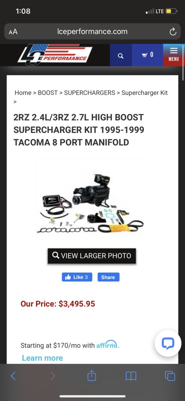

    I don’t think they offer superchargers for 4cyl? Gonna turbo mine unless they make superchargers

    Could be wrong, but if you don't fab your OWN supercharger setup (possible) I think Toyota makes one that is a bolt-on?
    There is a local fellow fabbing a blower up for his 2.4 liter. If his works, I may fab one. I am less of a turbo fan. I have tube headers
    a turbo would delete.

    quite the penny tho. If you got time do this lol

    I would go low boost so you don’t have to do any piggy back shit

    4 or 5 psi. No intercooler.

    A supercharger or turbo will not fix your fuel economy issue. Either will increase the power, but the cost of the power is burning fuel.
