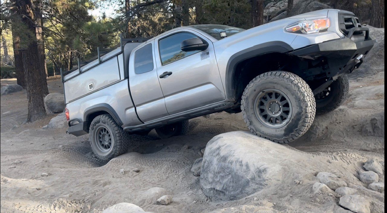

    I will be doing the Rubicon in a few weeks. I have my Tacoma about as ready as I think I can get it. Last bit of the full skids were finally done this weekend. Only armor I am lacking is on the rear spring hangers. I wont get to that and have debated flipping them. I am really trying to figure out what spares I should bring at this point. The only thing I really have so far, and think I need from what I have read, is a spare CV axle. I will go as light and easy on the throttle as possible and main plan is to get out clean so I can drive back home. Please advise if you have any experience with spares to bring on a trip like this. Thanks.

    can we get a pic of your rig?

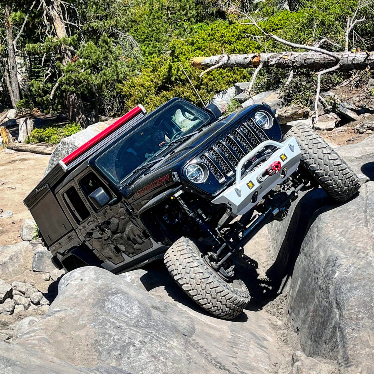

    ive run it in my taco and gladiator. Ive run it four times this summer in my gladiator. You should carry a spare CV and inner tierod. Have fun and be light on the throttle. Id stay out of little sluice and take the bypass if its your first time. The trail is long and its very hard for low clearance long rigs.
    Me driving up soup bowl.

    Thanks for that bit of advice. I will add the tie rod to the CV axle. I do plan to be as easy as possible and will by-pass where ever I can. At least on this trip. Armor is heavy, so I am optimistic.

    yep. thats little sluice. Its more torn up right now then it was then.

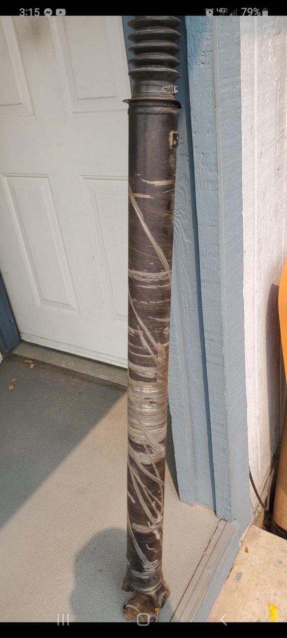

    All of them.
    A driveshaft. Mine after a solo Rubicon trip Screenshot_20220209-151516_Photos.jpg
