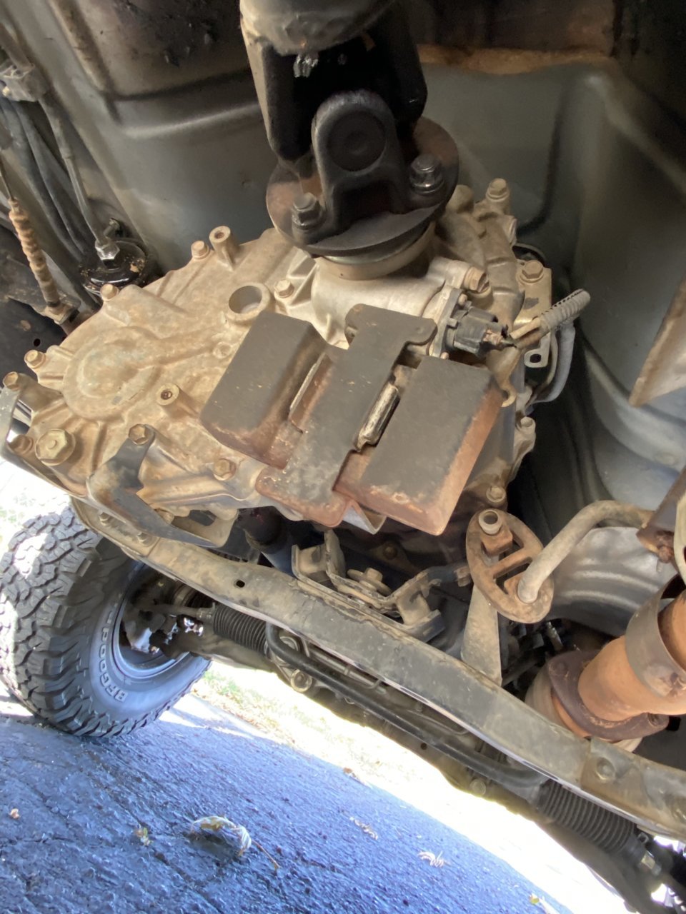

What is hanging off my Transfer Case?

    I originally posted this one month into owning my truck. Now that I know a whole lot more about 1st gens I'll add a few comments:
    Yes, I have the pushbutton 4wd, called the "2-4 switch" in the service manual. The electronic actuator engages the front driveshaft when you either press the 4WD button (when the stick is on 2 wheel drive HI) or when you shift the stick to 4LO.

    I’m in the Toyota t.ten program working on becoming a master tech. And they put these on mainly 3rd gen 4runners and many first gen Tacoma’s that have an over specification vibration while testing in the factory. Many 4runners are just equipped with them do too it being a more family luxury suv/truck compared to the Tacoma, who’s driver are more willing to deal with a bit more vibration due to being a “truck owner”. This is straight from a master tech who’s been in the Toyota family since the late 70’s. I’ve been wanting one just for an extra smooth ride. It’ll absorb an extra unwanted harmonic vibrations

    How Important is this and can I just remove it?

    it helps reduce vibration so if you don't need to remove it just leave it alone

    Non of my 3 automatic 4 x 4 trucks have that. Must be for push button 4wd. Mine are all J shifts.

    I have that same thing on my 04 DC. Mine is a J shift 4 wheel drive. So who knows!

    I have a 03 double cab 4x4. Not J shift. I removed it because it got in the way of the transfer case skid. Drove around a bit and noticed no difference. The thing must weigh at least 5lbs.

    You can relocate it like this dude if you want the extra weight back https://www.parksoffroad.com/tacomamods/skidrowskid/skidrowskid.htm
