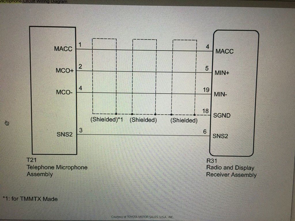

    so theres 4 wires, 3 of them wrapped together? you pulled them out of the connector?
  7. Oct 18, 2016 at 7:49 AM
    #27
    jakebray
    jakebray [OP] Well-Known Member
    Apr 6, 2015
    #152649
    1,045
    jake
    SoCal
    13 PreRunner
    Locked DCLB with Kings and crap
    Four tiny ass wires they go into the connector, pulled the mic off and they popped out of the connector, gunna be a pain in the ass to get back in haha
  8. Oct 18, 2016 at 7:56 AM
    #28
    yesmar
    yesmar Well-Known Member
    May 1, 2013
    #103280
    681
    Ramsey
    Harrisburg, PA
    A couple cars
    ok so this is a wire diagram showing us what you are looking at
    A8774B1C-6473-45EE-8A5E-C9BFEB2CA235_zps_c7bf4253b23dbe6134b8ea58a67a6dcd1a221f9f.jpg

    Ok so you got it figured out?
  13. Oct 18, 2016 at 8:28 AM
    #33
    jakebray
    Apr 6, 2015
    #152649
    1,045
    jake
    SoCal
    13 PreRunner
    Finally yes haha, thanks for your help:thumbsup:
