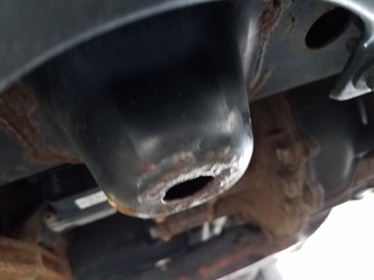

    Ok: I have had my truck since June, got under it to drain the oil and check things out but still no clue as to what this is. It looks like a lot of time and planning went into it for it to just be some whim of the engineers. It's too dark so see up in there and I'm not taking down the pan. ("If it ain't broke..."). Thanks!

    Looks like the bottle jack (tire change) lift point.

    Its in the Owner's Manual.
    That is the lift point under the engine. The rear lift point is the differential. There are also lift points on the frame.

    Using that jack point will result in both front wheels off the ground at the same time.
    You don’t have to move the jack but one time this way. Plus, it gives you plenty of room for jack stands on the frame. I use that location almost exclusively when doing front end work.
    USE JACK STANDS WHEN USING THIS LOCATION. NEVER ALLOW THE JACK TO BE “THE STAND”.

    Thanks guys! I admit it: Never occurred to me that it would be in the Owners manual.
    I'll try and make the next one harder or at least Non "Ahhhhh: DUH" level
    :facepalm:
    (Glad I didn't remove the pan)
