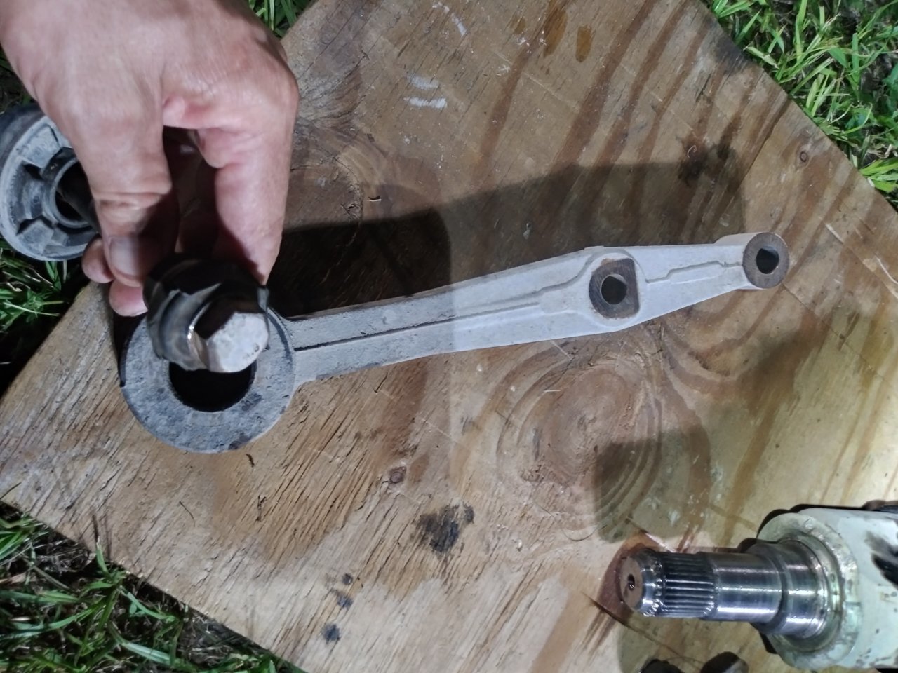

    What is the name of this? It is the member on the passenger side of my front diff. I need some help with the actual name so that I can order one.

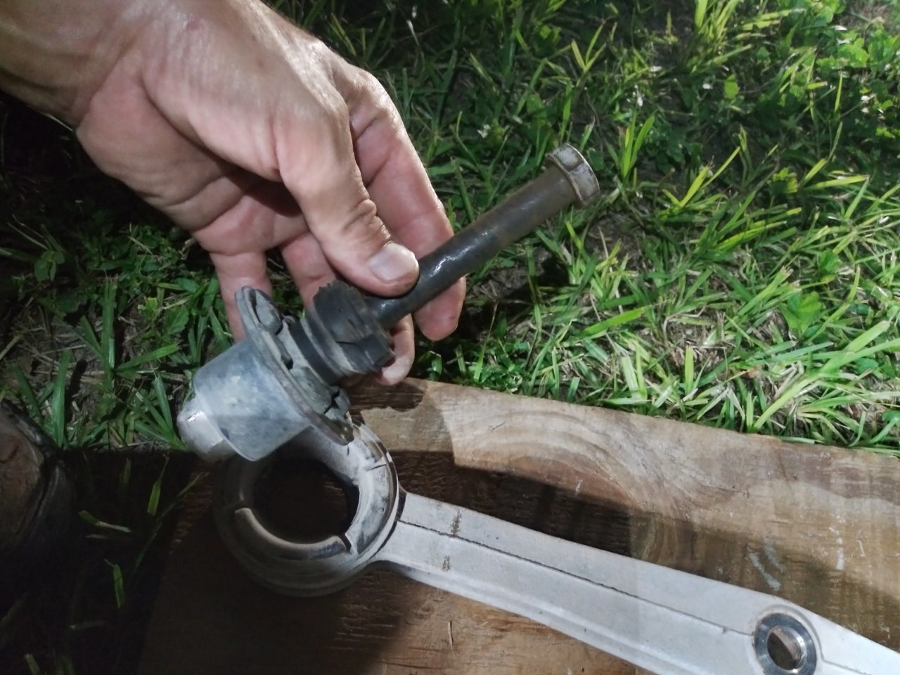

    20190901_222019_HDR.jpg the rubber bushing broke out of the socket Where It Bolts to the frame20190901_215148_HDR.jpg it allow my front differential to twist and broke both of my CV axles

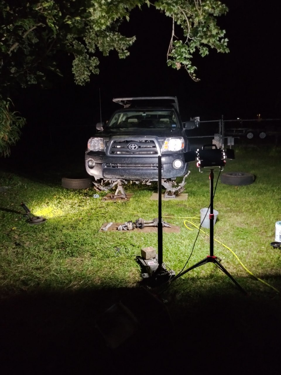

    Anybody know where I can get some Tacoma Parts in Cocoa Beach Florida on Memorial day before hurricane? Hahaha

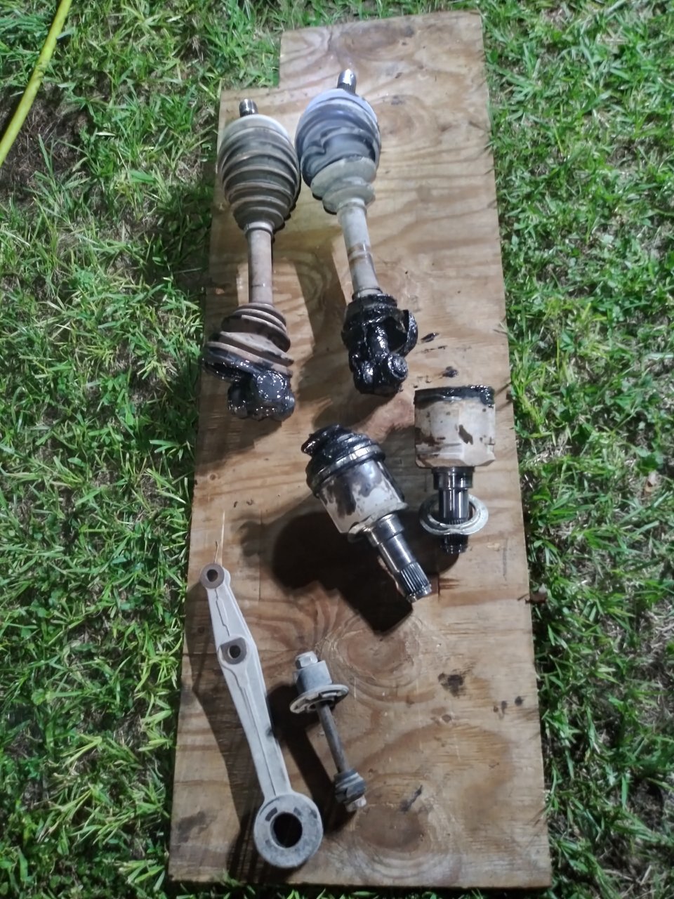

    20190901_222956_HDR.jpg no parts no glory

    YIKES! Looks like you just need the bushings. (insulators) They're not very expensive.
    As for the CV joints, it looks like new boots and grease would take care of that. Not sure about the tin slingers though.
    You've got a hurricane breathing down your neck and you're busy working on your truck? That's hard core.
    Seriously though. Stay safe, man.

    I ordered the insulators waiting on him to come through FedEx from the website link that you posted. I also have my ECG s bushing replacement bearing I think I'm going to go ahead and do that I guess I'm going to buy the removal and install tool maybe since I'm trying to do it with the differential in the truck maybe I'll just pull it.
    Also there is nothing wrong with my needle bearing I just wanted to replace it because I thought it made sense not to have a bearing in there that would fall to pieces in the differential I have both two axles I need my truck to go to work I might just put it back together, gather the tools up, and do it on my next big maintenance item
