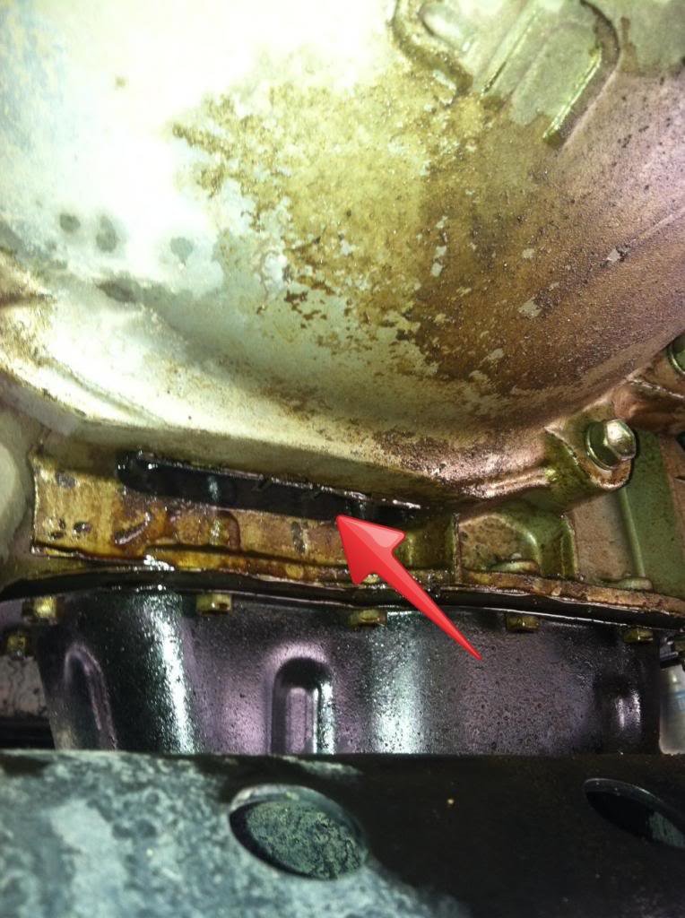

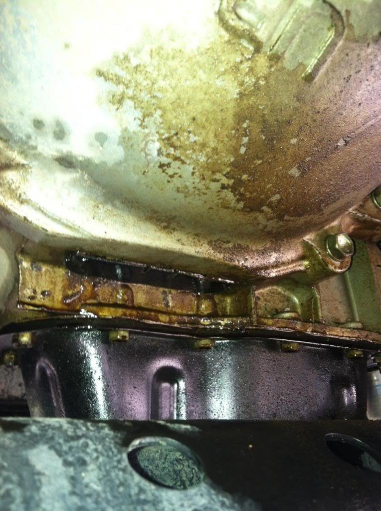

    Can yall please look at this pic and see if yall can tell what is leaking...I just found my truck at work leaking oil:(:mad: this is a pic from behind the oil pan

    2013 NBM AC 4.0 4x4 Auto OR
    main bearing seal

    Pressure wash the area off and see how long it takes to show leakage again, rear main seal leaks are normally slow, looks like it has been leaking for a long time.

    I would clean the entire area and recheck it first. While it is common to have the rear main seal leak, that oil pan gasket looks like it has suffered from over tightening. The leaking oil will blow back while going down the road, and make it LOOK like a rear main seal is leaking. Inspect and verify before you take anything apart.

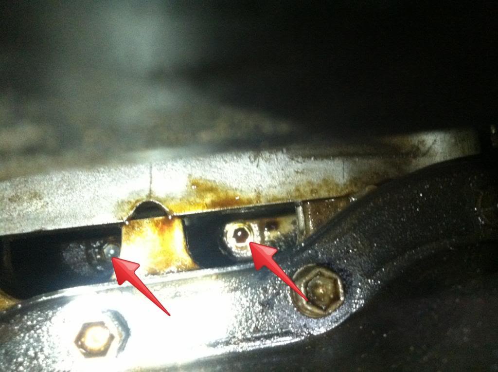

    da5894c6-edf7-49fe-86b0-cb1948190289_zps_0ee707588f3db73d690f327e516b8c8f85abc3a3.jpg
    Where the arrow is pointing is a black plastic cover...inspection hole is what I think it is called(what my buddy called it)... If you take it off there are two bolts about 4 to 6 inches up inside of it. Hard to see but pretty sure there is oil up there on one of the bolts.
    02374a16-2c71-4232-b819-f3d98975378b_zps_a4bade727a1d79d55c790248ef234d1563323dd8.jpg
    This arrow is showing the plastic cover being taken off
    61bca5a3-f665-44b2-b440-057f73e4c14f_zps_c5d1dd52e113123193045d2b33ab2eb84b4230e9.jpg
    And these two arrows show the bolts up inside the hole. The bolt on the right seems to have oil on it.

    Cam plug seals leaking or valve cover? Could be dropping down!

    best wheel bearings around! www.marionbumper2bumper.com
    If it is seeping out from that area you indicated with the arrow, then yes, you may be looking at rear main seal. Also, as mentioned recently, if it leaks under load, then higher probability of rear main seal, however I still think your pan gasket looks like it could be leaking some as well. If you don't have a 4wd, then that pan gasket is an easy fix.
