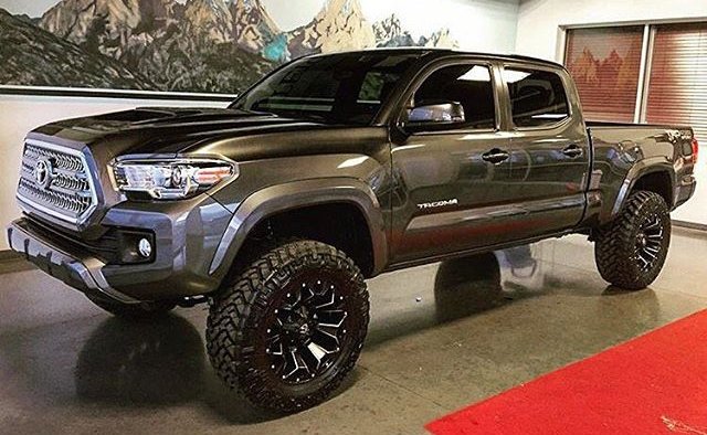

    IcePlant
    IcePlant [OP] Well-Known Member
    Jan 30, 2018
    #242949
    124
    Vince
    2017 BLACK TACOMA TRD SPORT DCLB 4X4
    -King 3" Lift -Leitner ACS Forged Bed Rack -TRD Pro Stainless Steel Cat Back Exhaust -TRex/ZRoadz Light Bar Grille
    I laughed when I originally read that because then it clicked just how true that statement is. :rofl:
    I was completely unaware that certain wheels were made for Toyota's...
    I am picky about the look of wheels and I still think the fuel assaults are pretty damn sexy.
    :worthless:

    lol no sweat. Just personal preference. Just know the bigger the wheel the less wall you have. Check out @SCS or Method

    A lot of the mass produced wheels that aren’t Toyota specific are not hub centric wheels and require hub rings. You can shear lug nuts while driving with a non hub centric wheel.
