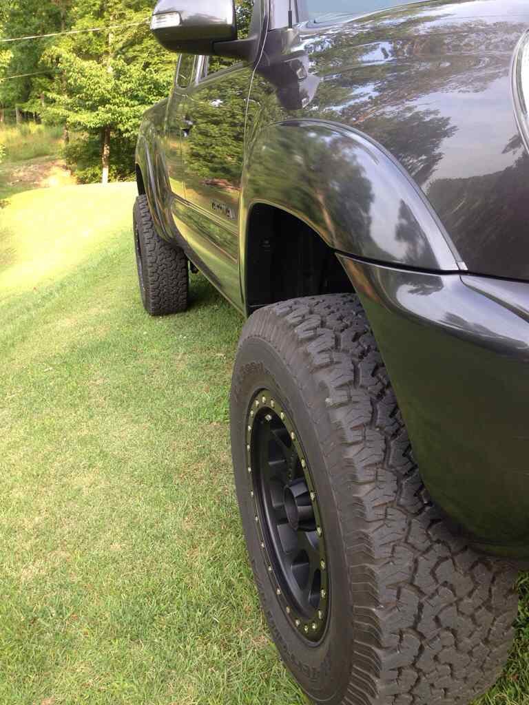

    No vibes from wheels whatsoever. I did experience a vibe after my lift but had nothing to do with wheels. I was running the wheels prior to the lift. Come to find out my vibe was nothing more than a slightly dry u joint. I dont want to get in an argument about wheel type but i would much rather have a lug centric wheel. They have been around for ever and most people i know would agree. Ive never personally seen or experienced a vibration issue with one. My guess is those that do have issues are installing/torquing them incorrectly.

    There again im sure there are people on here more knowledgeable on the matter than i but i speak honestly from my personal experiences.

    Good to know you didn't have issues. I suspect the reasons you stated above possibly paired with lower quality wheels could present an issue. Methods seem to be damn good wheels, keep us posted OP.

    Yes low quality wheels is a very good point as well. I will say this with the center cap installed and held in to place they were pretty snug on the hub. I tried moving them side to side and could maybe get an 1/8" play. Unlike some lug centric wheels you see that the center of the rim is an inch larger in diameter than the hub.

    magnetictaco79, Sorry not to hijack the thread but what are the specs on your rims? Size and BS?

    They are Method NV MR305
    17" dia. x 8.5" width
    6 x 5.5 Lug pattern
    0 offset
    4.75 back spacing
    They are a perfect fit for the Tacoma. Like I said I did put 1.25" Spidertrax spacers on just to let them hang out a little more. The rims themselves will put you close to 3/4" outside the fender, just a little bit of tread. Mine are out there pretty good with both. I cringe every time I pass a cop. WV has ridiculous laws.
