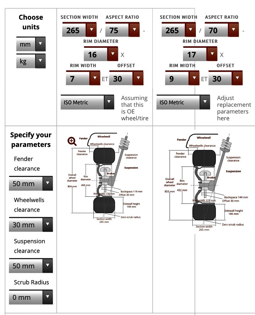

    Looking at new wheels and found a set I really like. But I have to go to a 30 offset to get zero scrub and it might hit my suspension. I don’t want spacers!
    The 16” is what I have now and I have to go to a 17” to get the wheels I like. They don’t come in a 16”

    So reading that it’s optimal to have “some” negative scrub. But how much is to much?

    5.5 inches of backspace is about as much as you can have with the Tacoma before issues arrive. With the example of the 17x9 wheel with a 30 offset that would approximately 6.25” of backspace. So depending on what tire size your gonna run and wheel width you’ll probably want a 0 offset or some negative offset.

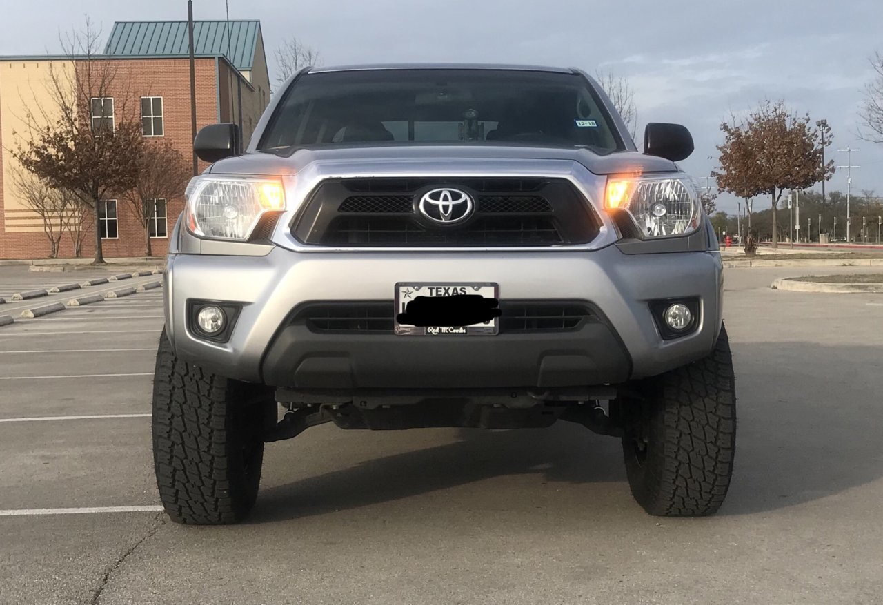

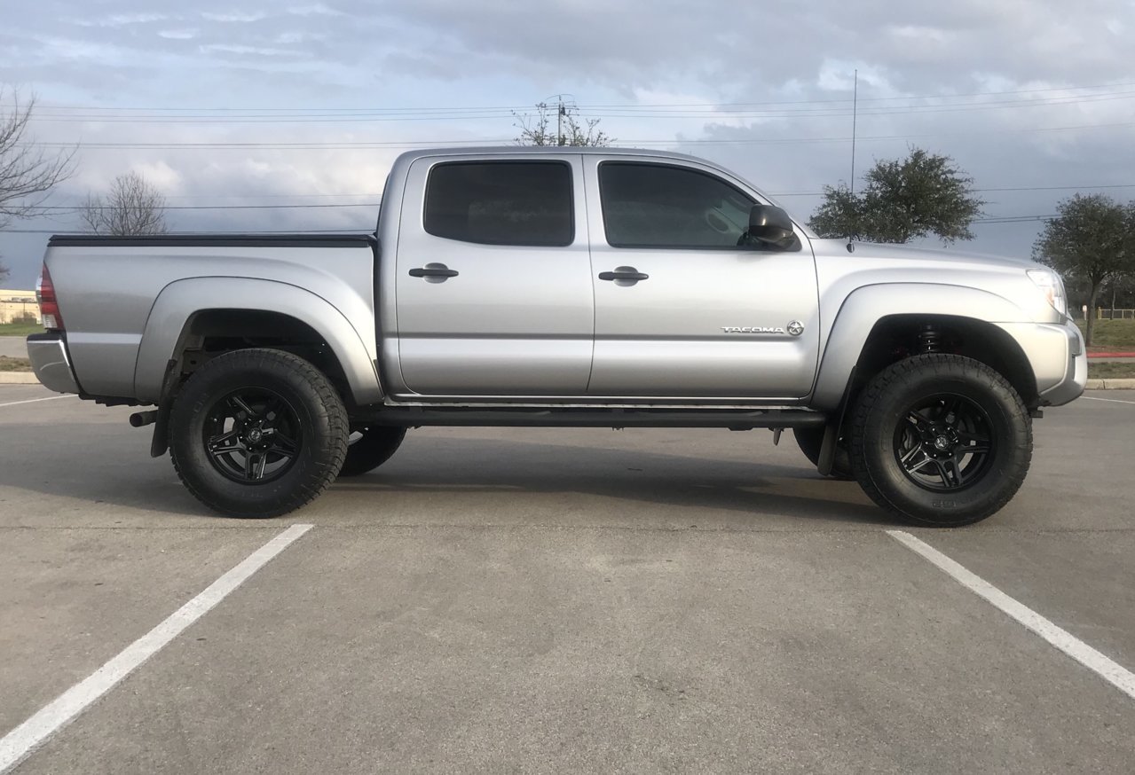

    Here a pic 285/70/17 on my 17x8.5 -10 offset2BB28439-64F3-467A-AB32-29416ABB3C0F.jpg 54A6CE27-01F4-4899-BD8C-2681D8423F0E.jpg
