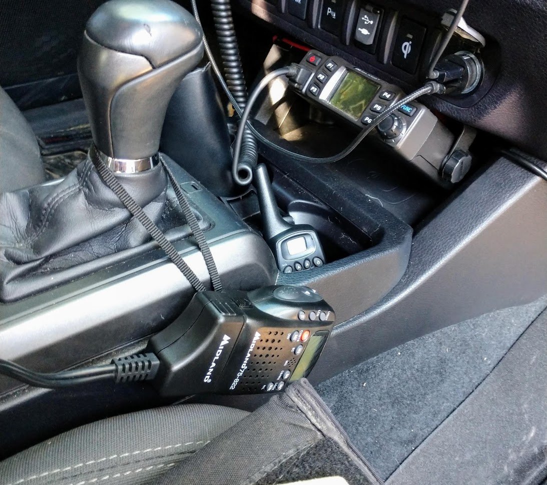

    ACtC-3dwpu0Se8IEmaqh-CifWewpL4p1pHx1m7hw_8791dcdb66b654ad1c78824c323ca757647a289e.jpg
    My current setup...
    Midland 75-822 CB
    Midland DBR2500 "ham" radio
    Uniden FRS radio for chatting with my buds with GMRS mobile radios, FRS shares channels with GMRS but no license required. They work better than they should in convoy situations.
    My CB hasn't been turned on for like a year now FWIW. There's always someone to chat with on the ham though.

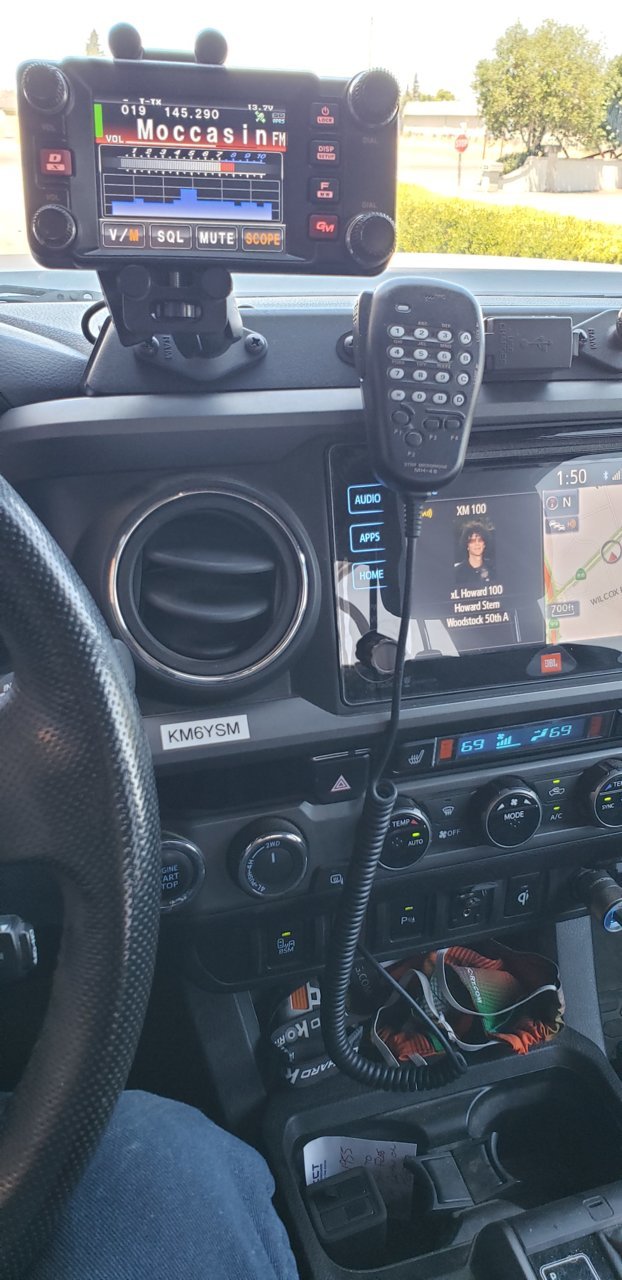

    FTM-400XDR is a great radio. If you decide to go the HAM route, go with the Yaesu if your buddies already have them too. There are digital modes that allow you to talk in a private group and its super easy to share files from one radio to the next. And the install doesn't have to look cobbled together...
