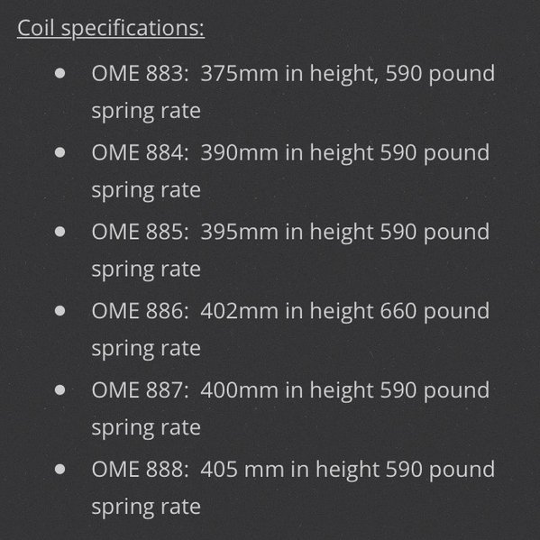

    You guys are over thinking it. The difference between and 885 and a 886 is 1.

    I have the 886 coils on 5100s currently installed on my truck. Before i got the bumper installed i thought the ride was pretty stiff, but not unbearable. Once i got my steel bumper installed i noticed a huge difference, but it was still pretty stiff and i feel like a winch would help soften up the ride a bit.
    I currently have an aluminum bumper on the way and i am going to swap out the coils for some 887s because i will be dropping about 60lbs off the front and would like a little softer ride in the front.

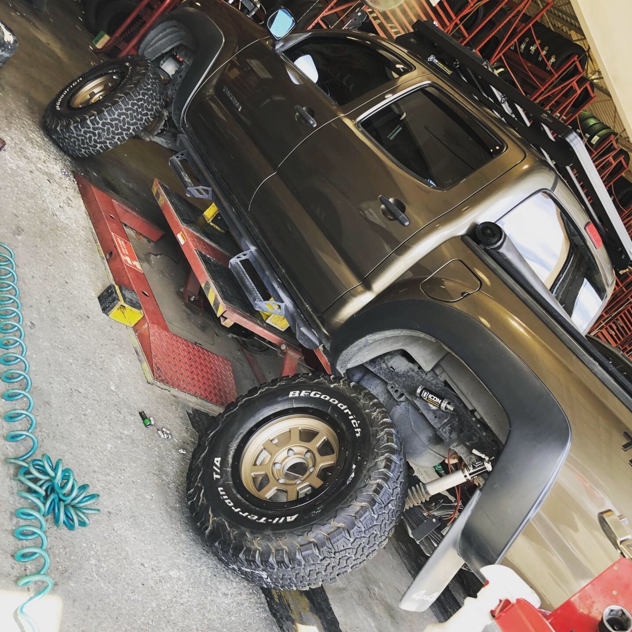

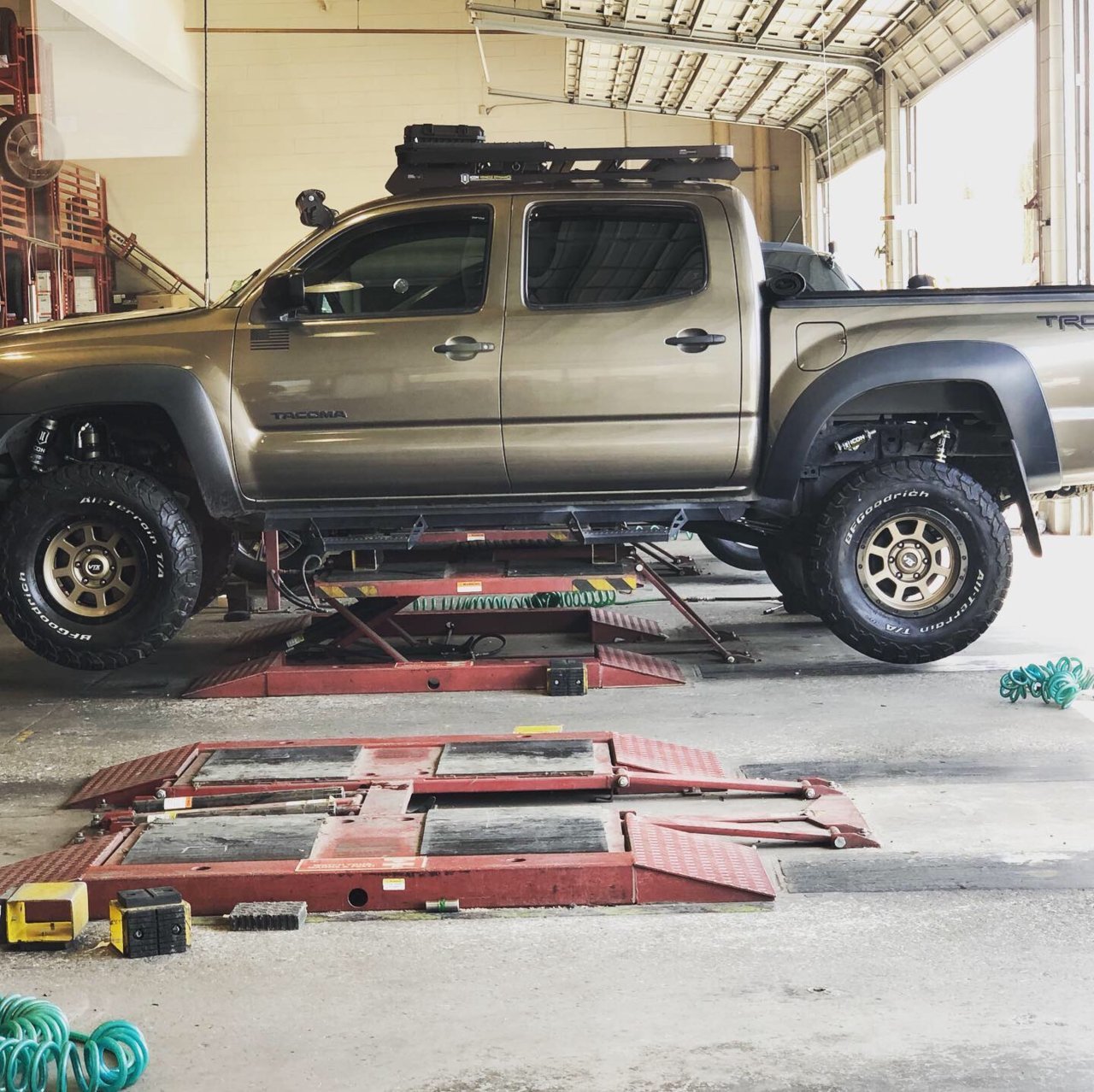

    Well I went with a Stage 4 ICON setup here are my pictures with new wheels getting put on.
