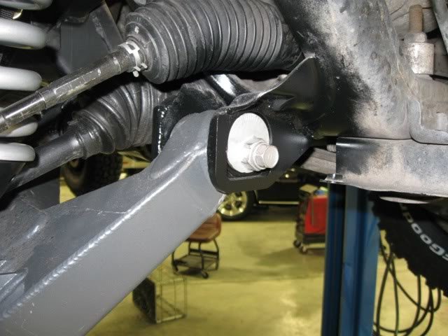

    Its tougher to knock them out but you can still knock it out of alignment. Nelsonmatt has the TC ones and he has still knocked his alignment out. They help but with a hard enough impact the entire mounting tab can still move. Those are beefier than stock, but the ones I made are truly beefy :D
    [​IMG][​IMG]

    That really is the way to go for these. Reinforce the mounts along with the alignment cam tabs.
    We used 3/8" cold-rolled steel on my truck:
