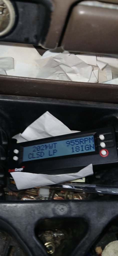

    My 95 2.4l after 30 min drive 80 f outside and my ac full read 202 -206

    A few OE parts from fancy trucks
    With what temp t stat in place?
    If the right one, then there are lots of other basic cooling things to check out, as that is a bit hotter than it should be in modest weather.

    I know I install a toyota thermostat at 12 giggle valve I do all I been read heater full blast
    Burping the cooling system
    Almost 300k need recheck all hoses

    Fan clutch. Radiator cap. Water pump. Radiator flow. Old hoses that collapse with suction. Debris in the condenser fins, between the condenser and radiator and in radiator fins.
    Just other places to look

    206 degrees with the A/C on is not a big deal. These cooling systems can climb up into the 220 range just going up a long hill and somehow the engine still goes 300k miles
    If the temp gauge never moves past the normal 12 o'clock position everything is fine.

    I keep eye on it new radiator cap on the way
    So I'm gonna clean radiator and see if helps keeping cooler thank guys my 2004 taco just did timing belt and all drive test fluctuating 193-197 40 min drive on traffic ac on full blast too

    206 is definitely over the limit. I really want to know the actual temperature of the engine oil for real
