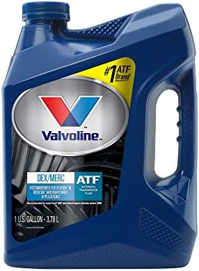

    Valvoline maxlife

    Our trucks do not use Power Steering Fluid. It uses Automatic Transmission Fluid. Just go buy whatever the cheapest Dexron III equivalent ATF you can find.

    That’s fine. As long as it’s Dexron III or greater.
